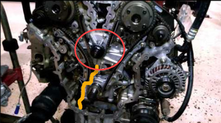

These engines are notorious for water pump failures, and the reason for coolant getting into the oil pan is because the water pump is driven by the timing chain and thus is in the timing cover. not an easy quick job like an older vehicle unfortunately!

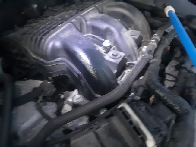

I also noticed moisture on intake.
Hopefully you can see it.
Mar 29, 2020 at 10:26 AM
  • 110,244 POSTS
On the front of the intake, I see something that appears white. Is that oil or a reflection? I ask because that is what oil and coolant mixed will often look like.
Have you had a chance to inspect the water pump and review the link I added last time?
Mar 29, 2020 at 11:10 AM
DFLEENER77
No I have not and that is a reflection.
Mar 30, 2020 at 12:36 PM
  • 110,244 POSTS
Okay, that's good news. I thought something was spraying contaminated oil on it. When you get a chance, let me know what you find.
