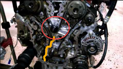

These engines are notorious for water pump failures, and the reason for coolant getting into the oil pan is because the water pump is driven by the timing chain and thus is in the timing cover. Not an easy quick job like an older vehicle unfortunately!

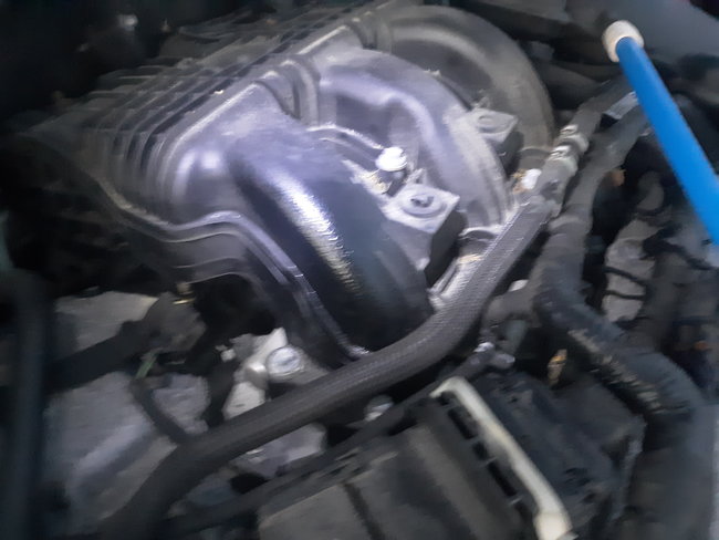

I also noticed moisture on intake.
Hopefully you can see it.

On the front of the intake, I see something that appears white. Is that oil or a reflection? I ask because that is what oil and coolant mixed will often look like.

No I have not and that is a reflection.

Okay, that's good news. I thought something was spraying contaminated oil on it. When you get a chance, let me know what you find.
