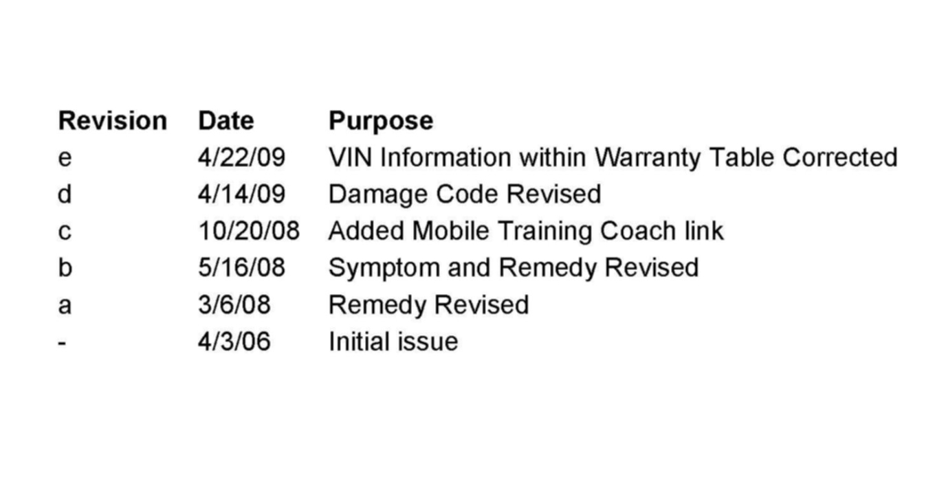

pic 1
Revision History

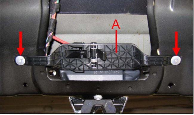

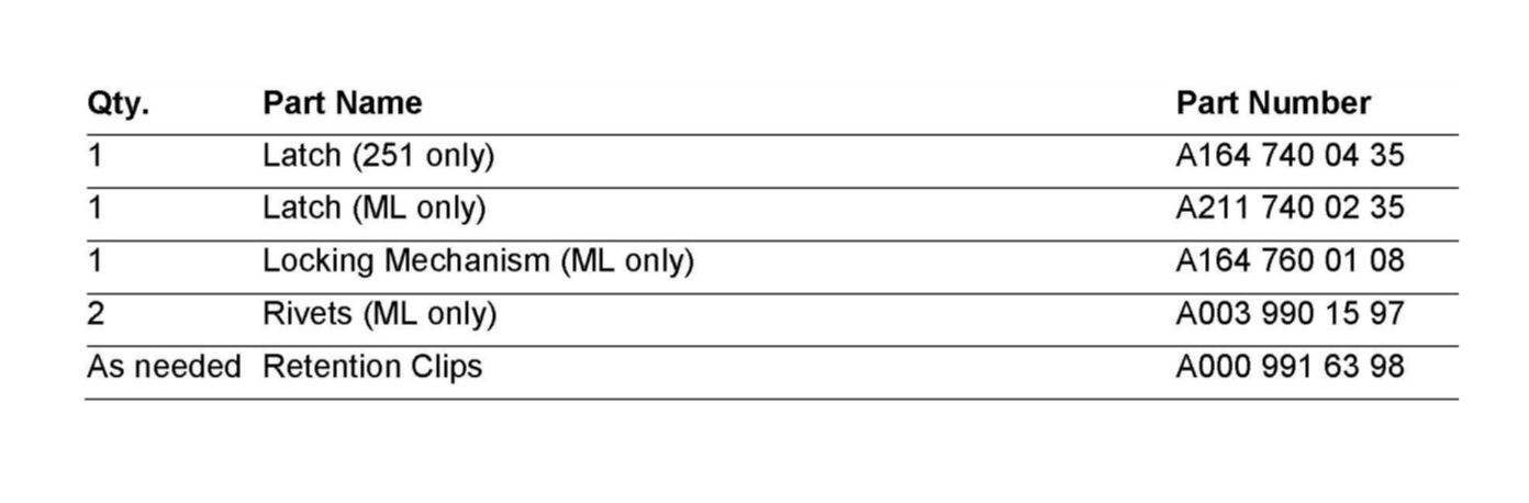

pic 2
Note:
The latch designed for model 164 (ML) also requires installation of a new locking mechanism. When ordering a latch (A211 740 02 35) for a ML, also order a new locking mechanism (Figure 1, A) and rivets (Figure 1, arrows).

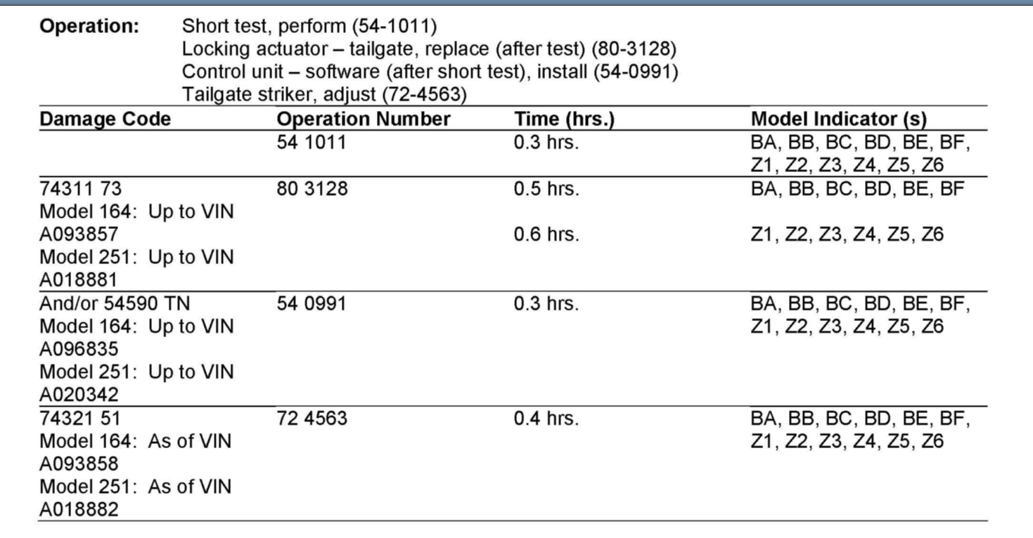

pic 3
Parts Information
Note:
The following allowable labor operations should be used when submitting a warranty claim for this repair. This information has been generated on April 22, 2009. Please refer to Netstar --> Star TekInfo --> Star Time for the most current labor time allowance.
pic 4
In Case of Warranty, use the table above.
