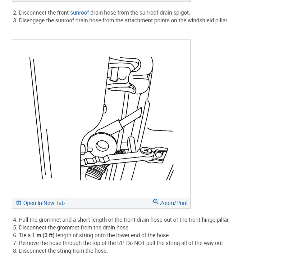

After the last two rains, had soaked carpet on driver's floor. No sign of water any place else. The car has a sunroof. It is garaged at night.
Dec 10, 2022 at 8:37 PM
  • 54,832 POSTS

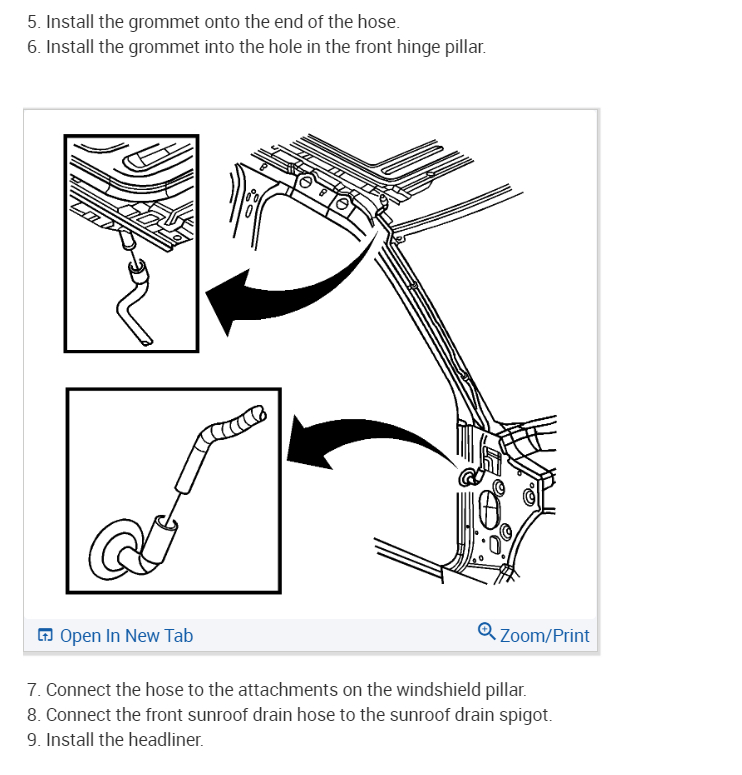

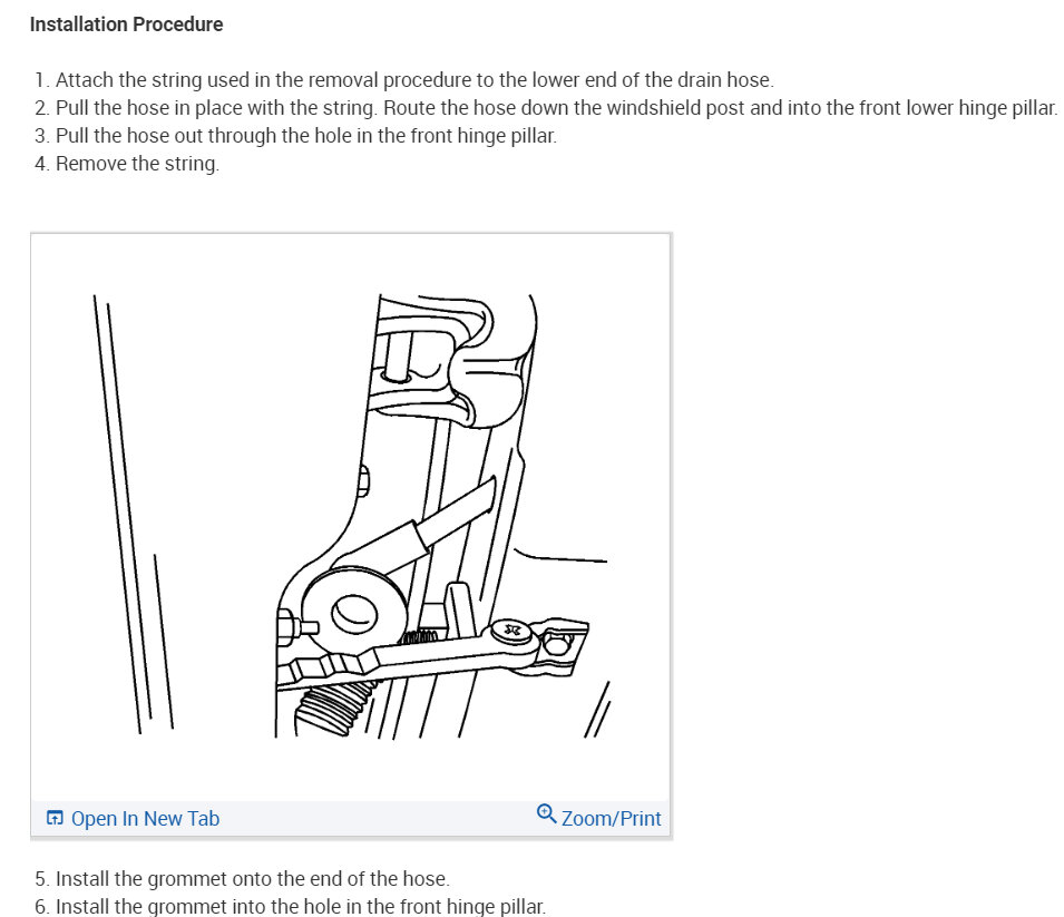

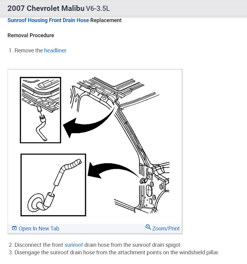

Commonly there are only two places the water can get in, first is through the windshield seal and the other is the sunroof drain might have fallen off which the water will run down the A pillar on the driver side. The best way to find out what the problem is to pull the carpet back on the driver's side and use a garden hose to hose down the windshield only to see if you can detect a leak and do the same for the sunroof. This should help pinpoint the issue. If it is the windshield it will need to be replaced/resealed and here is the drain location for the sunroof so you can check it out the images below.
Sunroof Drain Inspection and Cleaning
Drain Hose Routing
A drain trough encircles the sunroof window panel and water is drained off by the hoses located at each corner of the housing. A drain channel spans across the sunroof module at the rear of the window panel and directs water into the trough.
1. Ensure that the front drain hoses are routed down the windshield pillars and out the center of the front pillar between the door hinges. Ensure that the hoses are not kinked. Replace any torn or cracked hose.
2. Ensure that the rear drain hoses are routed through the rear pillars and out of the rear lower quarter panel. Ensure that the rear hoses are properly routed in the metal roof slot and are attached in place. Replace any torn or cracked hose.
Clogged Drain Hose
If a water leak has occurred, inspect for a plugged drain hose at each corner of the drainage system:
1. Open the sunroof window.
2. To test for blockage, pour a small container of water into the module housing drain trough. Inspect each corner to confirm the drain hose is draining water.
Caution: Wear safety glasses in order to avoid eye damage.
3. Use compressed air, 35 psi or less, to blow out any drain hose that is clogged.
4. Test the system again.
5. If the hose remains plugged, inspect for improper routing or kinks. Refer to Drain Hose Routing above.
6. Remove any hoses that remain clogged.
7. Remove the blockage:
1. Push a mechanics wire through the hose to remove the obstruction.
2. Use compressed air in order to blow out any remaining material.
8. Reinstall the hose.
Disconnected Drain Hose
Inspect the drainage system for disconnected drain hoses. Complete the following steps in order to obtain partial access to drain hoses and inspect for a disconnected hose.
1. Open the sunroof window panel.
2. Lower the headliner as needed.
4. Ensure that the rear drain hoses are properly routed in the metal roof slot and attached in place.
Check out the images (below). Let us know what happens and please upload pictures or videos of the problem.
