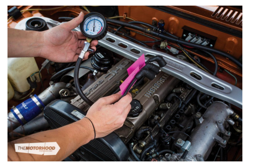

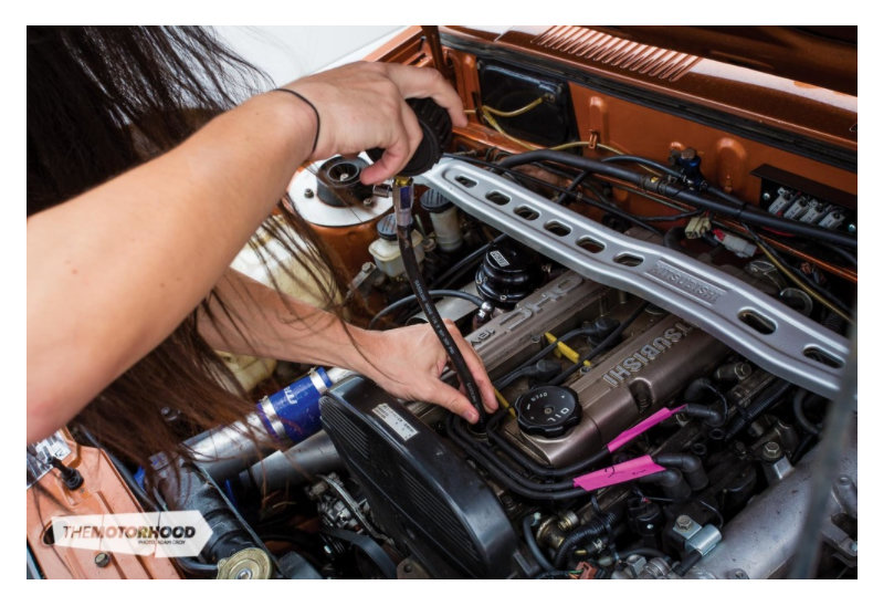

Overheating on uphills water going into reservoir bottle from radiator and when I open the radiator cap there is pressure in radiator.

Sounds like you possibly have a cylinder head gasket leak or possibly a failing water pump carry out the following test please.

Here is another video you may find helpful and a couple of diagrams:
