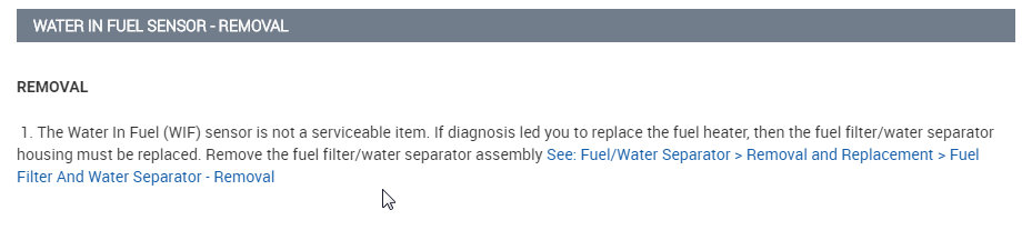

I have a water in fuel line light on and I was told I need to replace the sensor in the water in fuel separator housing. Can I replace the sensor itself or do I have to replace the entire water fuel separator housing?
Oct 11, 2019 at 2:58 AM

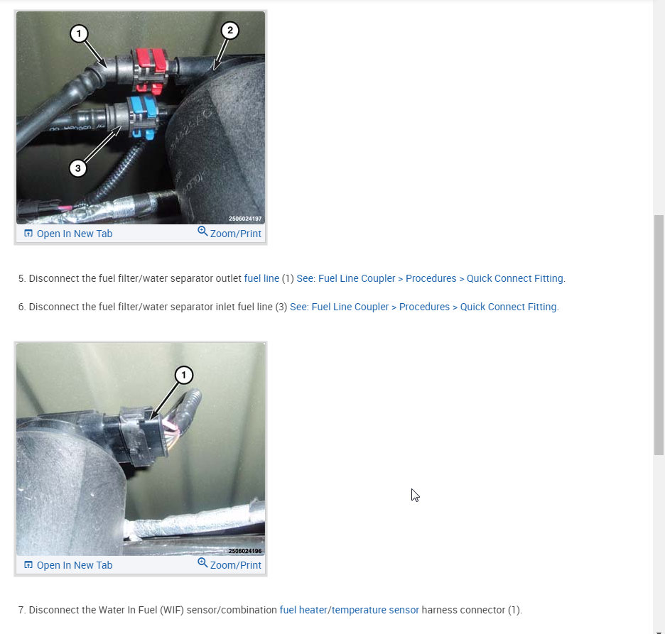

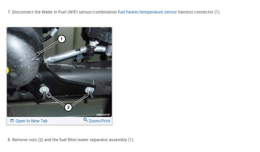

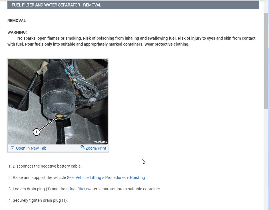

Please see the attachments for your answer. Please let me know if you have further questions.
This video shows you how
https://youtu.be/6de-1mIpzi8
Check out the diagrams (Below). Please let us know if you need anything else to get the problem fixed. Thanks
