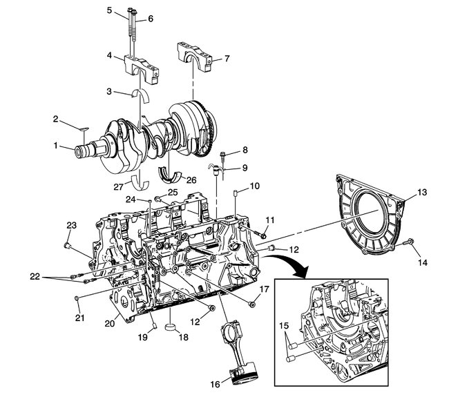

Location of block water drain plug?
May 10, 2018 at 11:03 AM
  • 110,240 POSTS
Hi and thanks for using 2CarPros.com. There is a 14mm bolt about mid way down on the engine block. It will be on the passenger side of the engine. If you look at the attached picture, locate item number 17. That is what you are looking for. This was the only picture I was able to find. When looking at it, keep in mind the engine is upside down.
I hope this helps.
