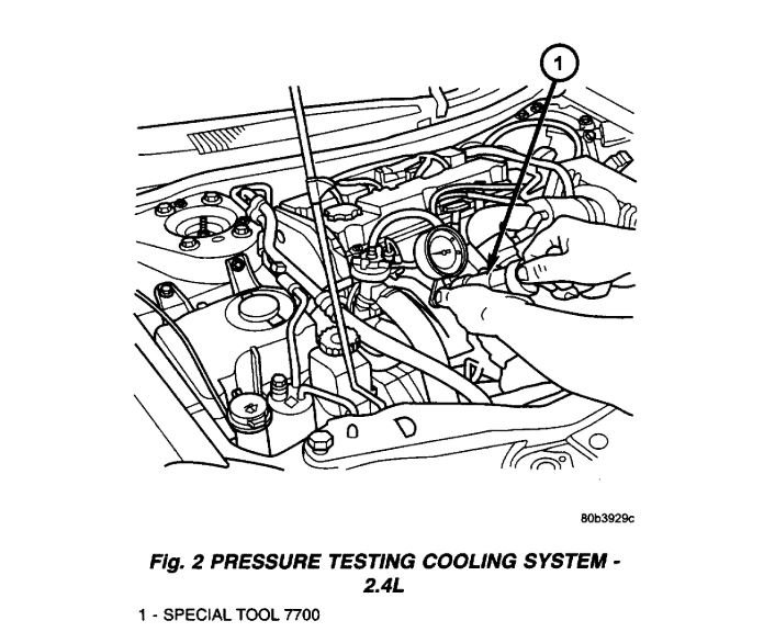

I have the car listed above it's leaking coolant in front of the engine on the driver's side. It doesn't leak when car is off only when it runs for a bit then it starts dripping. It's in front underneath where the shroud is at. Can this be a hose and it's running down and leaking in front? Can you please help?

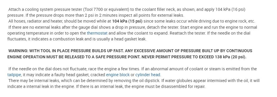

Good afternoon,
Can you upload a picture of where the leak is located?
https://www.2carpros.com/articles/car-is-leaking-coolant
You will need to pressure test the system to determine the source of the leak.
https://www.2carpros.com/articles/radiator-pressure-test
