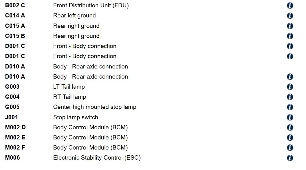

I removed the tail light on a Maserati Ghibli because it had condensation. Used a heat gun to dy it and then left it in the sun. Placed clear silicone around the edges. Problem is before I even removed it is that when you hit the brake, the brake light on that side comes on for split second and goes off, and same if you repeat the process. Where it sits looks ok. removed the connector and had a bit of corrosion on one pin, cleaned it but same results. Bulb looks ok to me. Could a bulb be faulty and do this?

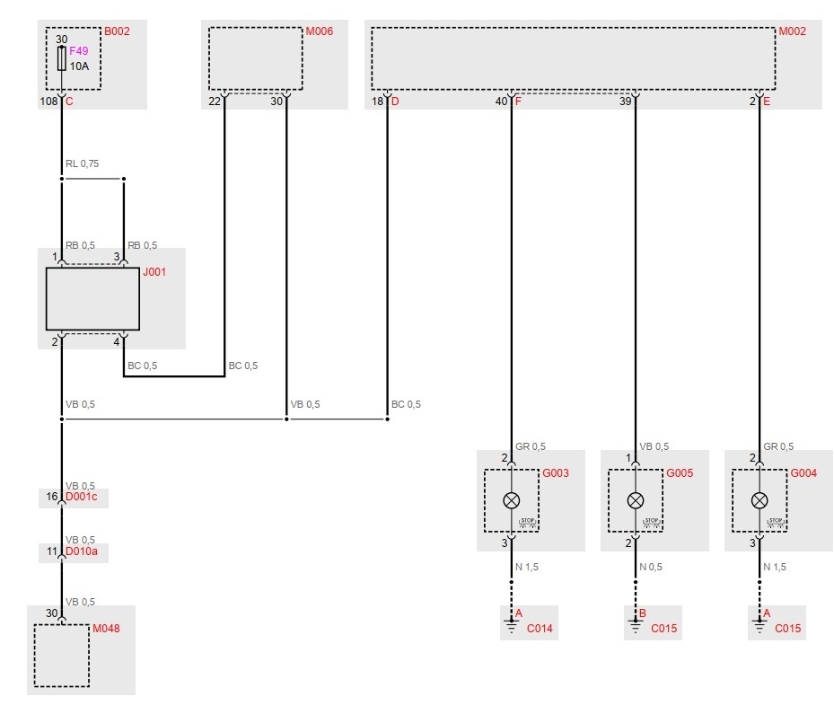

HMM, They show logic involved. Could be a different option? OK might have found it, the lamps are controlled through the body module, they might have a current sensing system that shuts the lamp down if it's draws excess current. If the contacts were shorted by corrosion so it tried to turn on more than the single lamp that could be the issue.
You should have gotten a link in messaging to service info, it might help.

on the dash its will say brake light malfunction whenever I hit the brake. But the brake light on other side as well as the middle light work fine, must have to do with the condensation that happened. But I am trying to figure out whether a bulb could be bad if it only works sometimes or if it's the contacts. iF CONTACTS ARE BAD IT WOULD NOT EVEN LIGHT FOR A SEC, JUST STRANGE

Well if it's a dual filament bulb they could be grounded internally, however if it was an open then it shouldn't light at all or only once then not again, as this is repeatable it almost has to be in the light or the wiring, Do both sides share the same wiring configuration and plug design? Might be able to swap sides and see if it follows.

Removed the other side light. Bulb does same thing when inserted. Installed whole assembly into the bad side abd it works fine so its something inside the light i guess
