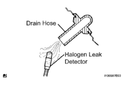

When I make a left turn I hear a sound like water sloshing. I first noticed this during or just after heavy rains. After rain stopped I noticed water pouring then after a while dripping into the passenger compartment from the back of the dash. This stopped after a while but I still hear the sound of water sloshing when I make a left hand turn.

check to see if your heater a/c drain is plugged sounds like it is. if you have any type of coolant loss then get pressure checked for a heater leaking. see pic it will be on either bottom front of firewall and or gfloor. run a wire through it to open it up.
