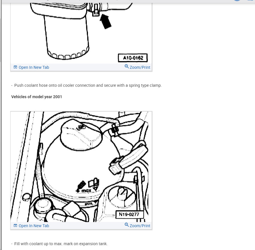

I took out the coolant reservoir to wash it with soap. After that the next day the water started to boil, and fans were not moving and i changed the thermostat but still the same.
Apr 6, 2022 at 3:18 AM

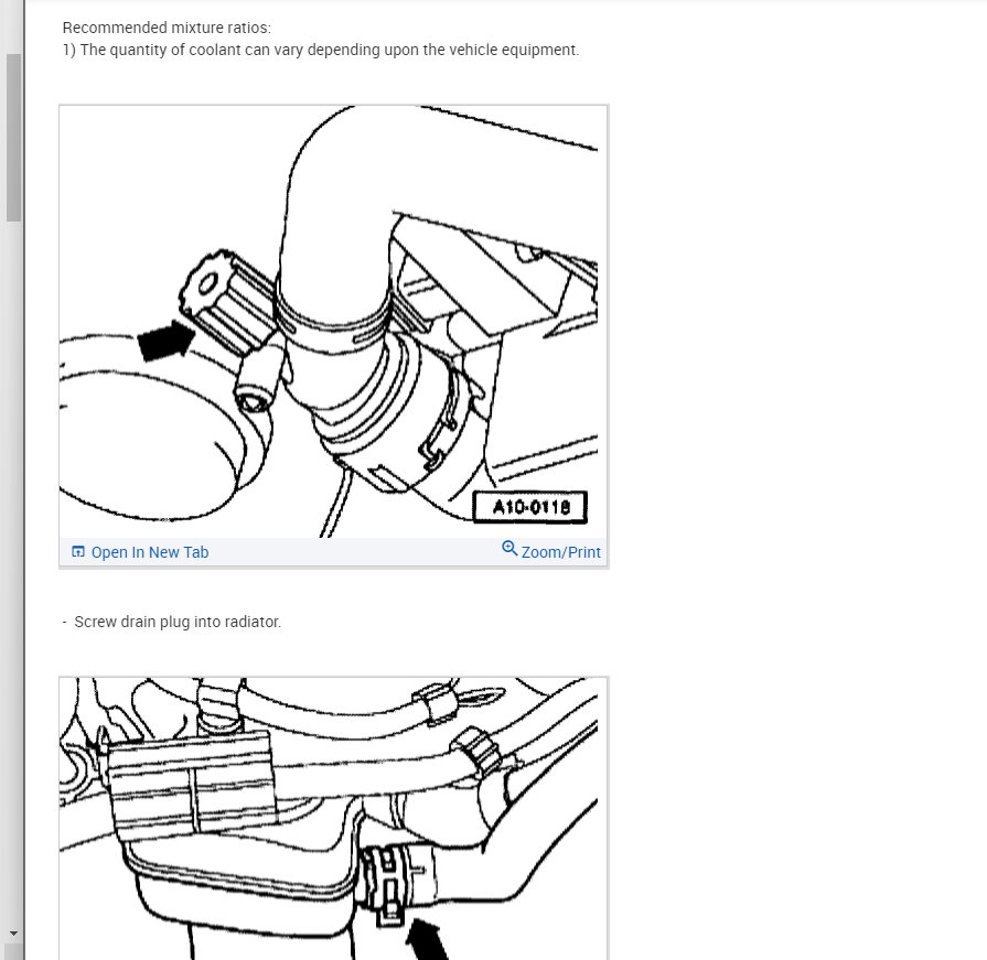

Coolant boiling over is normally caused from a restriction in the system and if this just started after the bottle was off then we need to make sure the lines are on correctly and not restricted.
Then we should pressure test the system and make sure we don't have any leaks.
https://www.2carpros.com/articles/radiator-pressure-test

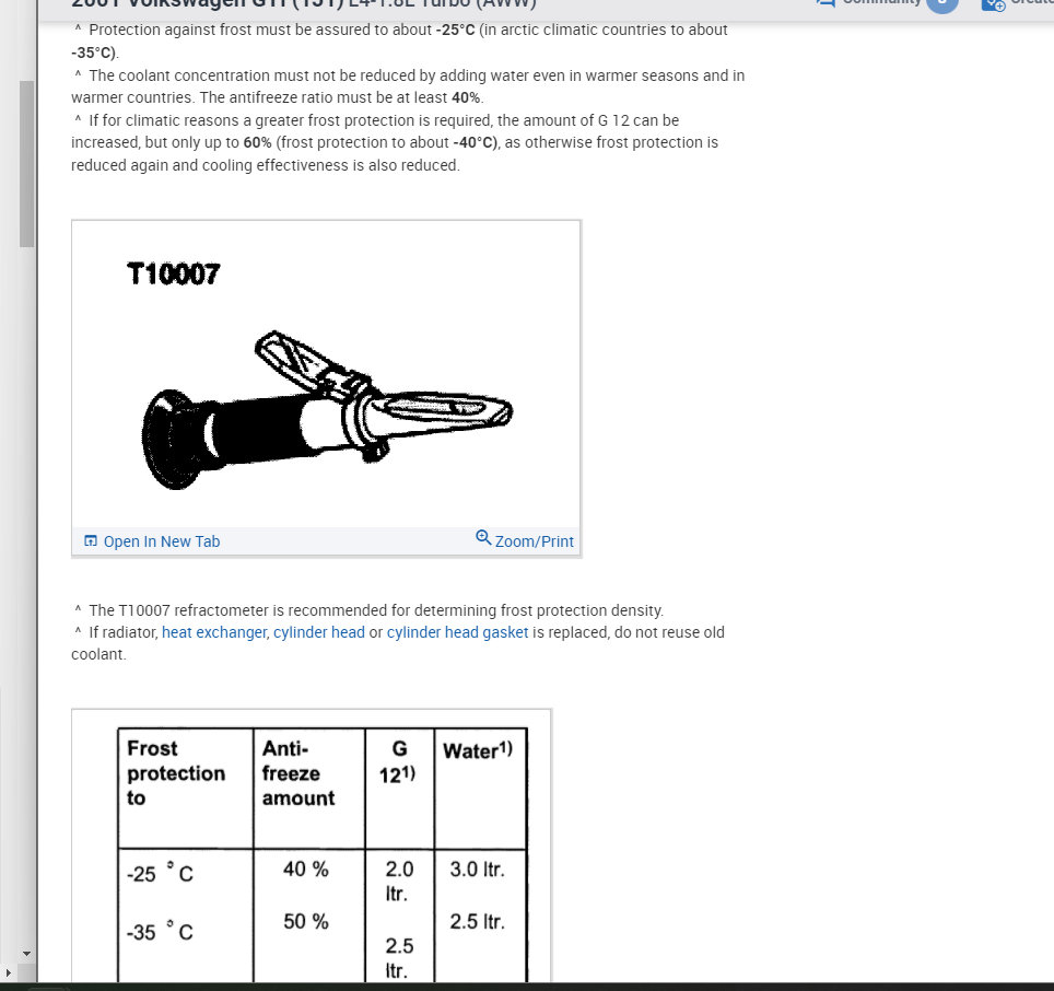

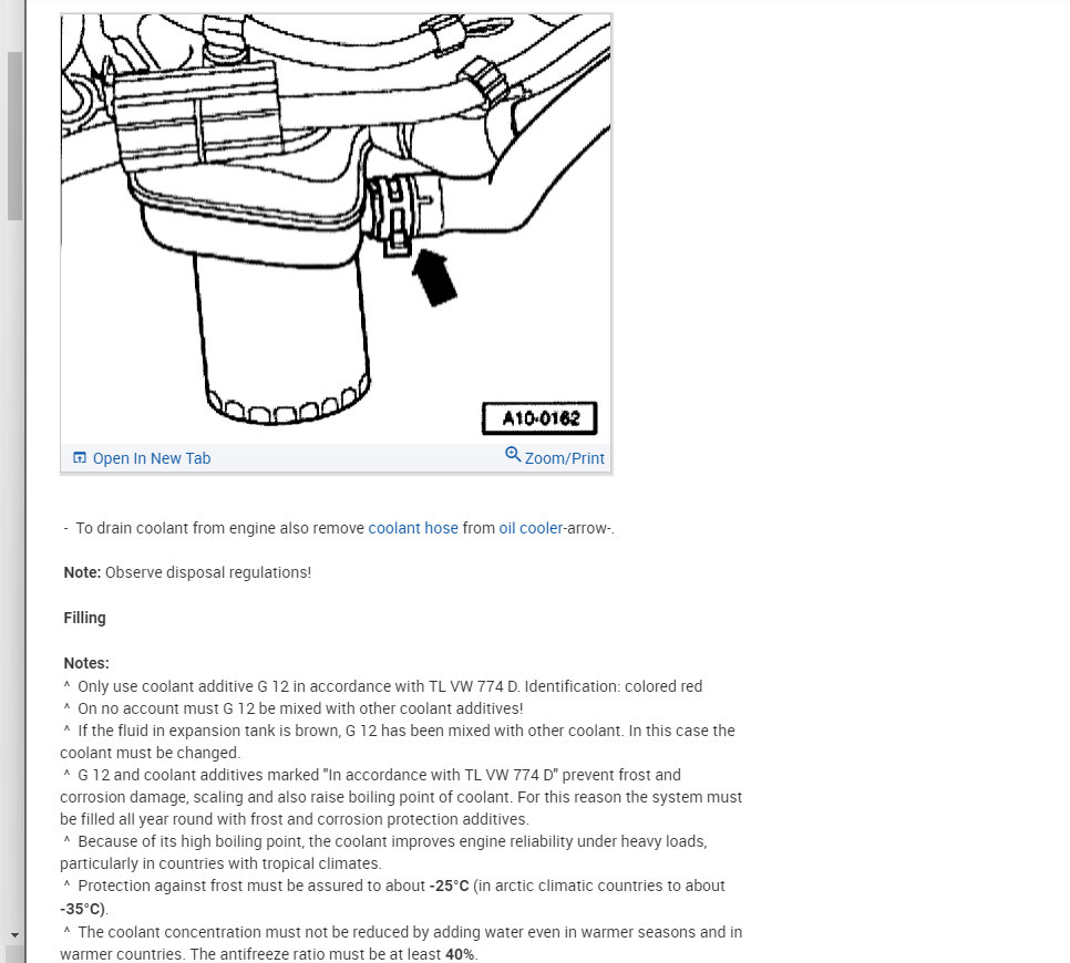

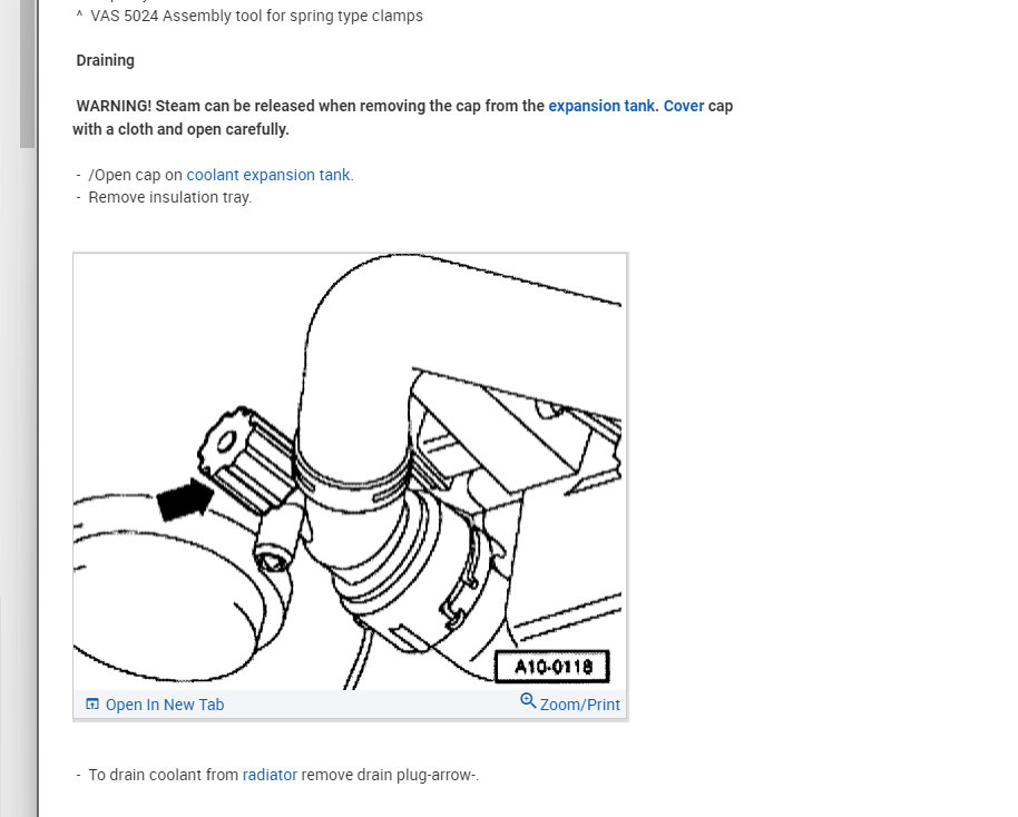

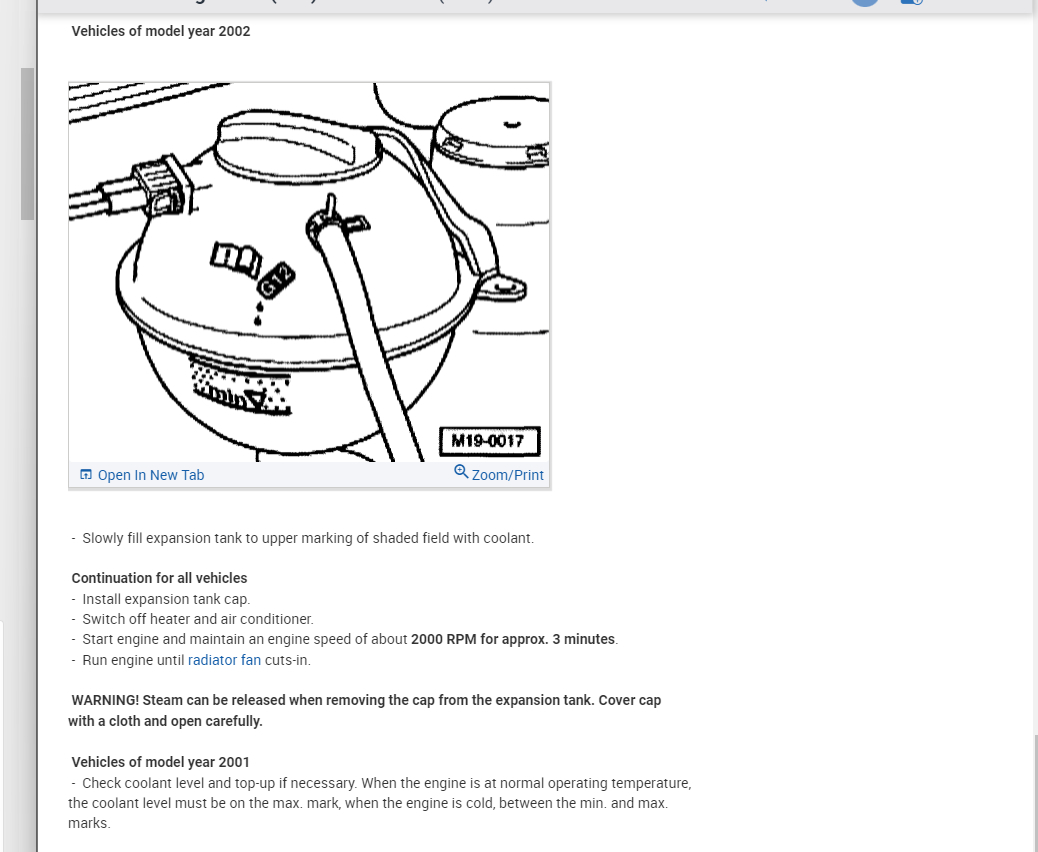

Next, we need to use the attached info for draining and filling the system because I suspect we are missing something on this. Clearly removing the bottle and reinstalling it should not be an issue.
Please run through this info and let us know what you find, and we can go from there.
