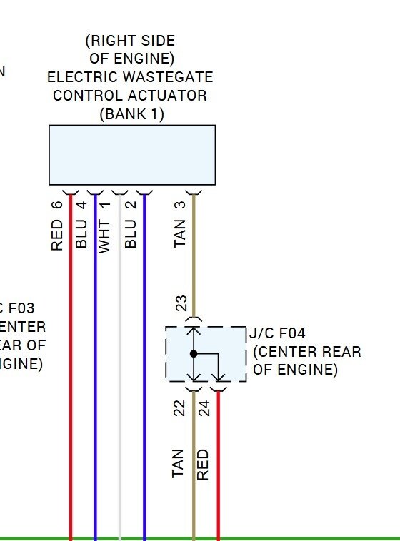

Can you find out for me what the live data parameters should be on the turbos? Goes in limp mode then can be cleared and driven until the next cycle. Code p2563 i believe. Infiniti sells the whole turbo with the wastegate. I need to know what numbers i should be getting from the wastegates when started cold and once warm if there is a difference. Also, if possible, to measure the wastegate actuator using a multimeter.

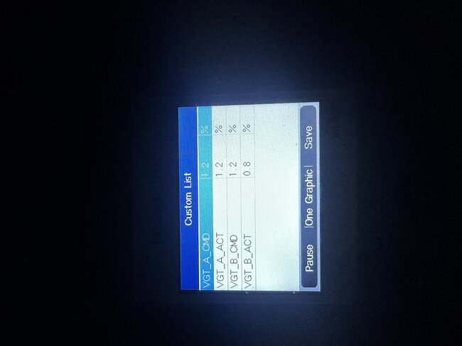

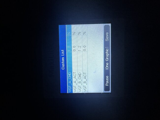

Also yesterday i asked my son to use a regular scanner to scan what he can with regards to both actuators he did this when car was cold first then after clear inf the code, but I will use my Autel later to see what i can find.

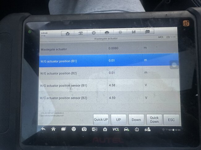

I could go up and down with the wastegate in "m" values and both respond as well as voltages and i can hear both.

yes, I know there are two and I can see the connector to them, manual says they are not replaceable and Nissan sells the assembly as a whole, but they are sold online aftermarket, if I know for sure one is bad I can manage to change it but hard to know as I hear both moving and I see the voltage changes when I change the values. I don't want to play with the nut adjustment, it is out there in steps, but that is usually or should be done when installing new turbos I believe.

If they are both moving, they are likely not the problem. It is likely an issue in the wiring that sends the position back to the PCM.

Just did it when thecar is cold, and it shows it's out of range. The voltage didn't change when changing bank 1 up or down.

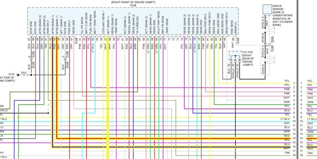

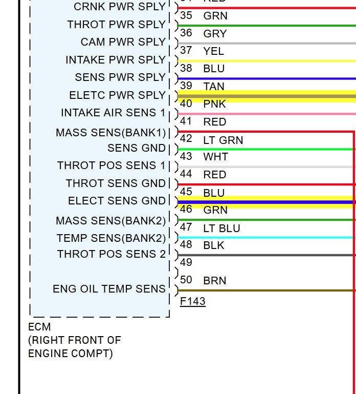

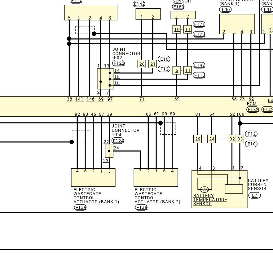

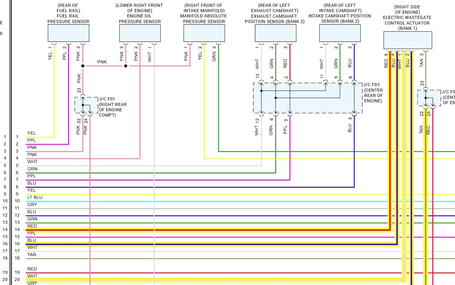

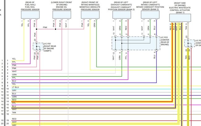

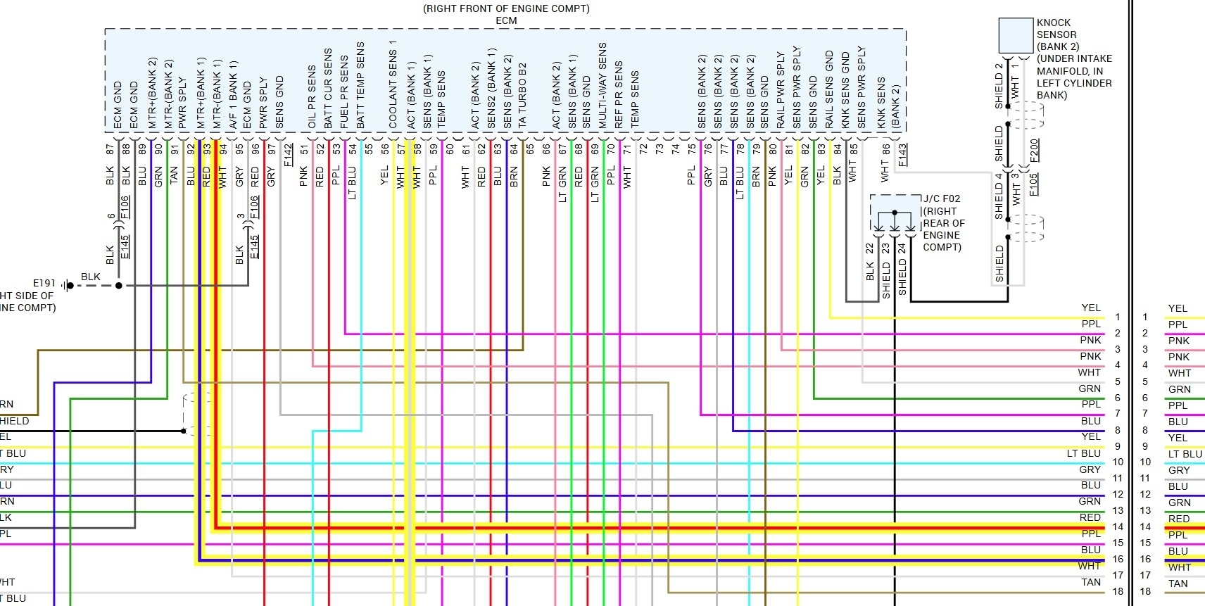

Okay, if you actuated it and nothing changed it's either the actuator or the wiring to it. That means you need to get to the wiring and unplug it, then test with a meter in place of the actuator. If you command different opening levels the meter should change if the wiring is okay. If it changes the actuator is suspect. If not it's the wiring. This is the wiring to that gate. Note that the two blue wires are entirely different though.
