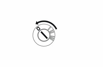

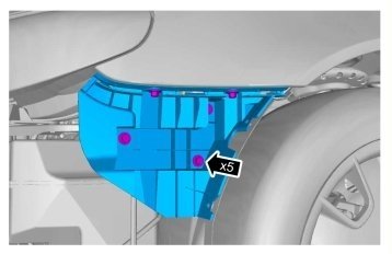

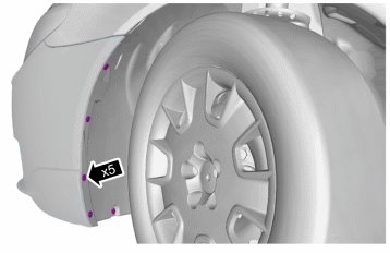

There are a few different steps with this. I am going to start with the basic removal and replacement of the reservoir. The remaining directions will get you to this point. The attached pics correlate with the directions.
____________________________
2008 Volvo XC70 AWD L6-3.2L VIN 98 B6324S

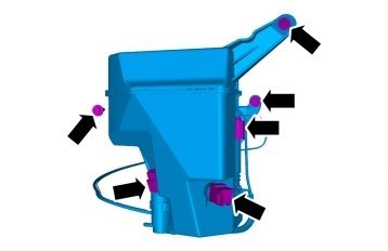

Washer Fluid Reservoir
Vehicle Wiper and Washer Systems Windshield Washer Reservoir Service and Repair Removal and Replacement Washer Fluid Reservoir
WASHER FLUID RESERVOIR
Washer fluid reservoir
Operation number: 36338-2
Removal and Installation
pic 1
See information on component position washer reservoir. See: Windshield Washer Reservoir > Components > Location of Components, Washer Reservoir

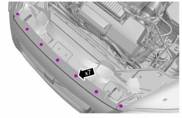

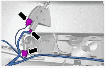

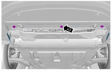

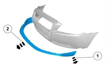

Remove casing bumper front. See: Front Bumper Cover / Fascia > Removal and Replacement
pic 2
pic 3
Vehicle Body and Frame Bumper Front Bumper Front Bumper Cover / Fascia Service and Repair Removal and Replacement
REMOVAL AND REPLACEMENT

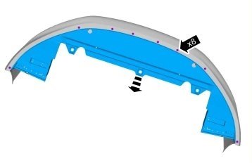

Cover bumper front
Operation number: 86103-2

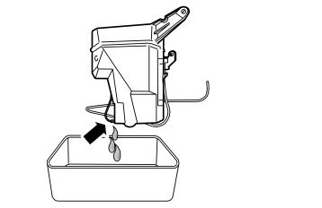

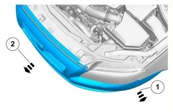

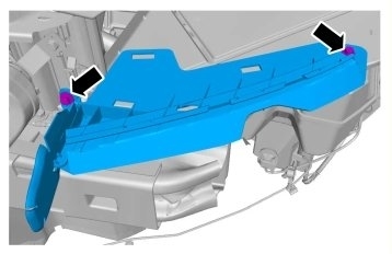

Note! Some variation in the illustrations may occur, but the essential information is always correct.
Removal
Note! Removal steps in this procedure may contain installation details.
pic 4
pic 5
pic 6
pic 7
Note! This step requires the aid of another technician.
pic 8
Note! Be prepared to collect escaping fluids.
pic 9

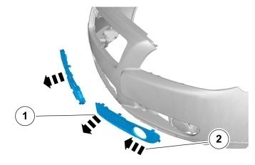

Remove the radiator grille. Refer to: Radiator Grille See: Grille > Removal and Replacement
pic 10
pic 11
Remove the following items:
- fog lights. Refer to: See: Fog/Driving Lamp > Removal and Replacement
- high-pressure washers. Refer to: Headlamp washer jet See: Headlamp Washer Spray Nozzle > Removal and Replacement > Headlamp Washer Jet
pic 12
Torque: Bracket to front fender, 6 Nm
Remove the headlamp. Refer to: Headlamps See: Headlamp > Removal and Replacement > Headlamps
pic 13
Torque: Bracket to front end, 6 Nm
Installation
To install, reverse the removal procedure
