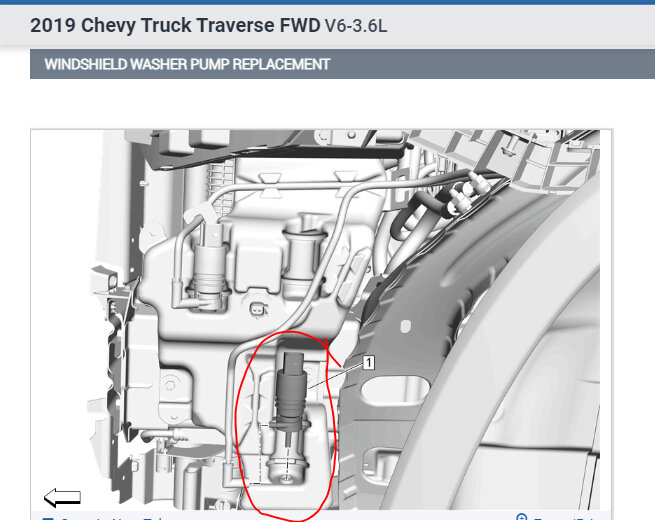

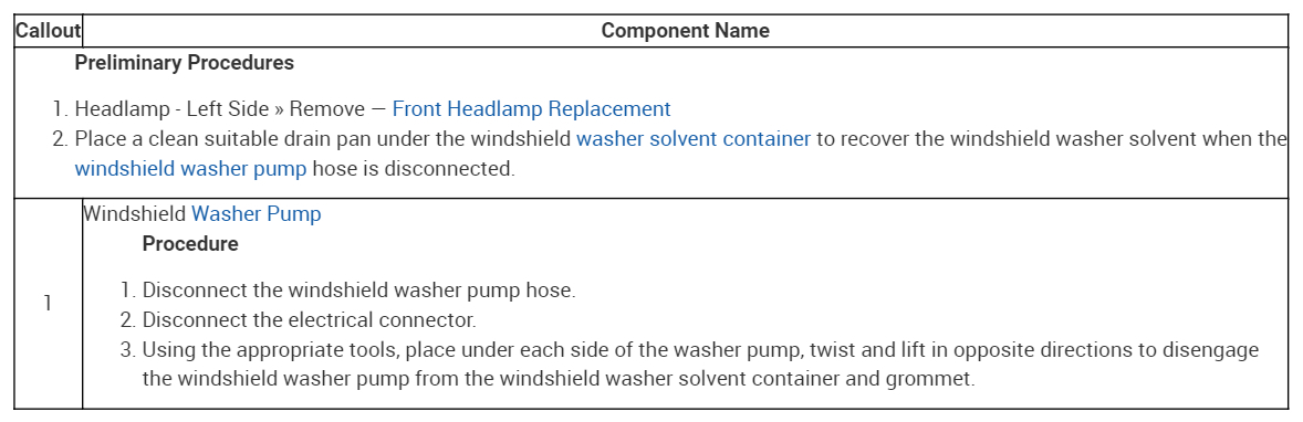

I believe my washer pump for the front windshield went out. I have the replacement pump but unsure of how to go about the repair.

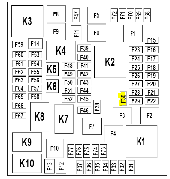

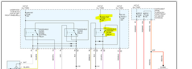

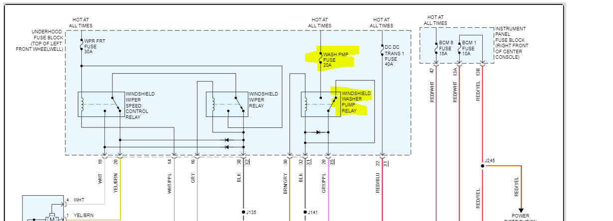

Before replacing the pump, make sure that the fuse is good and has power to and from it.
Note there is a relay as well.
Here is a link that explains how to test one:
If you look below, pics 1 and 2 are the directions for replacing the pump. Pics 3 and 4 provide the fuse information.
Let me know if this helps.
