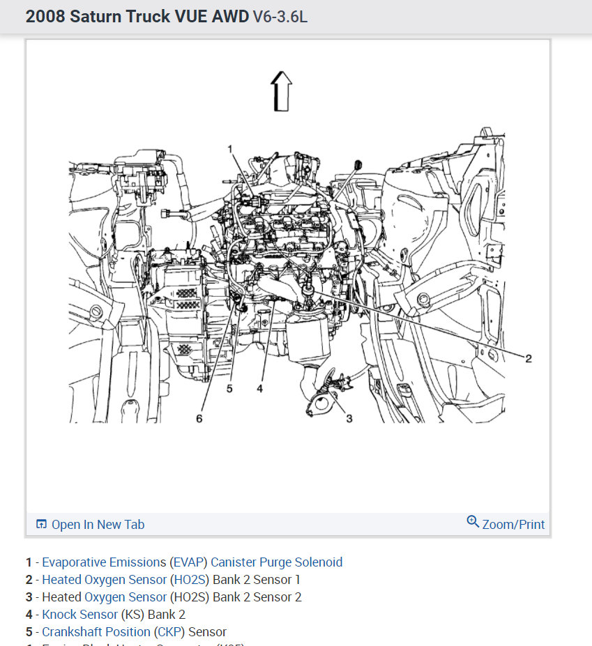

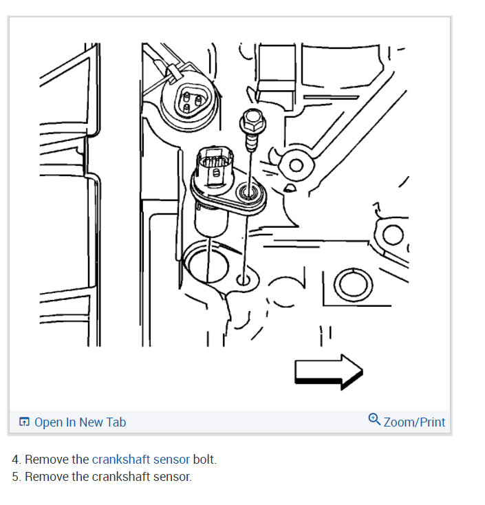

Change the spark plugs and started and had misfire on the 1, 3, and 5 cylinders and runs rough. now won't start at all but turns over.
Apr 6, 2019 at 4:18 PM
SCGRANTURISMO
  • 4,897 POSTS
This sounds like the crankshaft angle sensor or the fuel pump has gone out, when you turn the key to the on position without cranking the engine over can you hear the fuel pump run in the tank for 5 seconds?
Apr 6, 2019 at 4:44 PM
JESSIE79

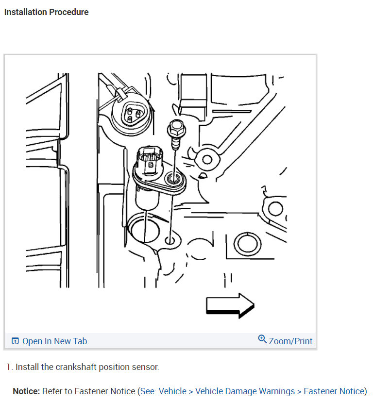

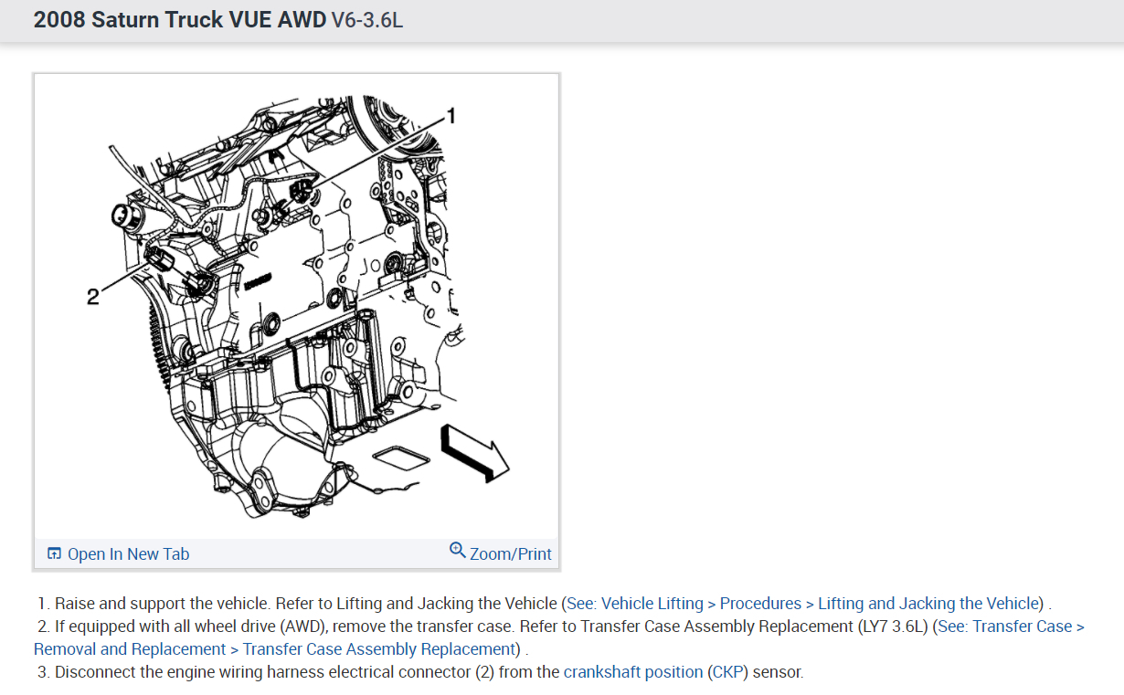

It is giving this code Crank shaft position - camshaft position correlation bank 1 sensor A
What will this make it do?
Apr 7, 2019 at 12:21 AM
SCGRANTURISMO
  • 4,897 POSTS

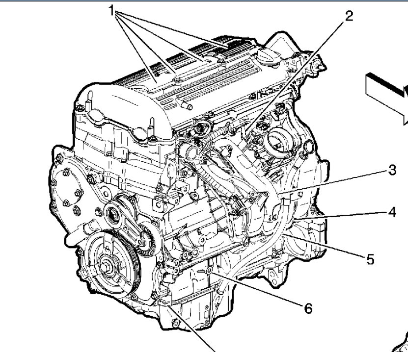

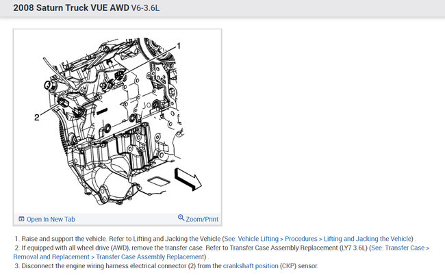

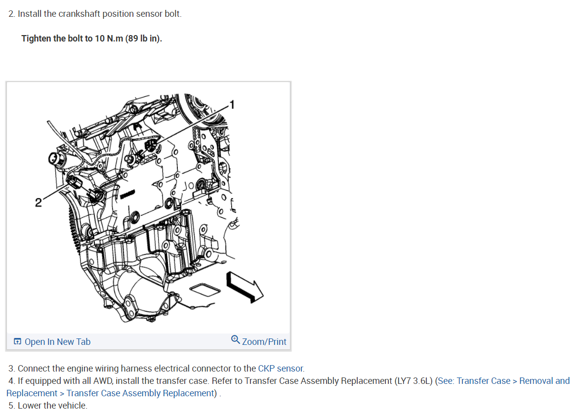

yep that will do it here are instructions so you can change the sensor out to help fix the problem. Here is a guide to help you step by step with instructions in the diagrams below to show you how on your car.
Check out the diagrams (Below). Let us know what happens and please upload pictures or videos of the problem.
Apr 7, 2019 at 12:26 AM
JESSIE79
that did the trick it is running once again !! thank you.

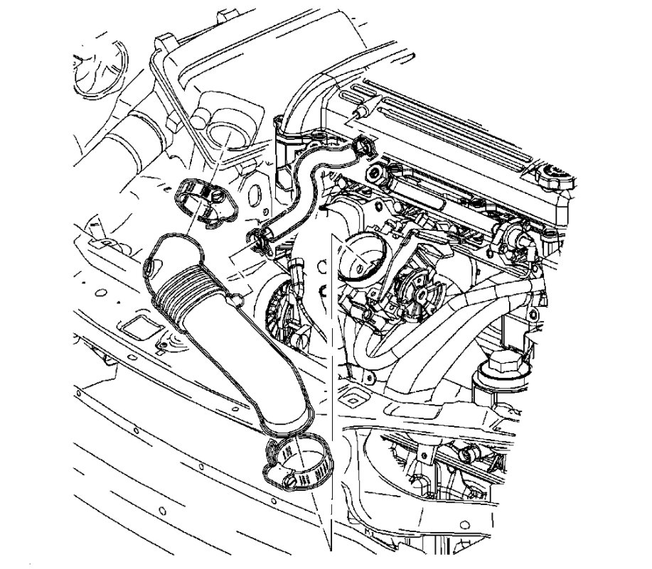

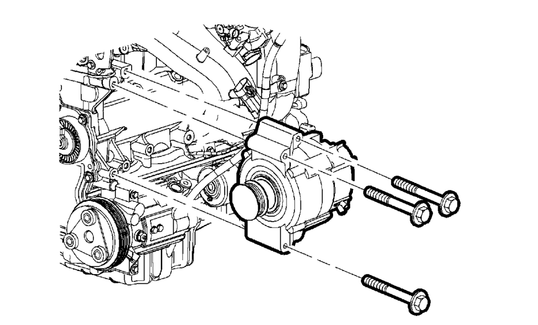

Good morning,
I would recheck your work and make sure you did not leave something disconnected. The crank sensor is behind the alternator. Make sure it is plugged in and not damaged.
GENERATOR REPLACEMENT
TOOLS REQUIRED
J 44811 Accessory Belt Tensioner Unloader
REMOVAL PROCEDURE
1. Turn the ignition OFF.
IMPORTANT: Record all pre-set radio stations.
2. Disconnect the negative battery cable.
3. Remove the throttle body air duct.
4. Remove the accessory drive belt.
IMPORTANT: Use the required J 44811.
5. Disconnect the generator electrical connections.
6. Remove the generator to engine block bolts and the generator.
