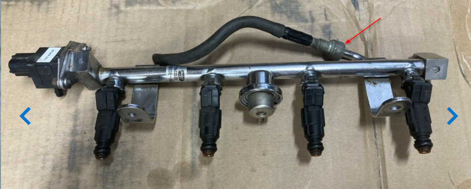

Sounds like the same problems as the gentleman you was advising about the fuel pump... Doing a lot of the same actions... I don't see a port on the rail..
But I see a port on some other component that has fuel lines running into it. It's located in the passenger firewall at back of engine... Please help. Thank you for your time..
Sep 12, 2020 at 9:30 AM

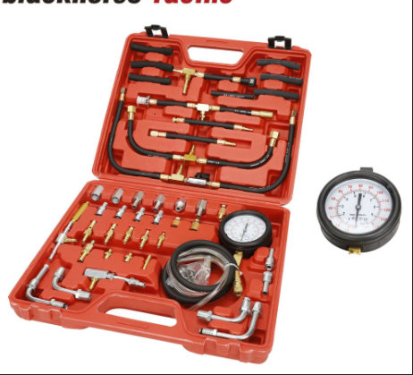

That is correct. I don't believe the Focus has a valve. You will need a kit that contains a "T" fitting for when you remove the fuel line and you install the T in line so that you can connect the gauge to it.
Most all test kits come with these adapters so clearly you just need one that fits the inlet line to the rail.
I attached a couple of pictures that show the tester and then the inlet line that you want to put the T in.
Let us know what questions you have. Thanks
