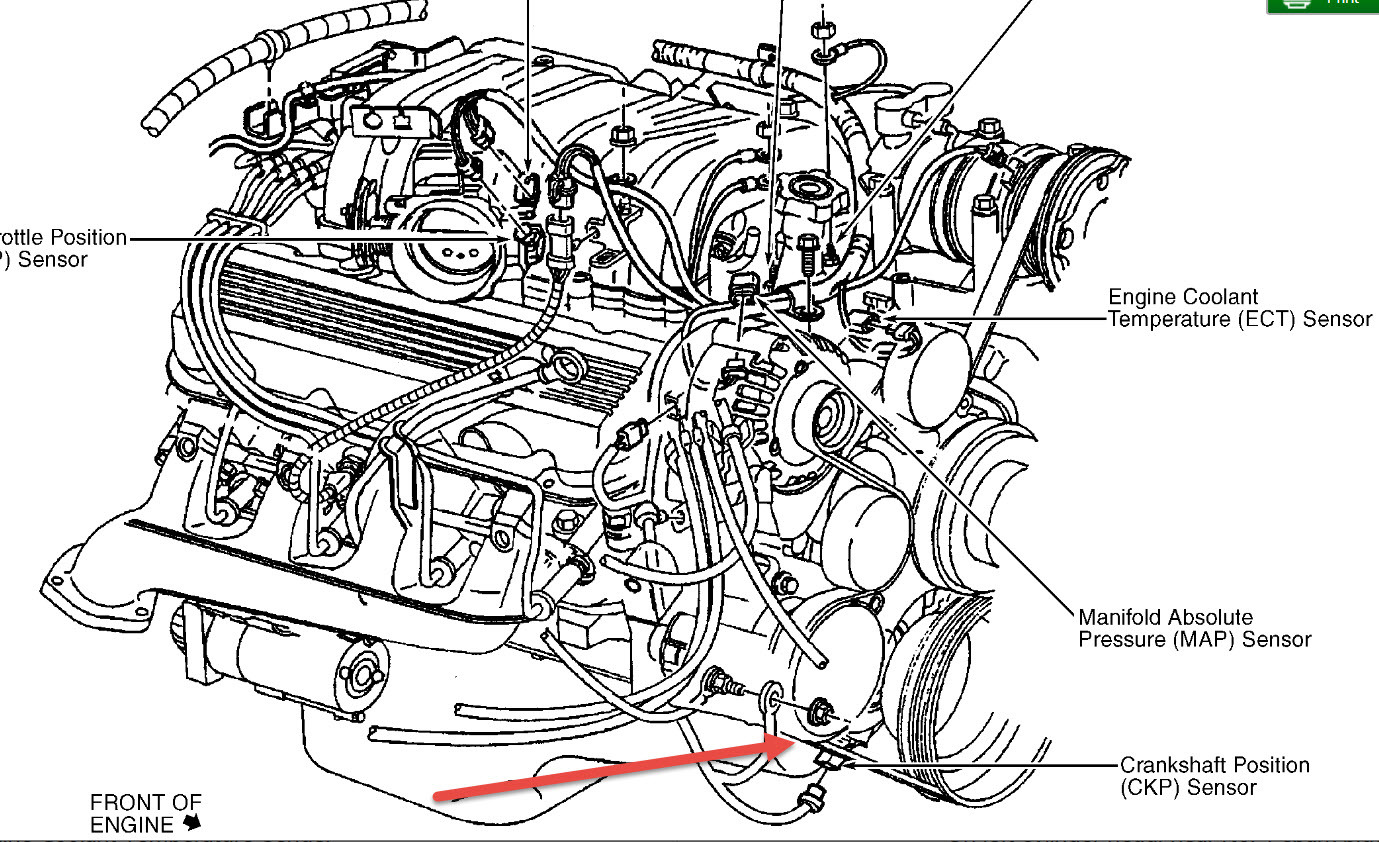

I replaced the fuel pump because it didn't sound like it was working. I replaced it in the spring so I thought I had a bad one. Not the problem. Checked for spark at #1 by pulling plug and grounding on manifold while my wife turned it over. It didn't spark. I took the coil and ICM to Autozone to have them check them and they said they were good. Any suggestions? I understand that the crank position sensor could be the culprit. Where is it located please? Thank you, Jack

this shold be scanned for codes but check crank sensor it may have a buildiup of sludge on it. its in timing cover.
