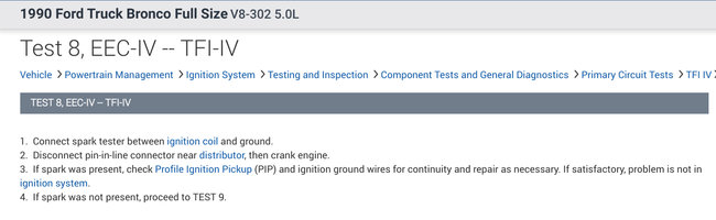

Hello again,
Okay, so this sounds like a problem with your vehicle's ignition system. In the diagrams down below I have included a diagnostic troubleshooting guide for you on your vehicle's ignition system. Please go through it and get back to us with the results. We will go from there.

NICK TURNER
There’s spark, it’s backfiring,but won’t fully start.

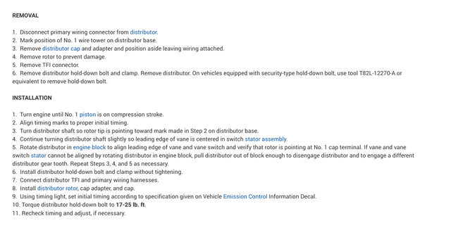

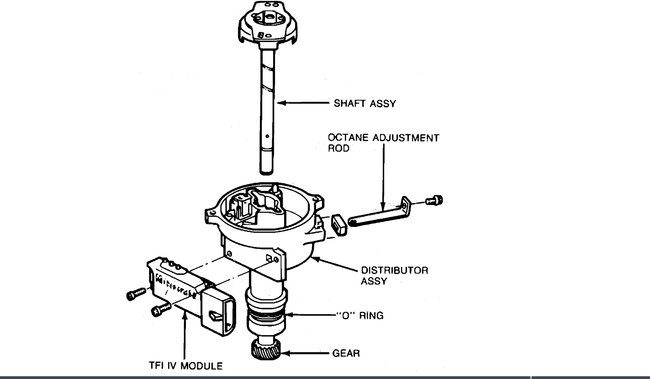

Hello again,
Okay, you are getting spark, but this could be that your vehicle's rotor is 180 degrees out. In the diagrams down below I have included the instructions for how your vehicle's cap and rotor are to be installed. Can you please go through this guide and ensure that your vehicle's cap and rotor are okay and installed properly. Please get back to us with the results. If okay we can move on to the fuel system.
