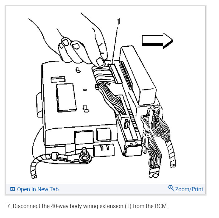

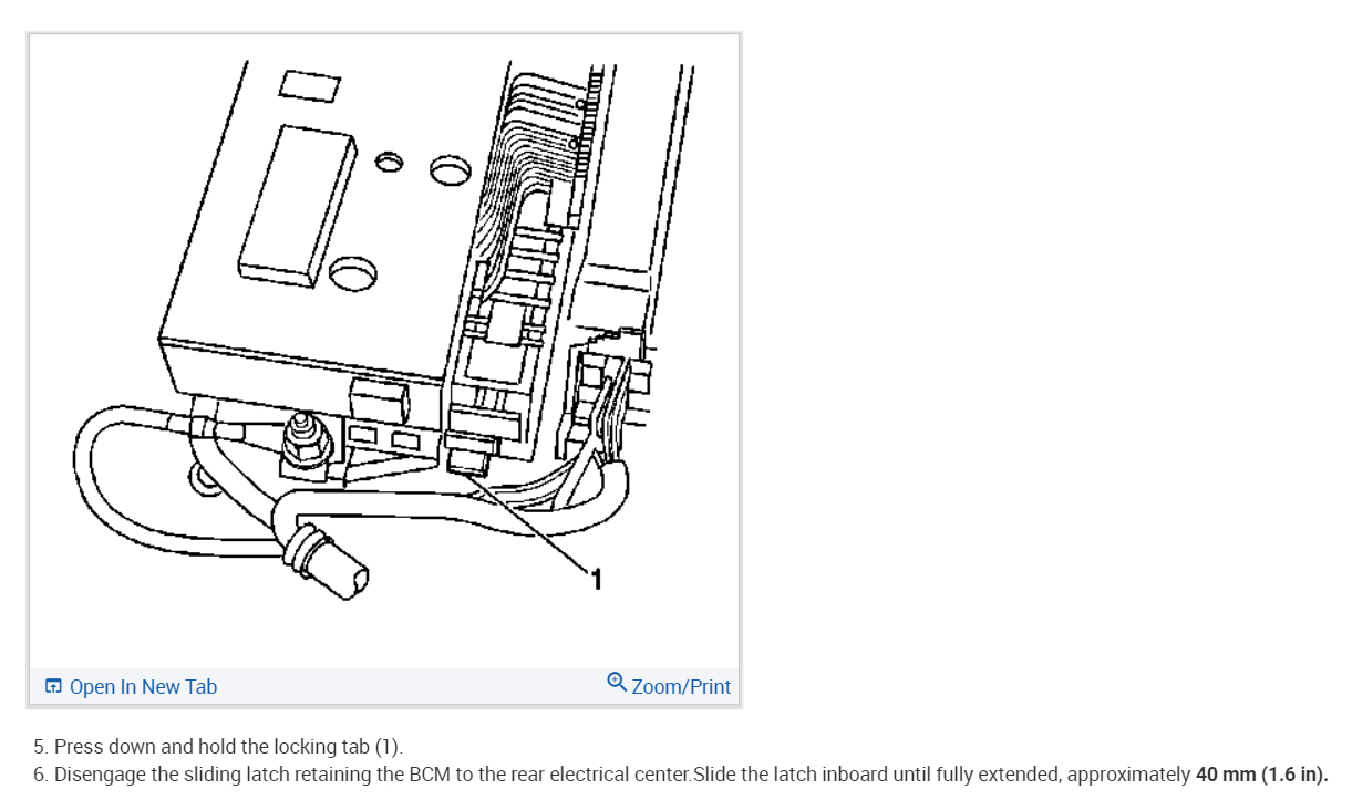

When I put my key in the ignition, when my lights are on without the key, my gas gauge is low, my turning signal is on to long the warning sounds (ding, ding, ding) has become very soft almost to the point of nonexistent. Could this be a fuse or a sensor? I just installed a new battery but that didn't take care of the problem. Do you know what it might be? Radio is still working too.

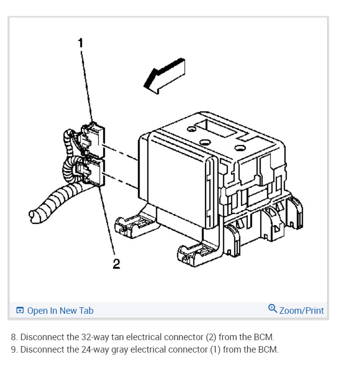

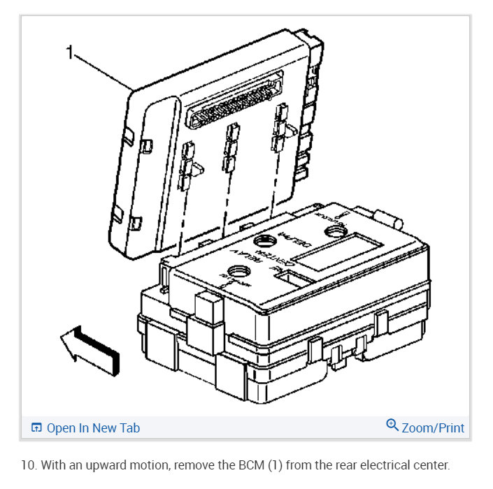

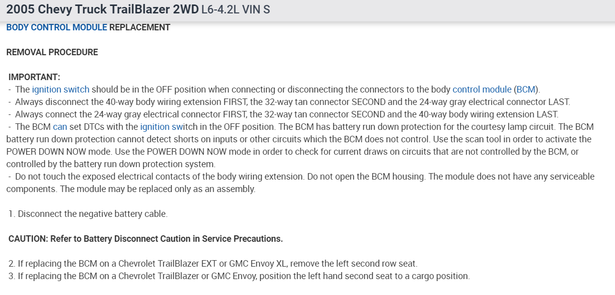

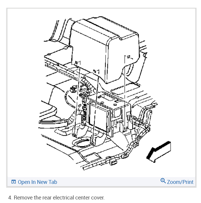

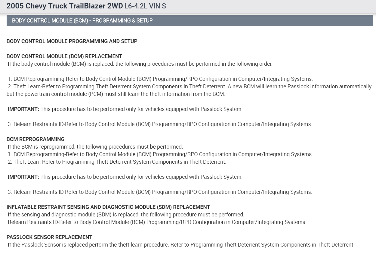

Does the engine start and run? If so, it sounds like the BCM is going out. To be sure I think a CAN scan will tell us if it is bad. A CAN scan is easy to do. You can get a CAN scanner (Controller Area Network) from Amazon for about $30.00.
https://youtu.be/u-4syLc-ifQ
Here is a scanner link:
https://amzn.to/3o41KcZ
I have left the BCM replacement instructions and location in the images below just in case. Check out the diagrams (below). Please let us know what you find. We are interested to see what it is.
