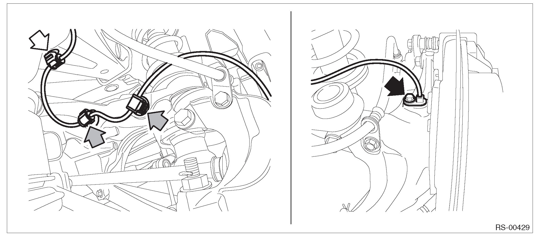

FRONT SENSOR
Front ABS Wheel Speed Sensor
REMOVAL
1) Disconnect the ground cable from battery.
2) Lift up the vehicle, and then remove the front wheels.
3) Remove the front ABS wheel speed sensor.
CAUTION:
^ Be careful not to damage the sensor.
^ Do not apply excessive force to the sensor harness.
^ Leave the sensor harness clamp on the vehicle side.

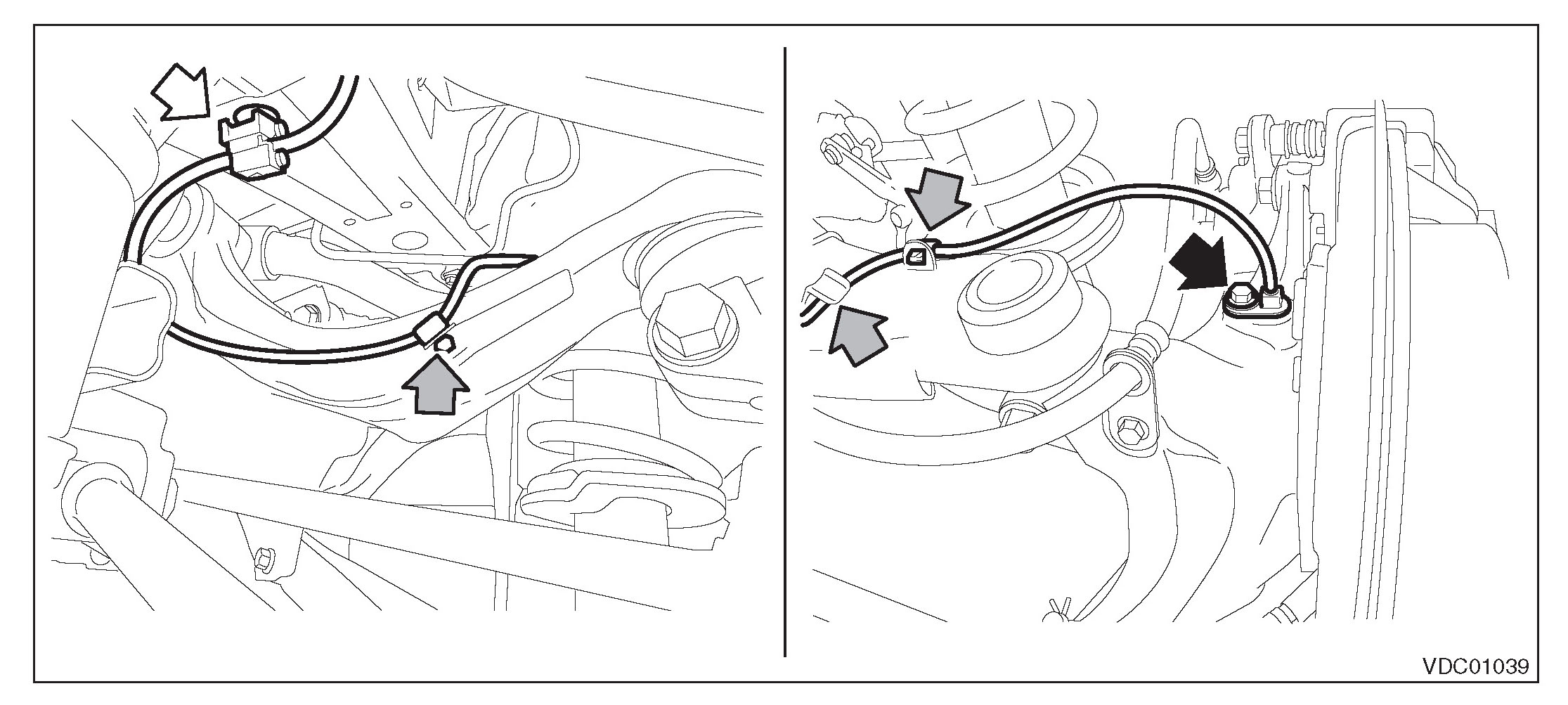

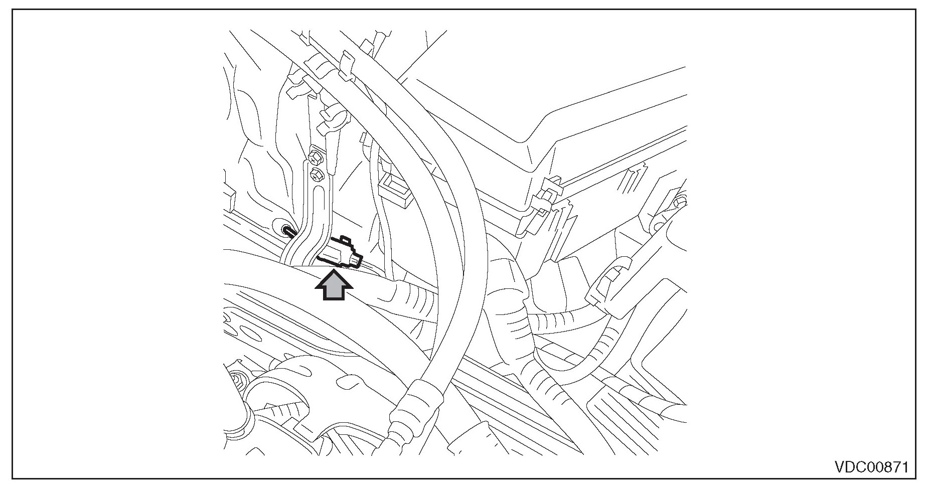

(1) Disconnect the connector of the front ABS wheel speed sensor in the engine compartment.
pic 1
(2) Remove each harness clip and grommet.
(3) Remove the bolts, and remove the front ABS wheel speed sensor from the housing assembly - front axle.
pic 2

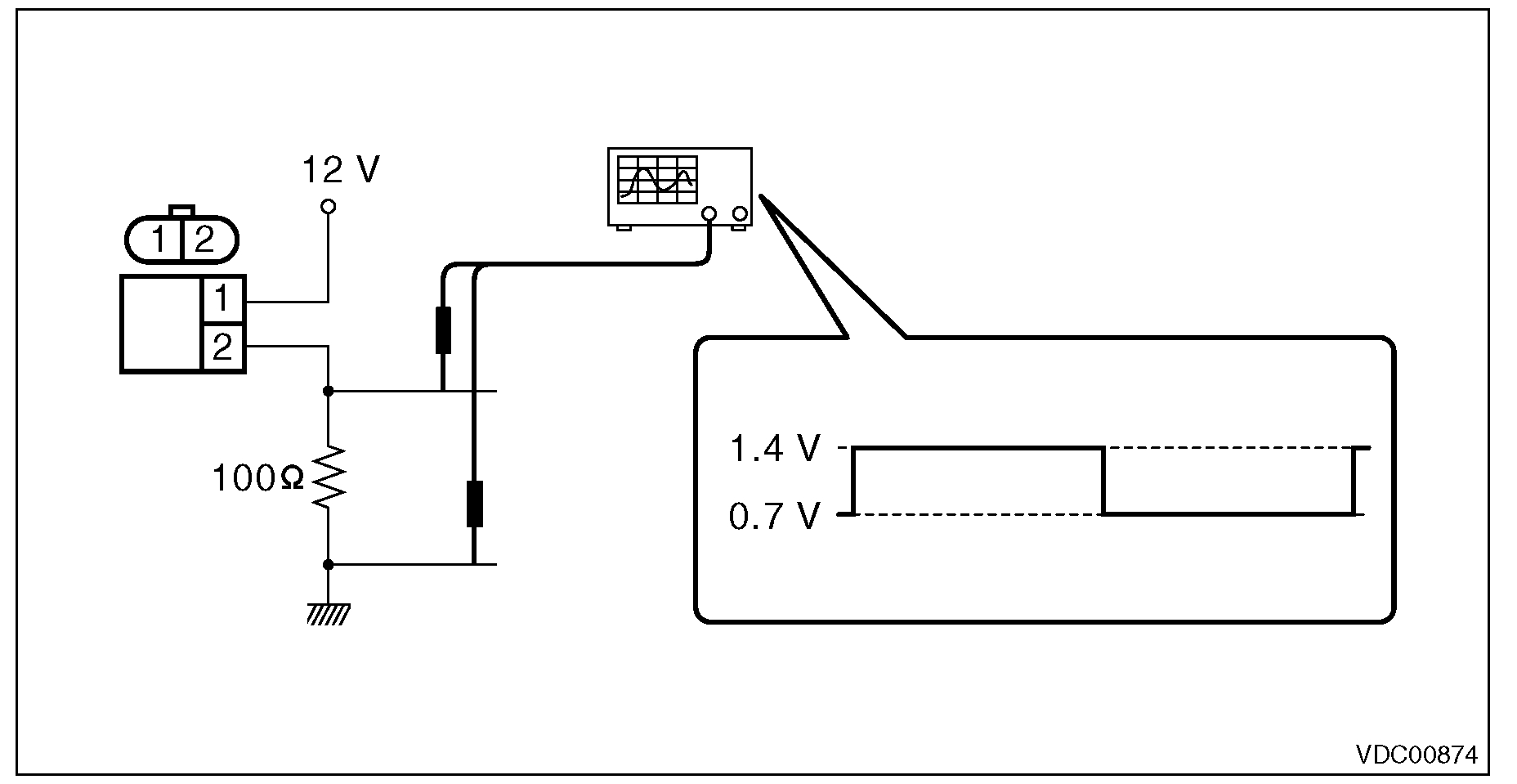

4) Connect a 12 V power supply to No. 1 terminal of ABS wheel speed sensor connector, then attach resistance to the No. 2 terminal. Rotate the wheel at about 2.75 km/h (2 MPH), and measure the voltage using an oscilloscope.
Standard value of output voltage:
0.7 - 1.4 V
pic 3
5) Replace the ABS wheel speed sensor if the inspection result is not within the standard value.

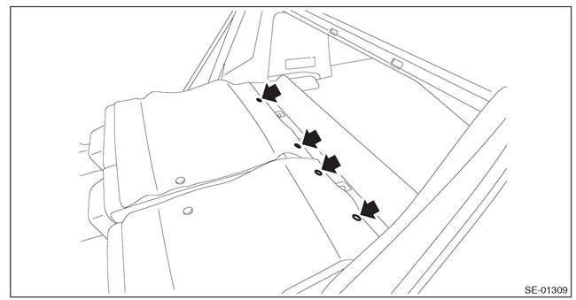

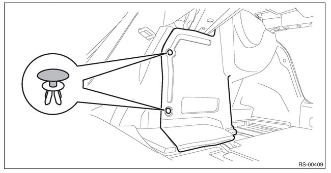

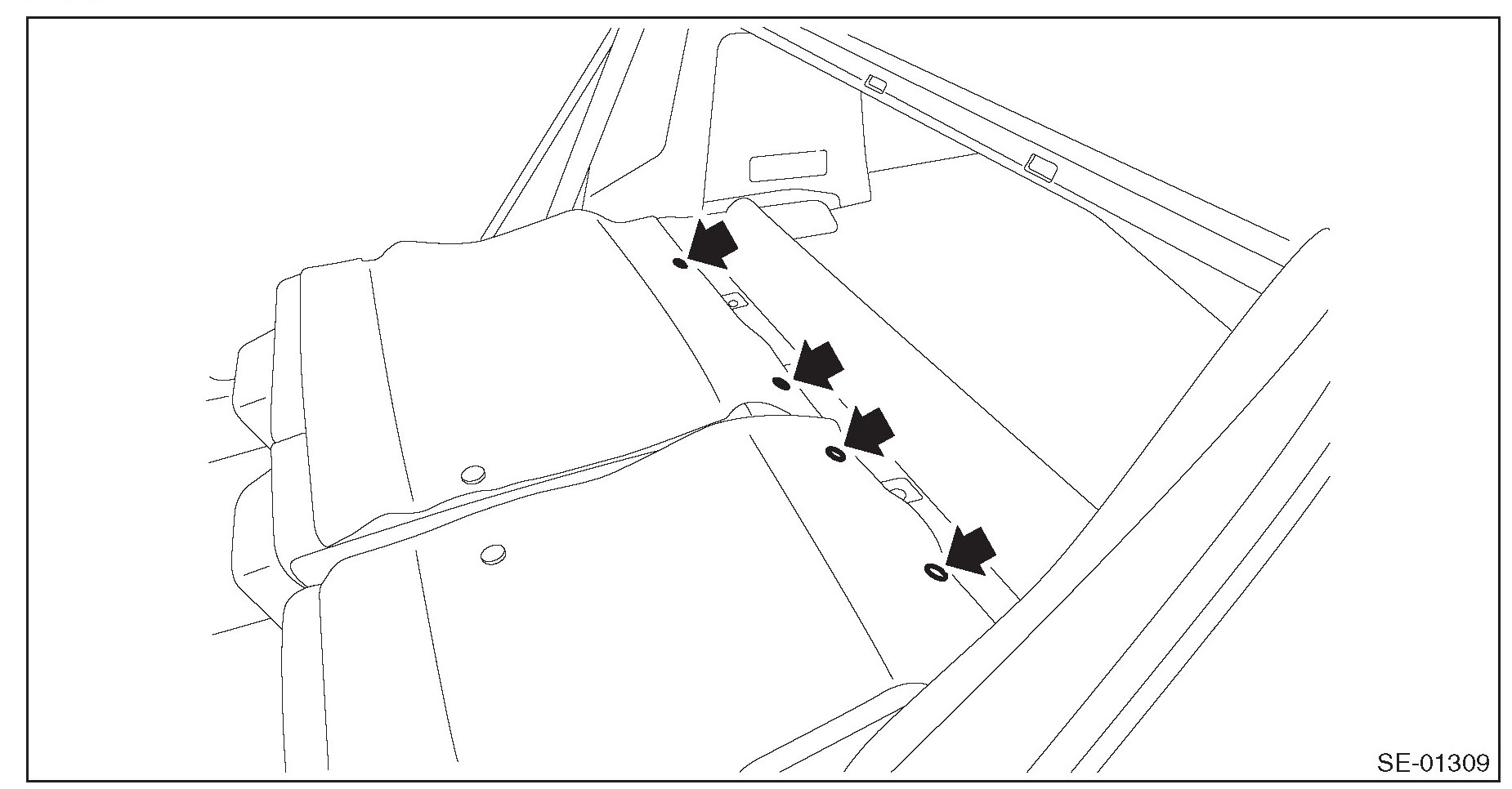

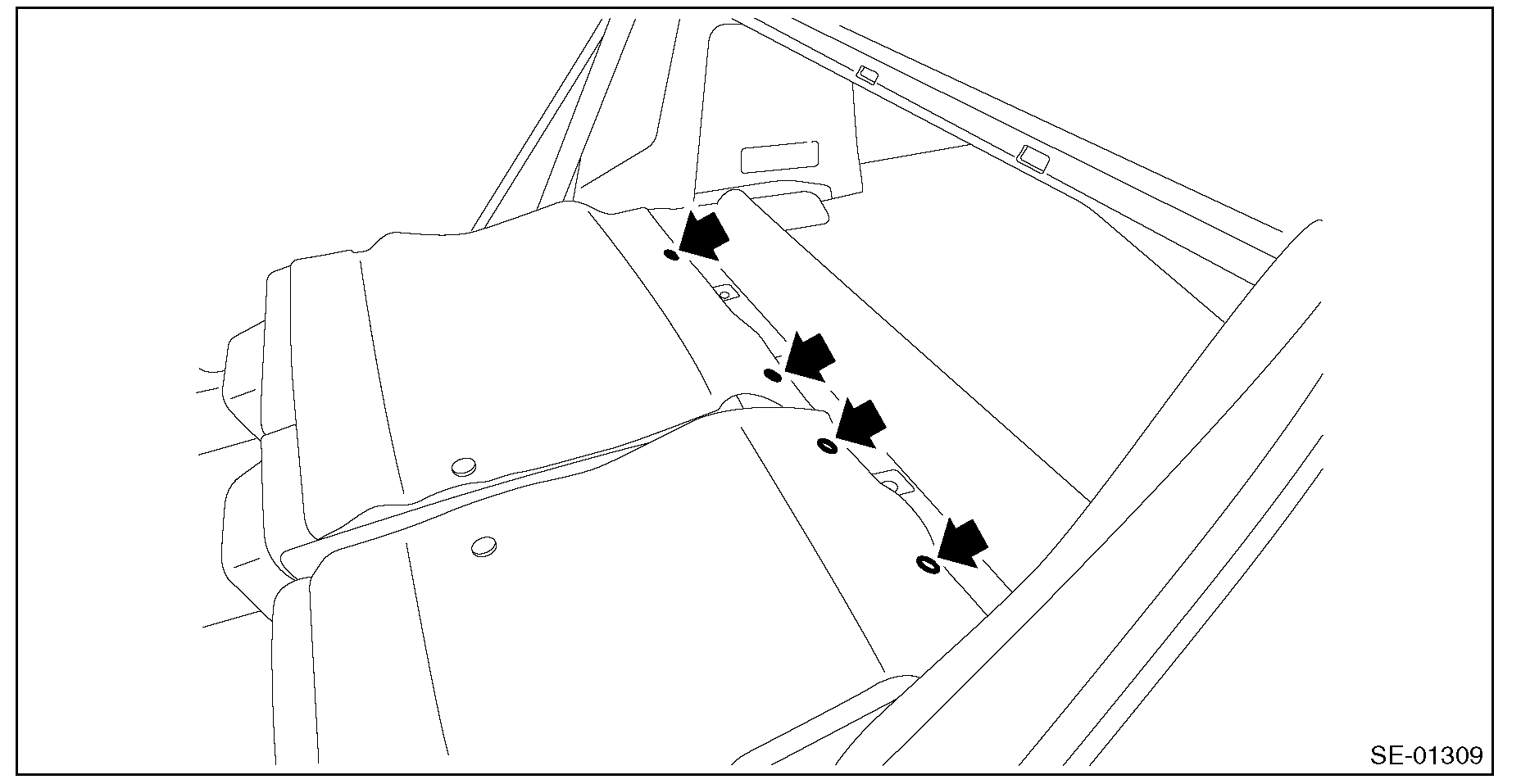

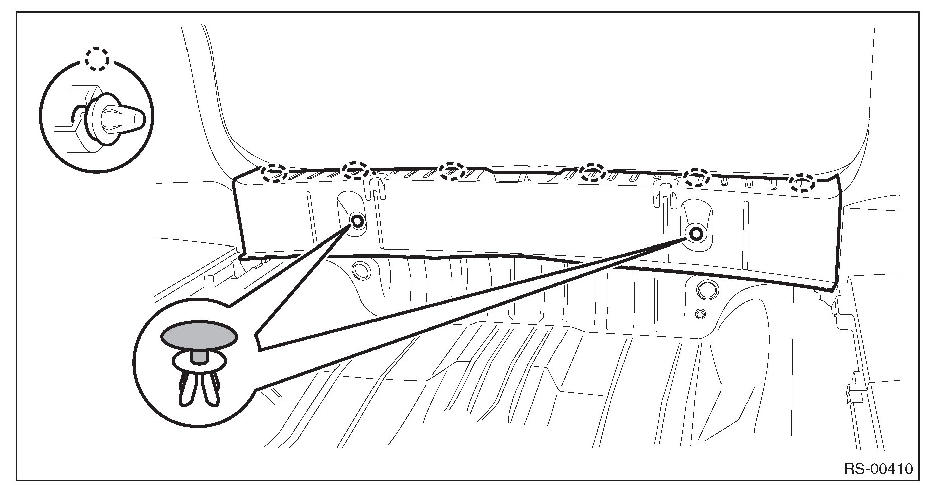

(1) Take out the trunk mat.
(2) Tilt the backrest assembly of the rear seat forward.
(3) Remove the clips located at the bottom of the cover COMPL - rear backrest LH and RH of the rear seat back.
pic 4

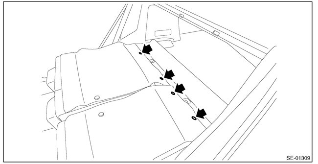

(4) Remove the clips, and turn over the trim panel - trunk side.
pic 5

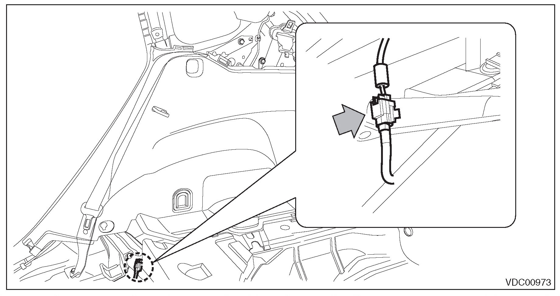

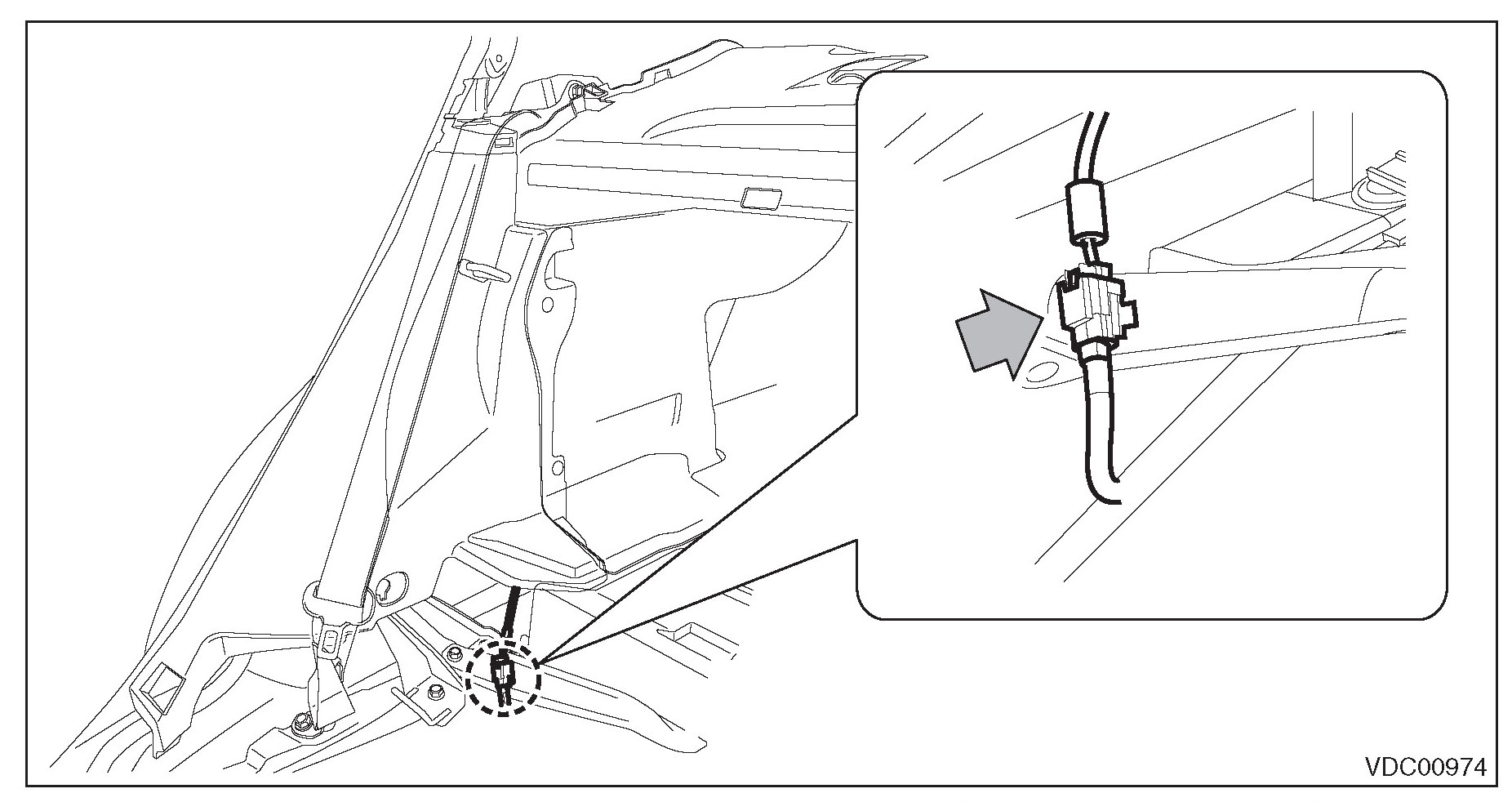

(5) Disconnect the connector of the rear ABS wheel speed sensor.
pic 6

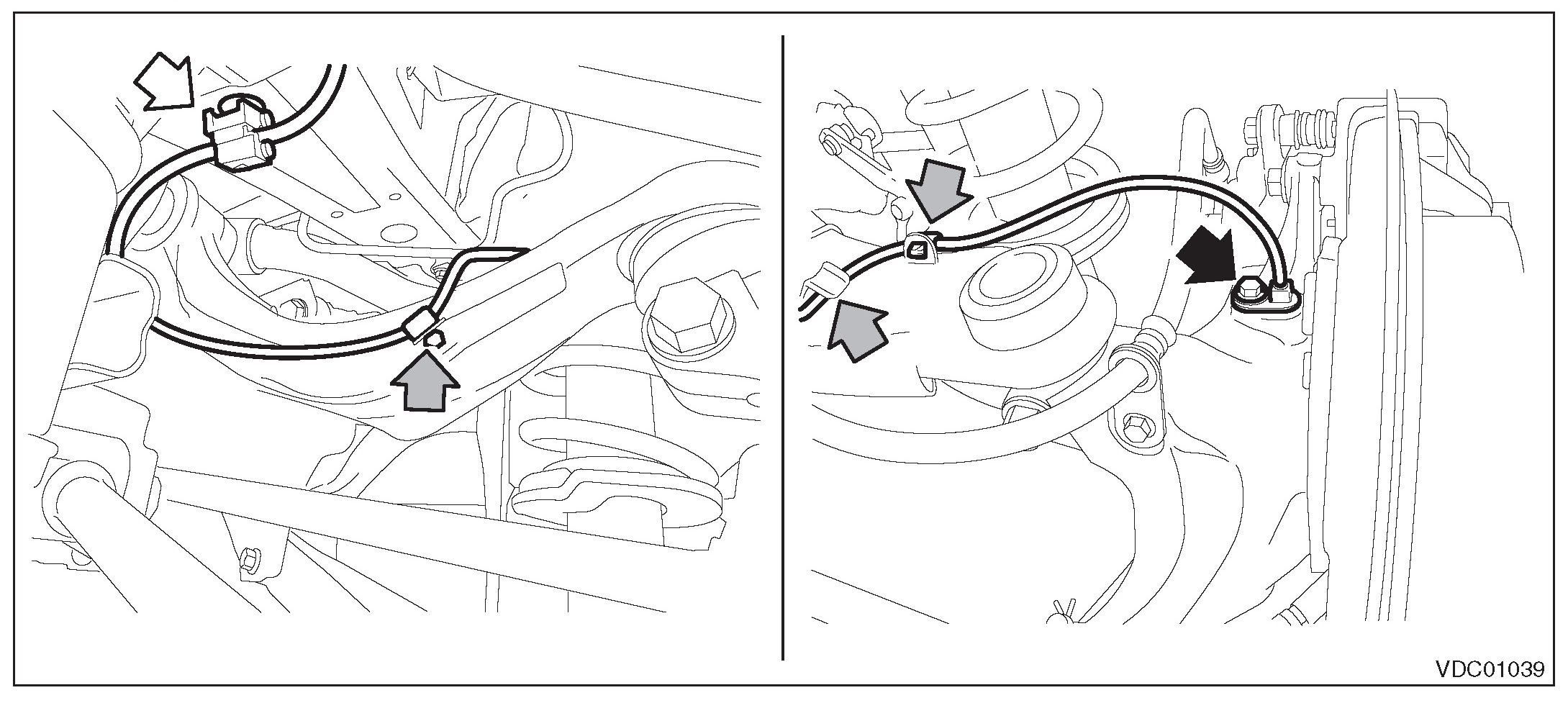

(6) Remove the grommet from the rear wheel housing, and pull out the connector of the rear ABS wheel speed sensor.
(7) Remove the harness clip and bolt, and remove the rear ABS wheel speed sensor.
pic 7

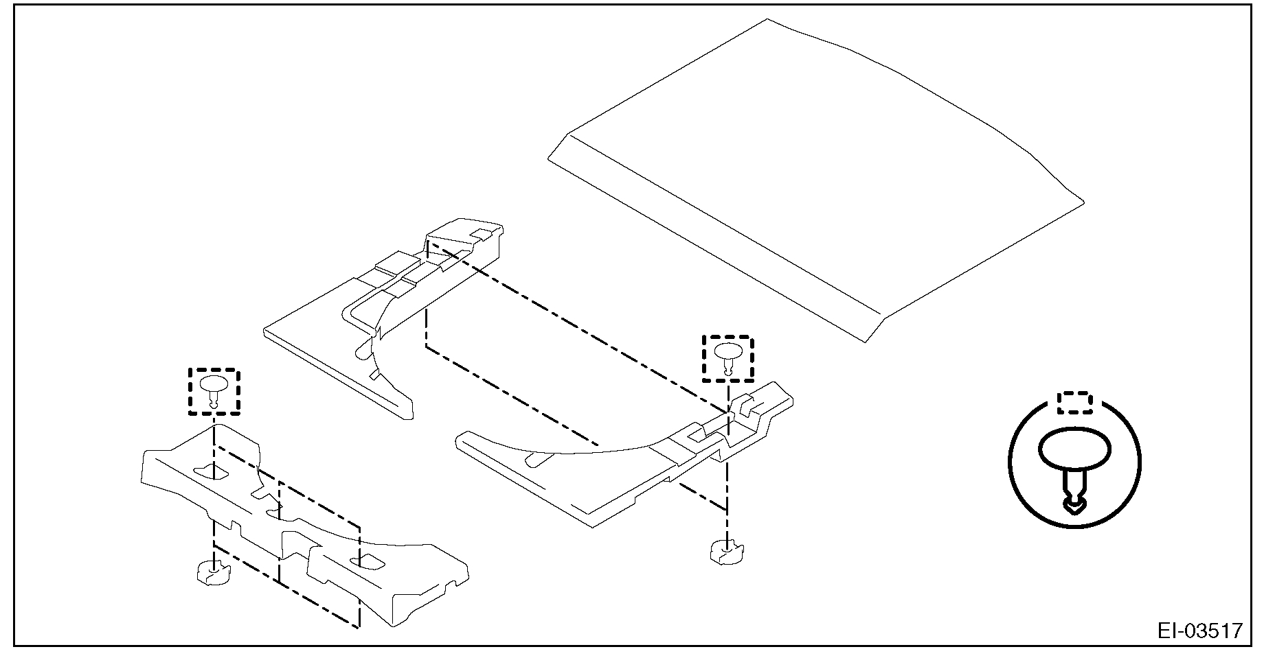

(1) Tilt the backrest assembly of the rear seat forward.
(2) Remove the clips located at the bottom of the cover COMPL - rear backrest LH and RH of the rear seat back.
pic 8

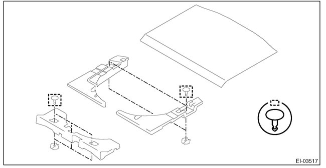

(3) Remove the mat - rear floor CTR and the spacer - rear floor side.
pic 9

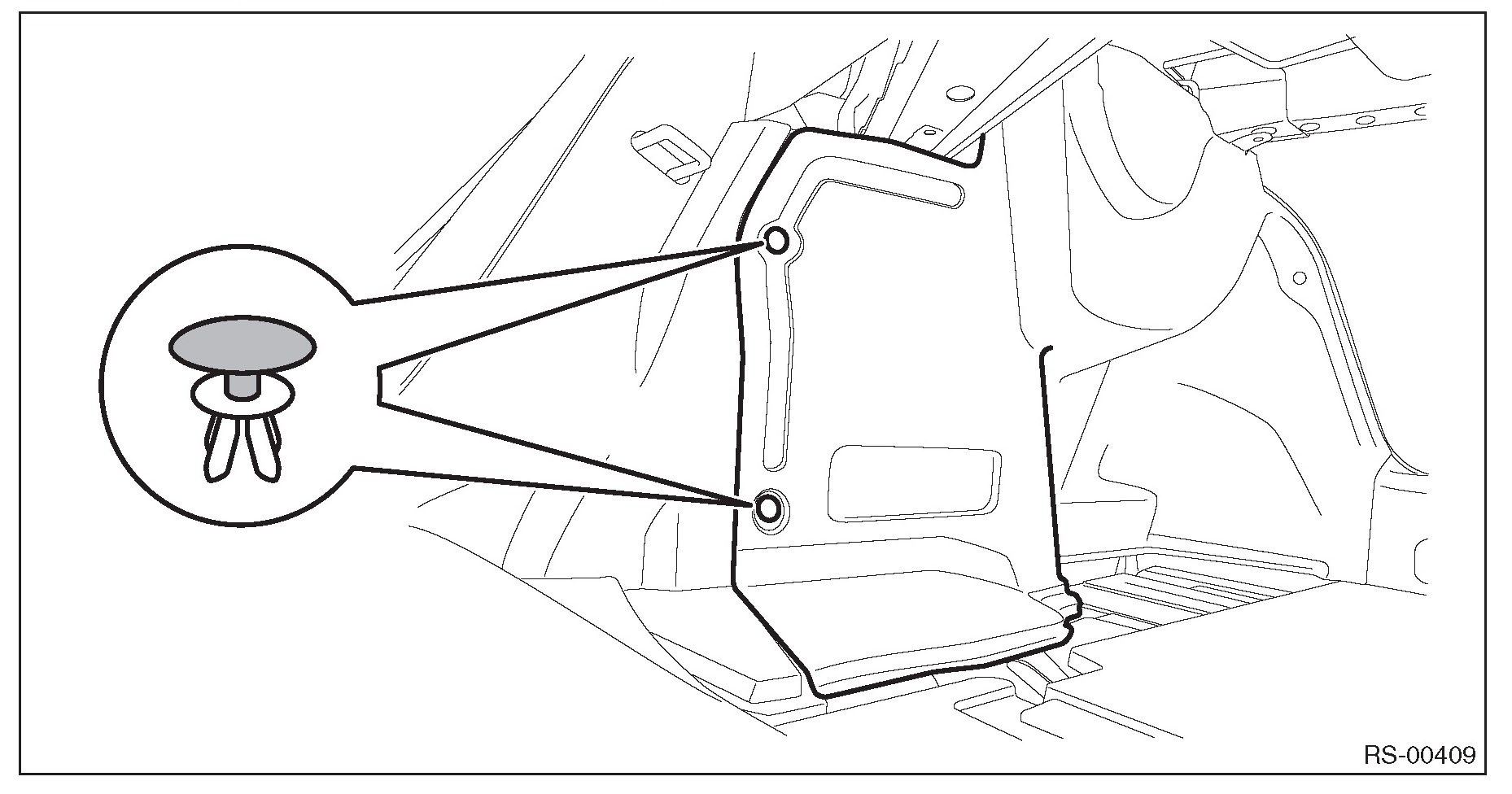

(4) Remove the clips, and remove the trim panel - rear skirt.
pic 10

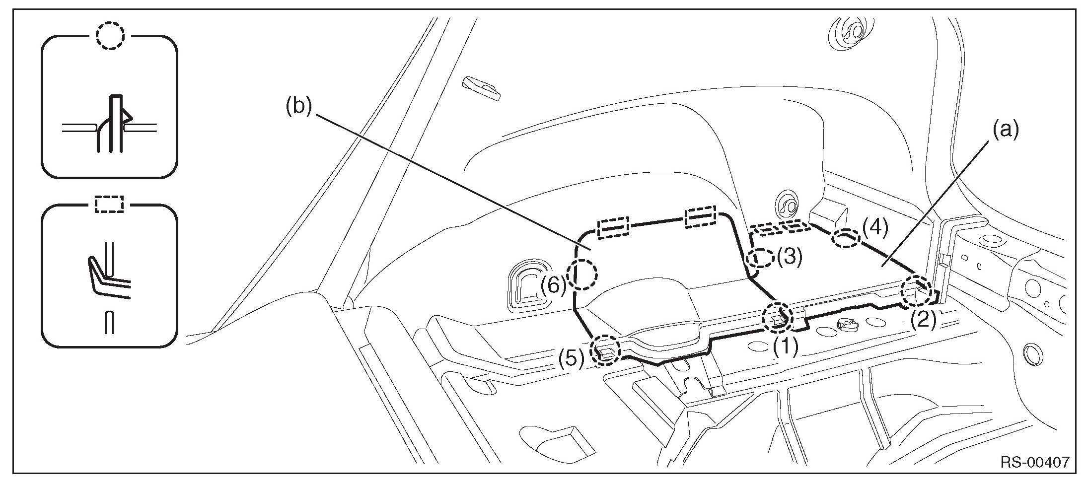

(5) Remove the lid upper rear (a) and the cap - rear strut (b) in the order from (1) to (6).
pic 11

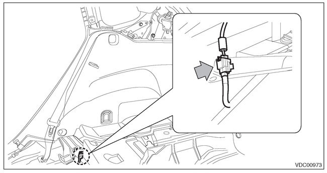

(6) Disconnect the connector of the rear ABS wheel speed sensor.
pic 12
(7) Remove the grommet from the rear wheel housing, and pull out the connector of the rear ABS wheel speed sensor.

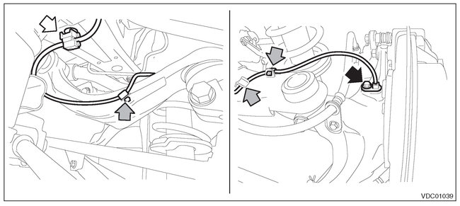

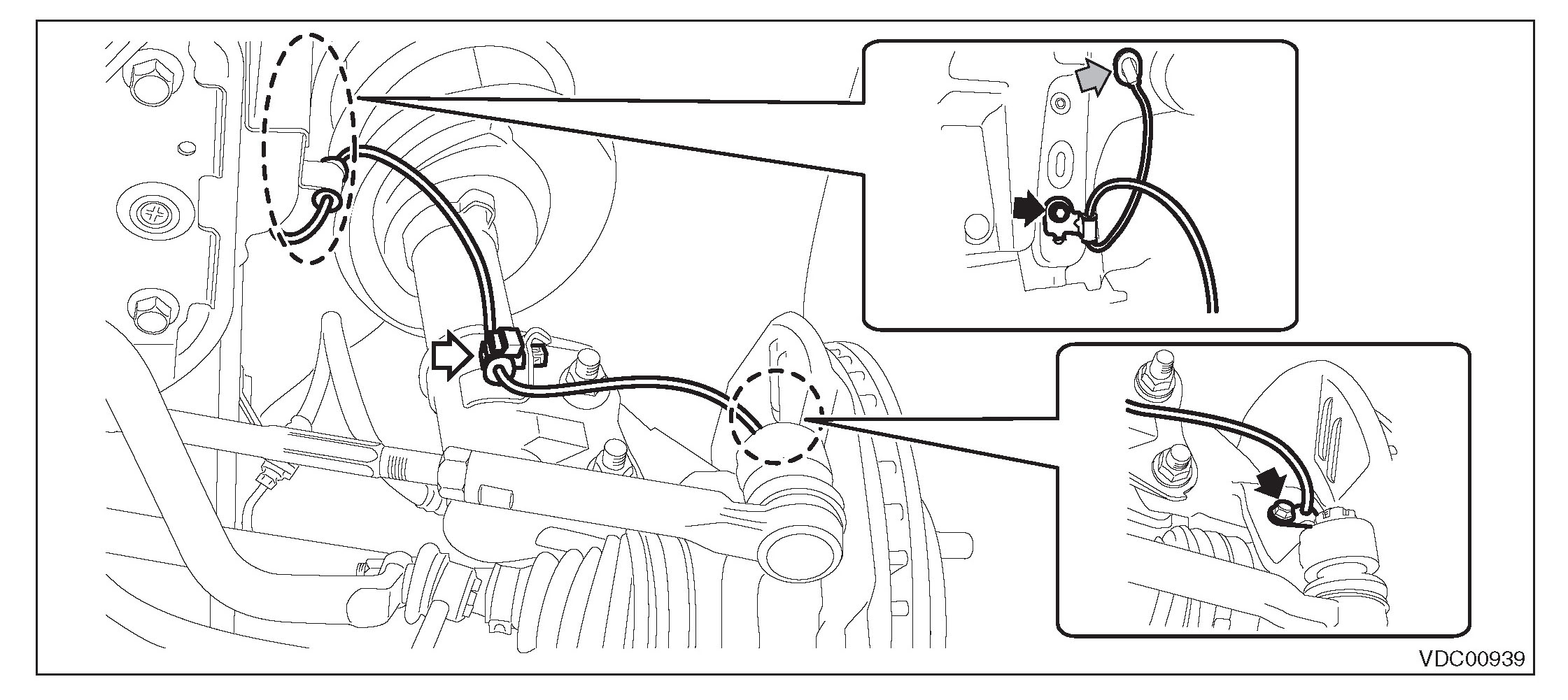

(8) Remove the harness clip and bolt, and remove the rear ABS wheel speed sensor.
^ Except for XV model
pic 13
^ XV model
pic 14
