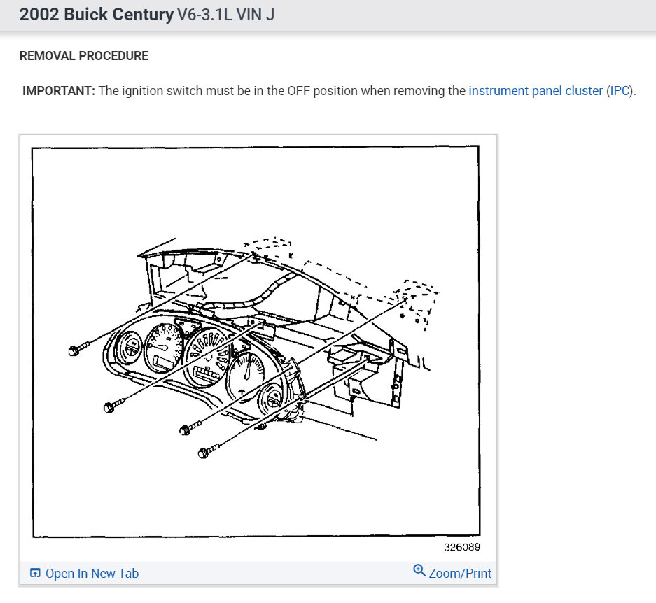

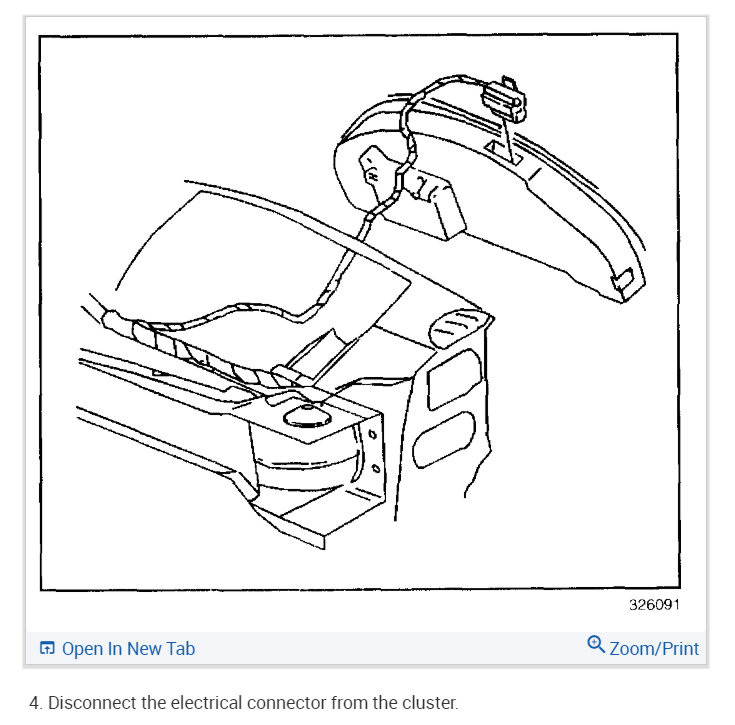

I have seen this before it happens when the cluster goes bad. here is a video of the repair being done on a similar car with instructions in the diagrams below to show you on your car:
https://youtu.be/_HEC44xENxw
Please let us know what happens, check the images below.
