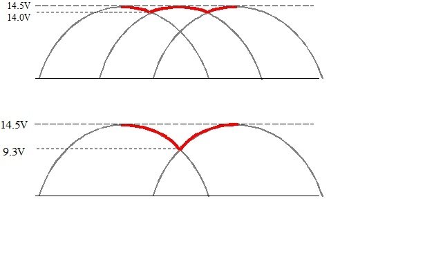

Besides rechecking that charging voltage test, they will measure "full-load output current", (which should come close to 105 amps), and "ripple" voltage. My drawings below show what ripple voltage looks like. The top waveform shows all three phases of output current. Ripple voltage is 0.5 volts, shown in red. The battery is the main component that smooths that out, and here it is very easy to do.
When one phase is missing due to the bad diode, ripple voltage will look like the red line in the lower drawing. Here it's 5.2 volts. There are a few testers that can make paper printouts. Those actually measure ripple voltage as a voltage. The majority of testers do not provide the actual voltage. Instead, they show it as "low" or "high" depending how many of a group of lights are flashing or lit up. When ripple voltage is high, output current is going to be one third of expected. Those two tests take just a few seconds to perform, and point to the failed diode.
