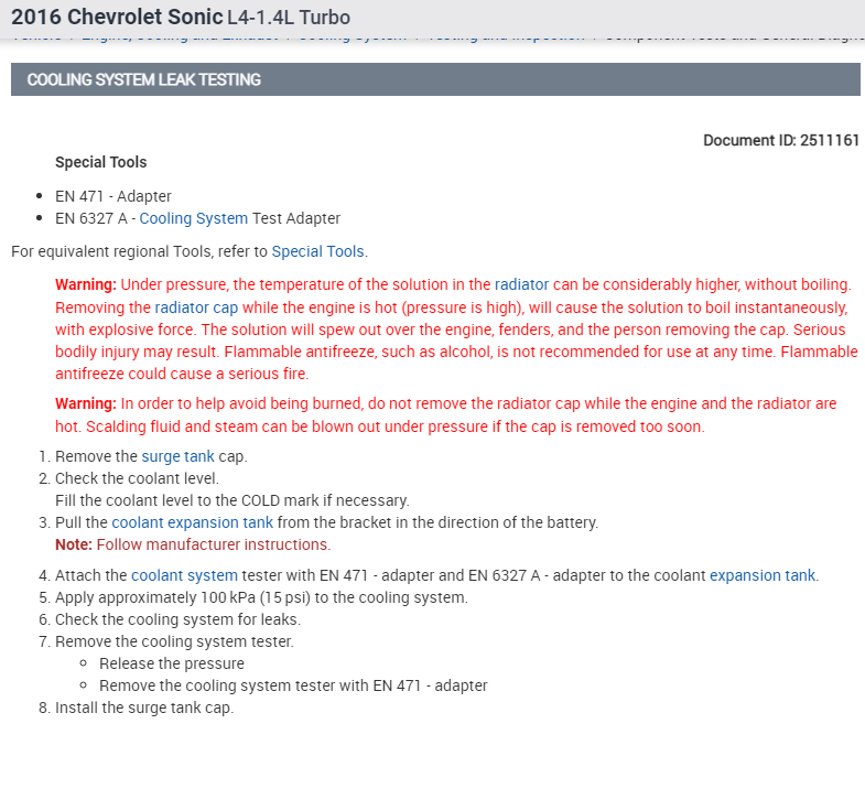

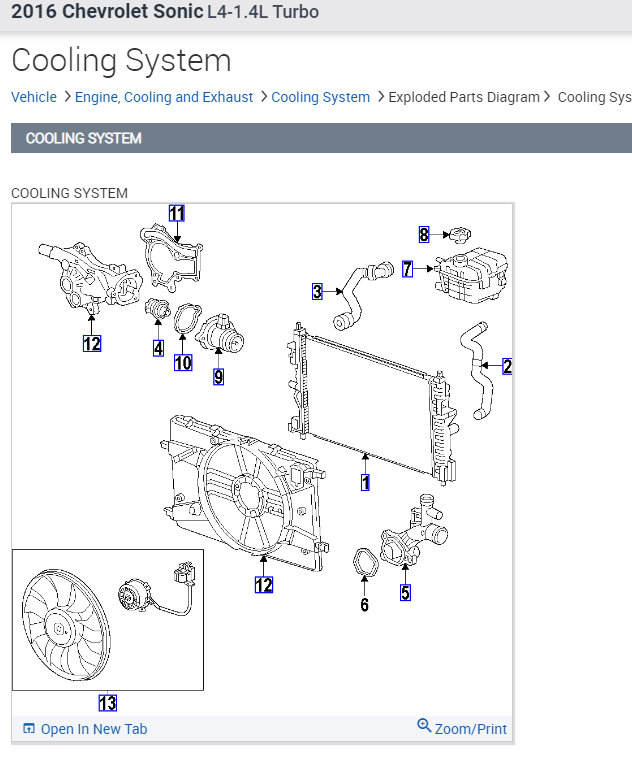

My car's warning lights came on last week and a friend changed out the radiator hose after he cut the other one off. Due to a leak in it. Now that the new hose is on, and I've driven it a little, the warning lights are coming back on. I added coolant three times and it drained out too much, I think. I'm not sure what's wrong with it.

Can you tell me which warning light you are getting? You can upload a picture if you're not sure.
If the coolant is leaking out, you will have to inspect and see where the leak might be coming from. It can leak from any of the hoses, from the water pump, even from the radiator.
Here are a couple of helpful articles:
https://www.2carpros.com/articles/coolant-leak-symptoms
https://www.2carpros.com/articles/car-is-leaking-coolant
Here is a leak testing video:
https://youtu.be/W8kra65m15c
