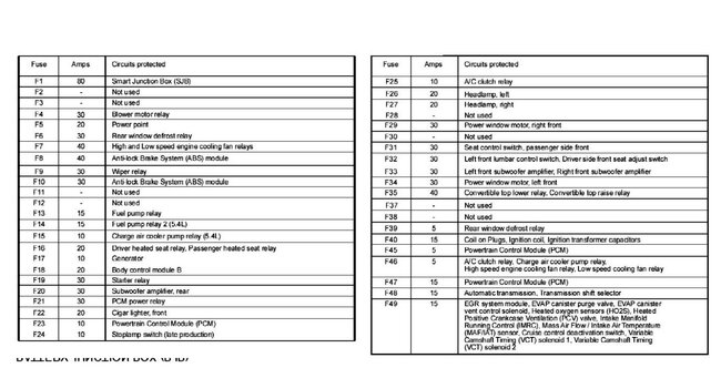

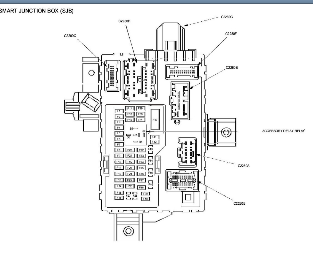

My car threw up the door ajar, trunk ajar, parking brake, tire pressure fault, and advance trac fault lights all at the same time as well as my radio and ac cutting on and off at random. The parking brake is completely released, and the doors are secured.
Jun 23, 2023 at 7:36 AM
  • 55,412 POSTS

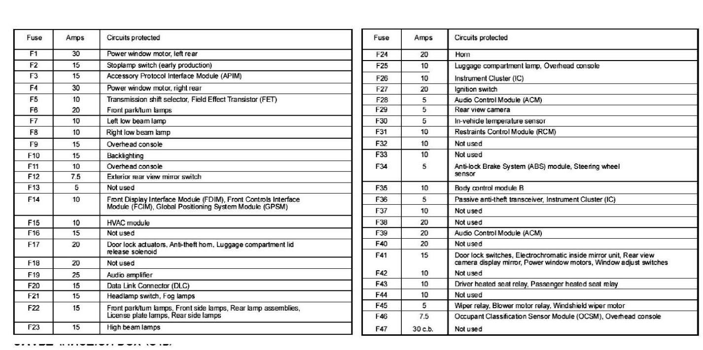

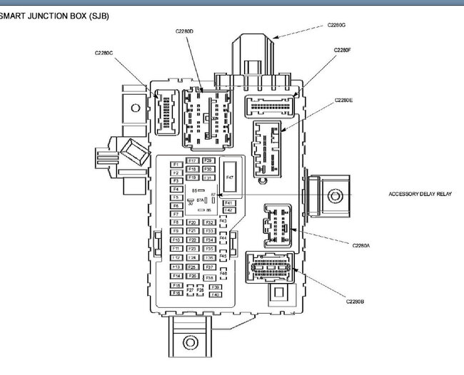

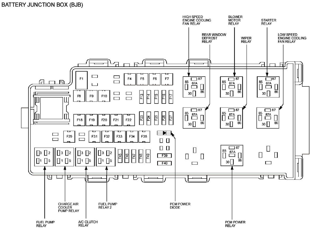

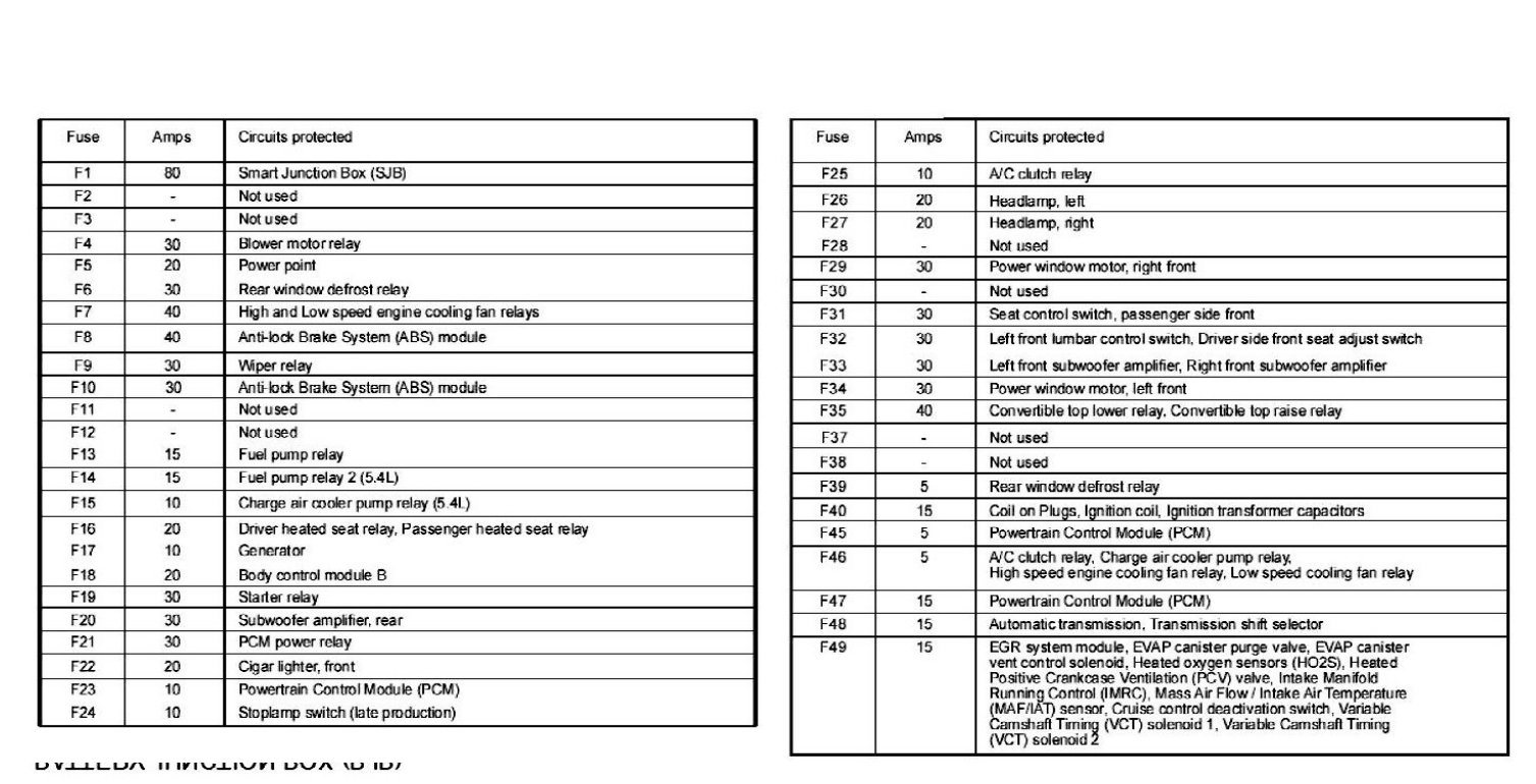

We should check the fuses first, here is a guide to help and the fuse locations below:

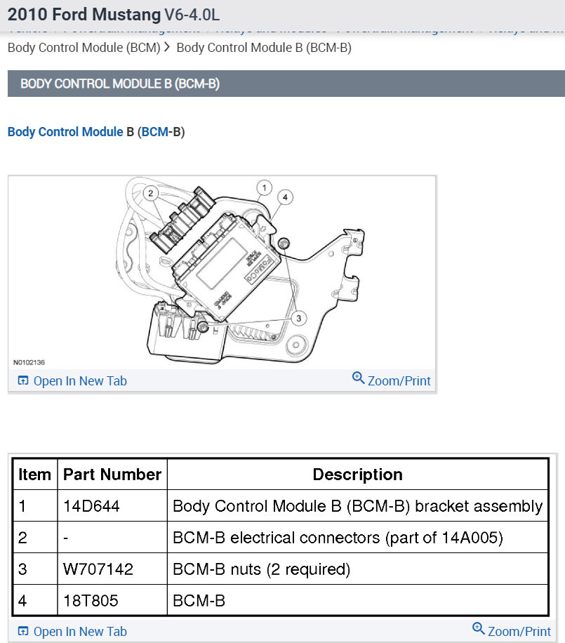

If the fuses are okay, this can happen when the BCM goes out but to be sure we should do a CAN scan, you can get a CAN scanner (Controller Area Network) which will work on most cars from Amazon.

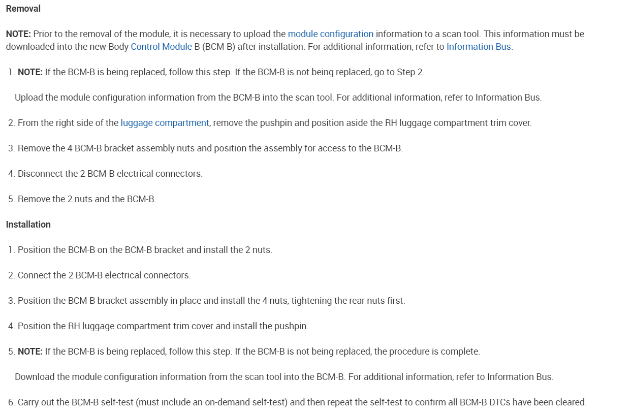

Here is how to change the BCM out in case you need it, you can get a preprogrammed unit by searching Google or Ebay. Check out the images (below). Let us know what happens and please upload pictures or videos of the problem so we can see what's going on.
