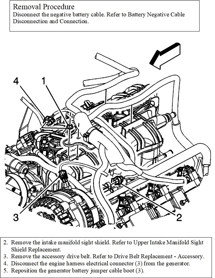

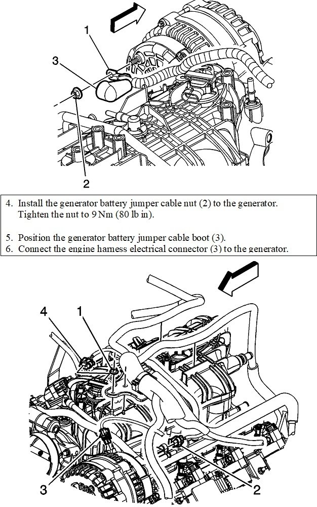

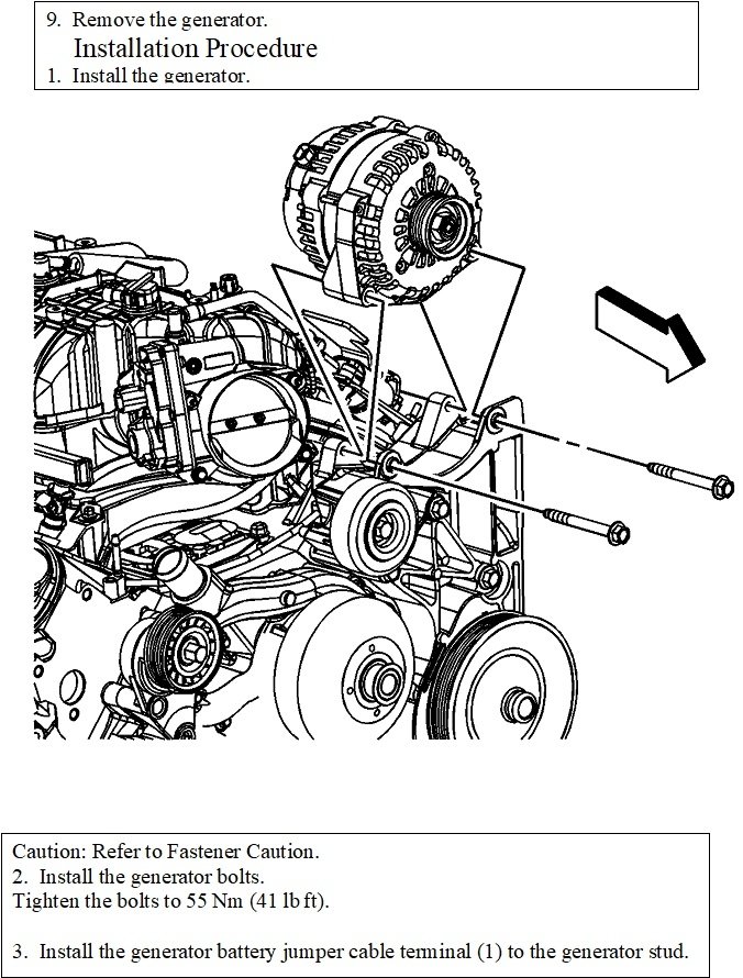

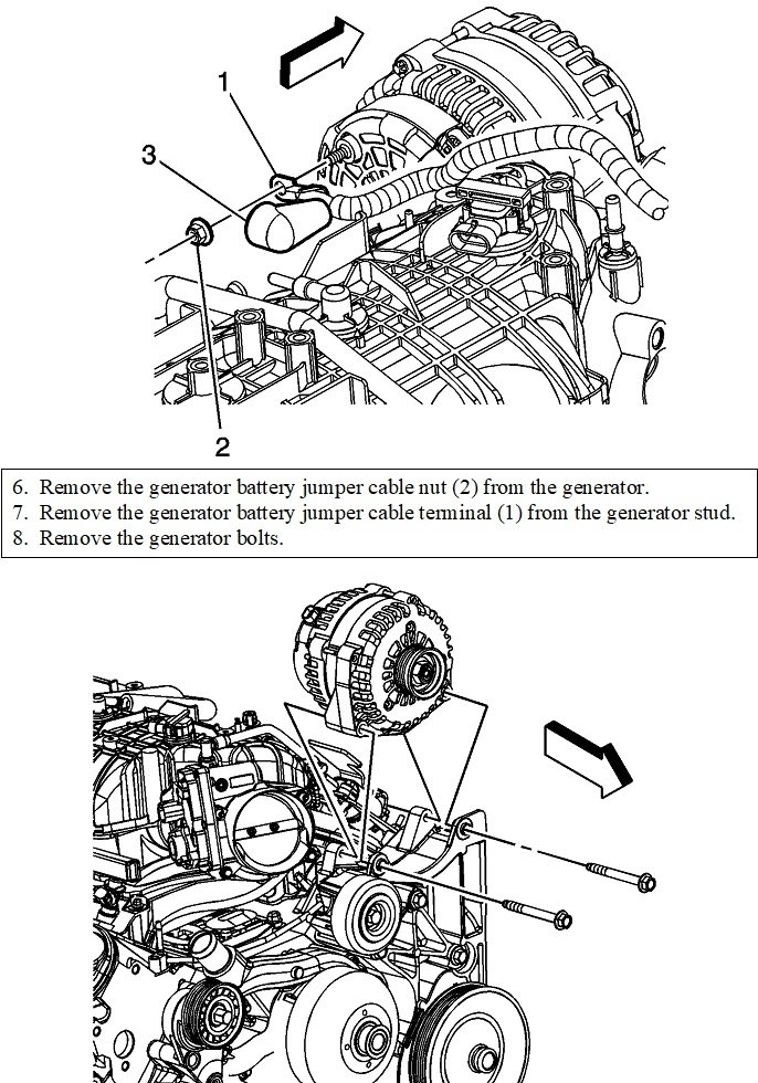

If testing proves my suspicion is correct, here's the instructions for generator replacement should you choose to do this yourself. This applies to every engine except the 4.3L.
