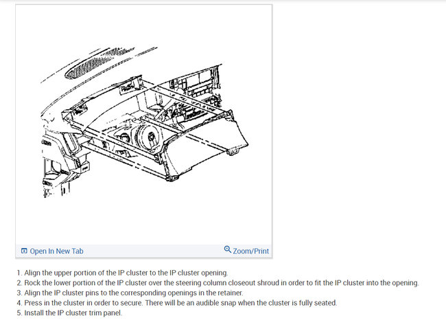

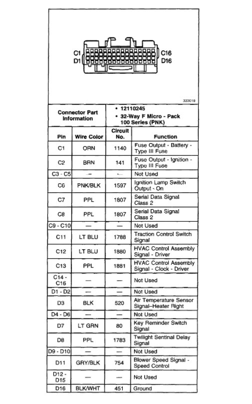

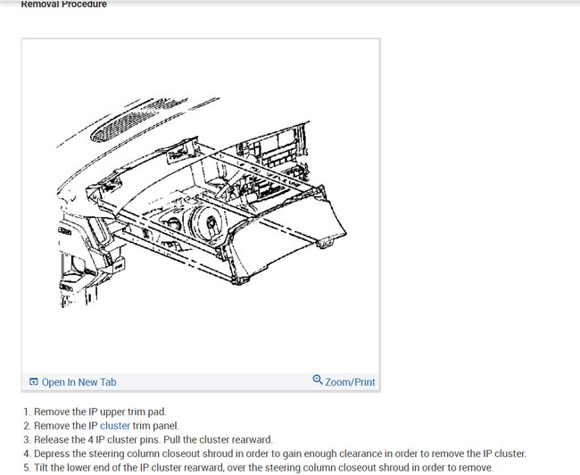

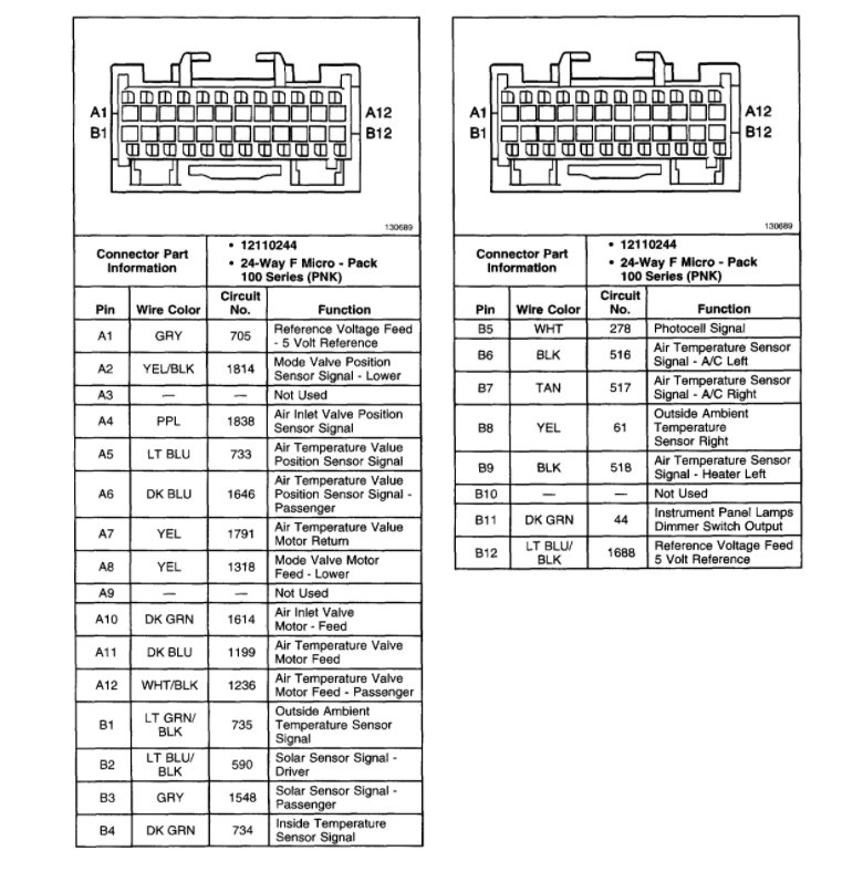

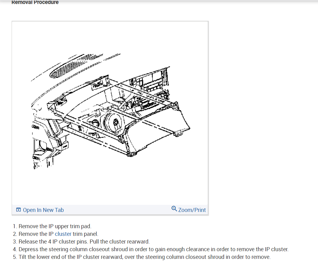

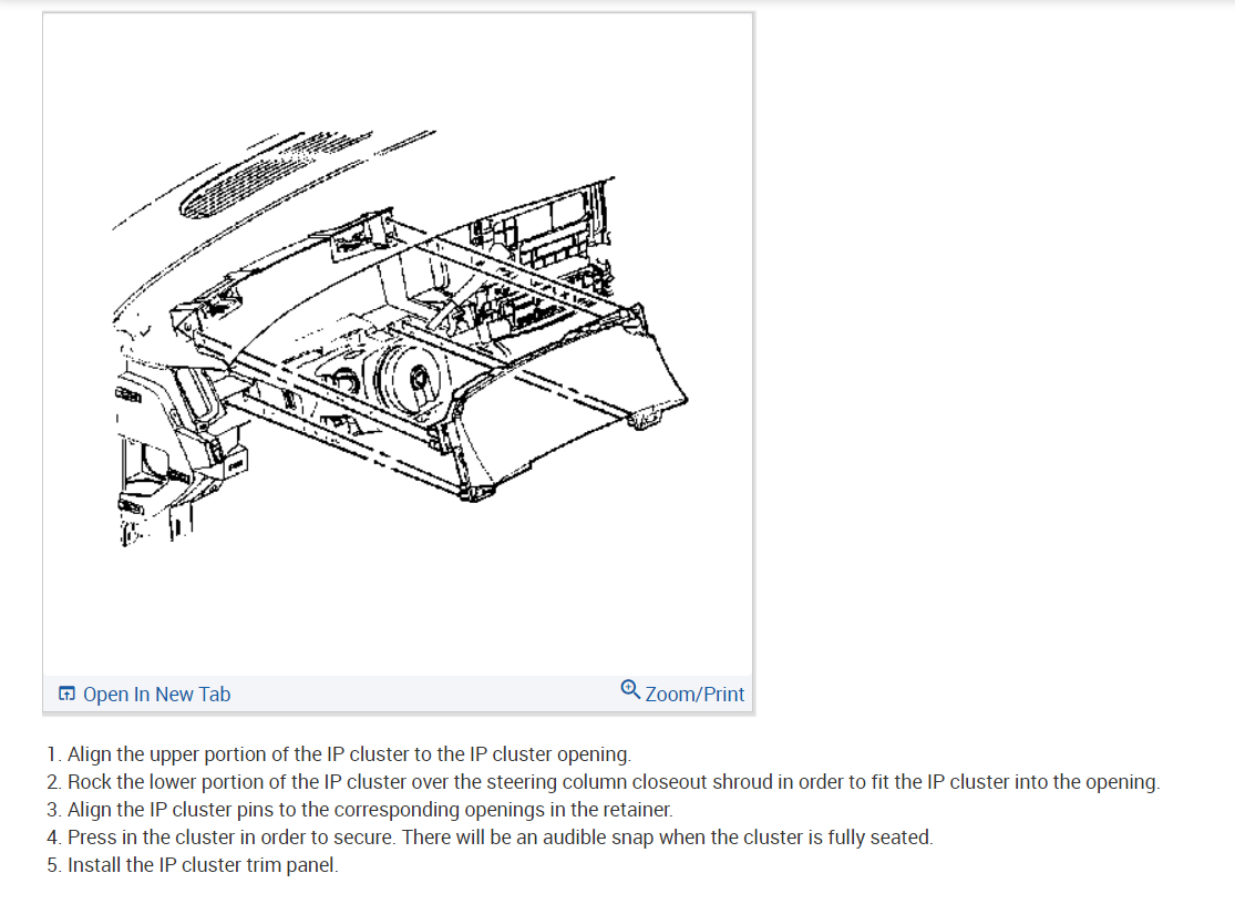

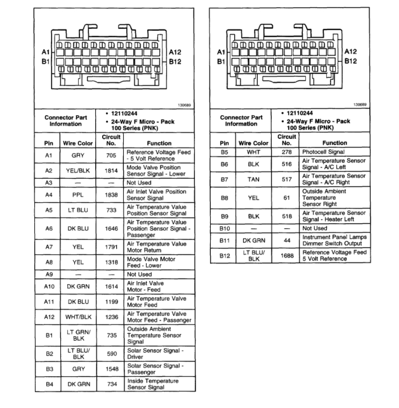

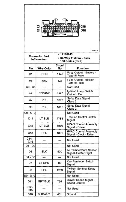

My dashboard warning/info lights are constantly on and changing. Any solutions?
Apr 15, 2021 at 11:30 AM
  • CAR REPAIR CONTRIBUTOR
Hello again.
This could be possibly the cluster itself not processing any information.
I attached the procedure for removing it from the dsh for you below. There are places you can send the cluster to be repaired rather than getting a new unit. You can check with your parts store for that information.
