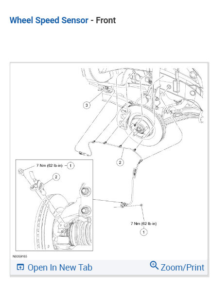

The parking brake light, ABS light, traction light, and a few others. I got it tested at AutoZone and it said one fuse was blown for the parking brake system. The testing said everything else was fine, the battery and alternator tested good. So, would that parking brake fuse cause these other warning lights to come on and stay on? Or is there a bigger electrical problem at work? Any help appreciated.
Sep 11, 2023 at 11:49 AM
  • 55,816 POSTS

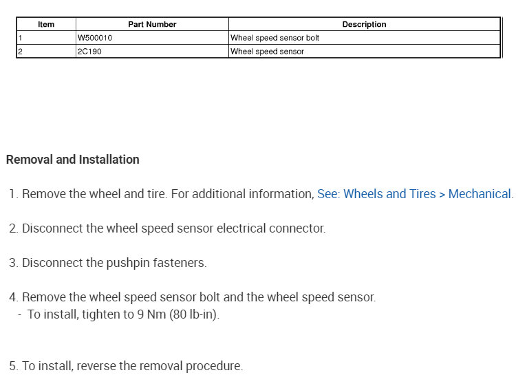

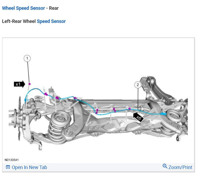

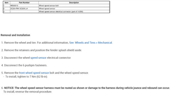

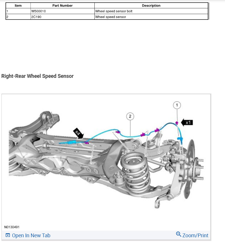

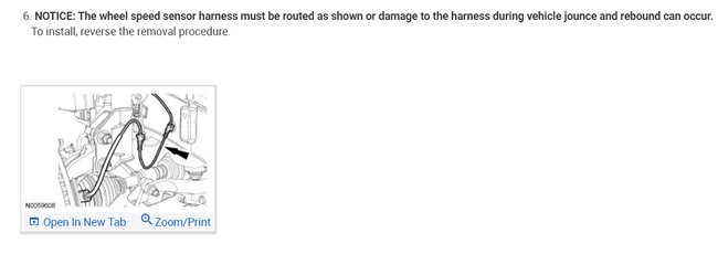

Yep, it sounds like you have a wheel speed sensor that has gone out which will make the warning lights come on that you speak of, we need to do a CAN scan which is different that the scan they do at AutoZone. You can get a CAN scanner (Controller Area Network) which will work on most cars from Amazon.
https://youtu.be/u-4syLc-ifQ
Here is how to change the wheel speed sensors out in case a code comes up for it. Check out the images (below). Please let us know how it goes.
