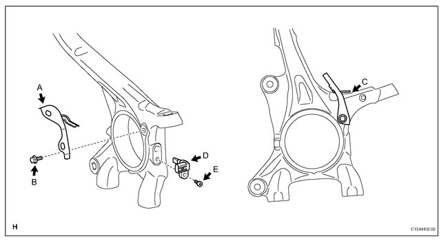

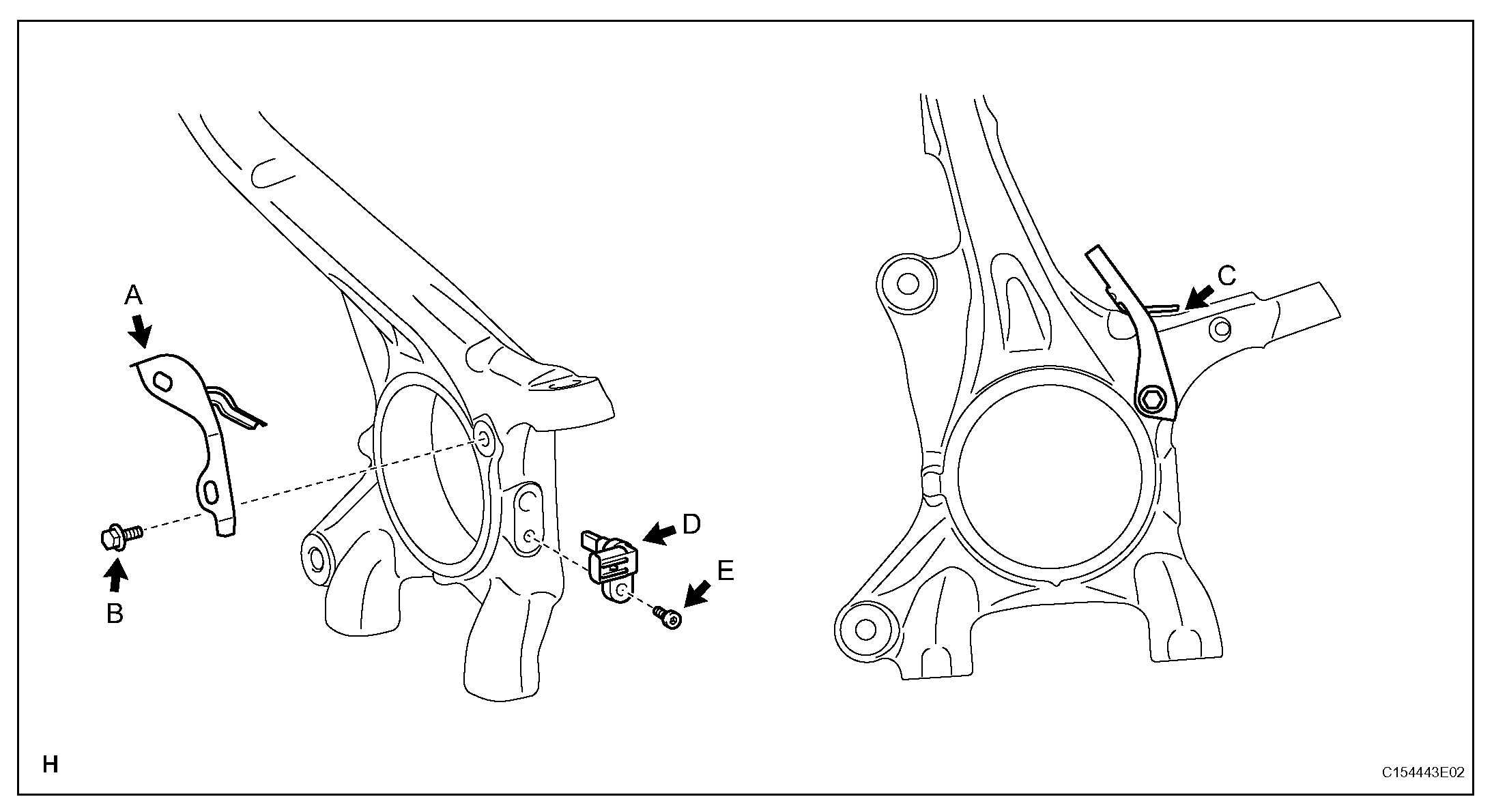

I have the truck listed above Crewmax limited. The VSC light and 4hi lights are flashing and the traction control light and the ABS lights are solid on. I can shut the truck off and they go away but after driving for 10 to 20 minutes they come back on.

Finally was able to get the code. Got a Innova 3100 code scanner for Christmas and the code is C0200, RF wheel speed sensor . Now I just need to see if it is the harness or the sensor. I already bought the left front and right front sensors from what you told me and from what I learned on the web. Hopefully I can get at it today but it's cold outside. Lol

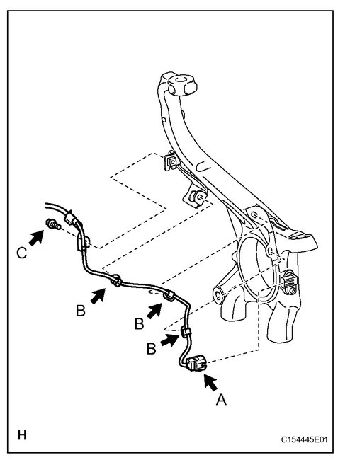

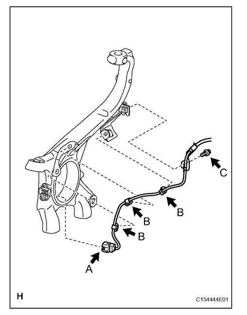

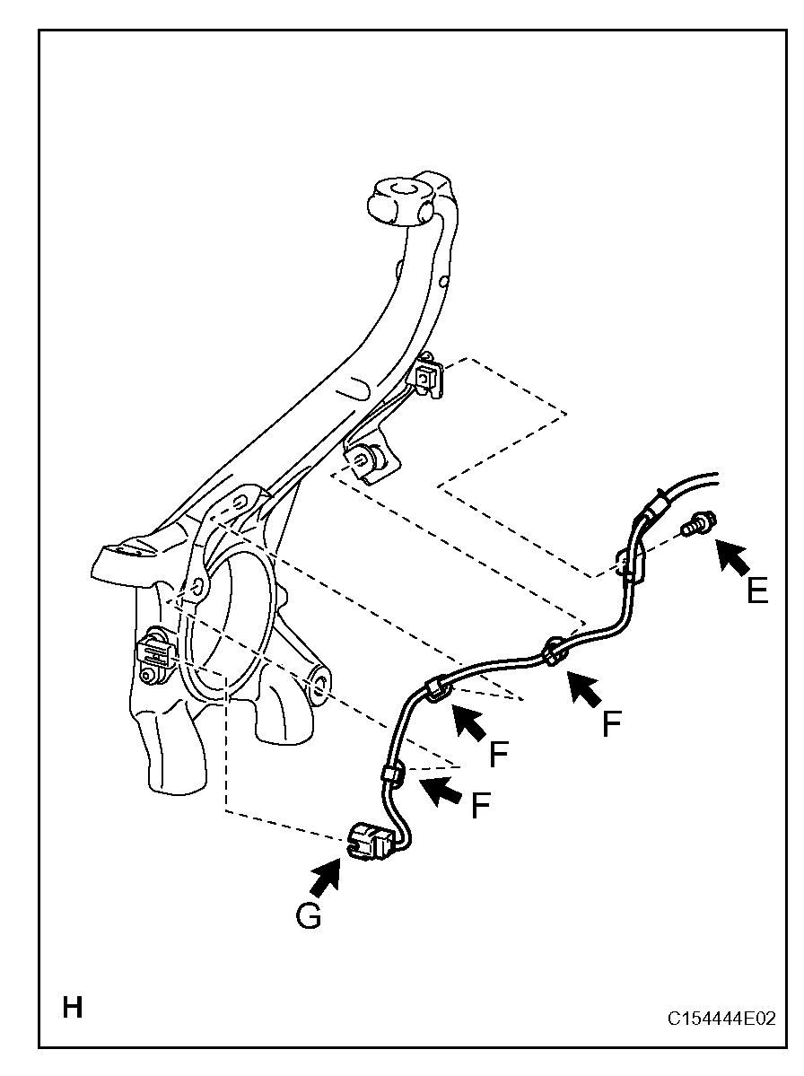

3. REMOVE FRONT SKID CONTROL SENSOR WIRE LH
a. Disconnect the connector (labeled A) from the front speed sensor.
pic 1
b. Detach the 3 clips (labeled B) and remove the clamp bolt (labeled C).
pic 2

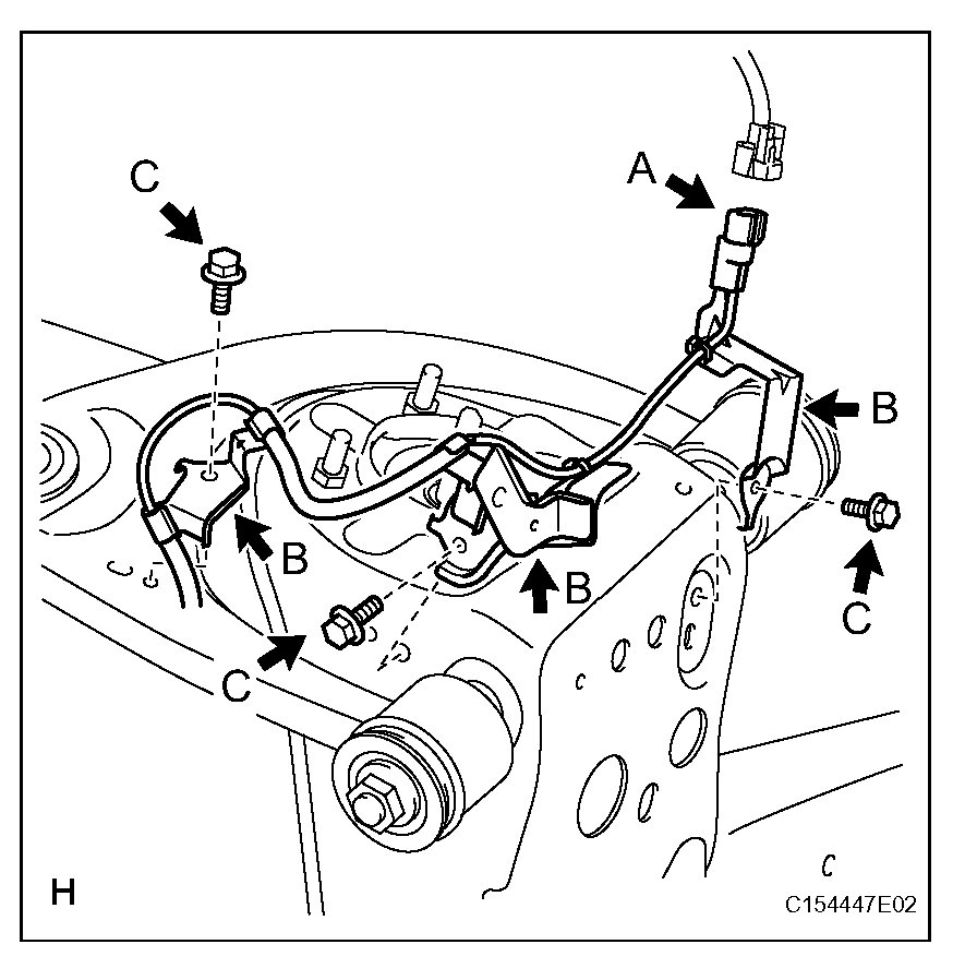

c. Disconnect the connector (labeled D).
d. Remove the 3 bolts (labeled E), 3 harness clamps(labeled F) and sensor wire.

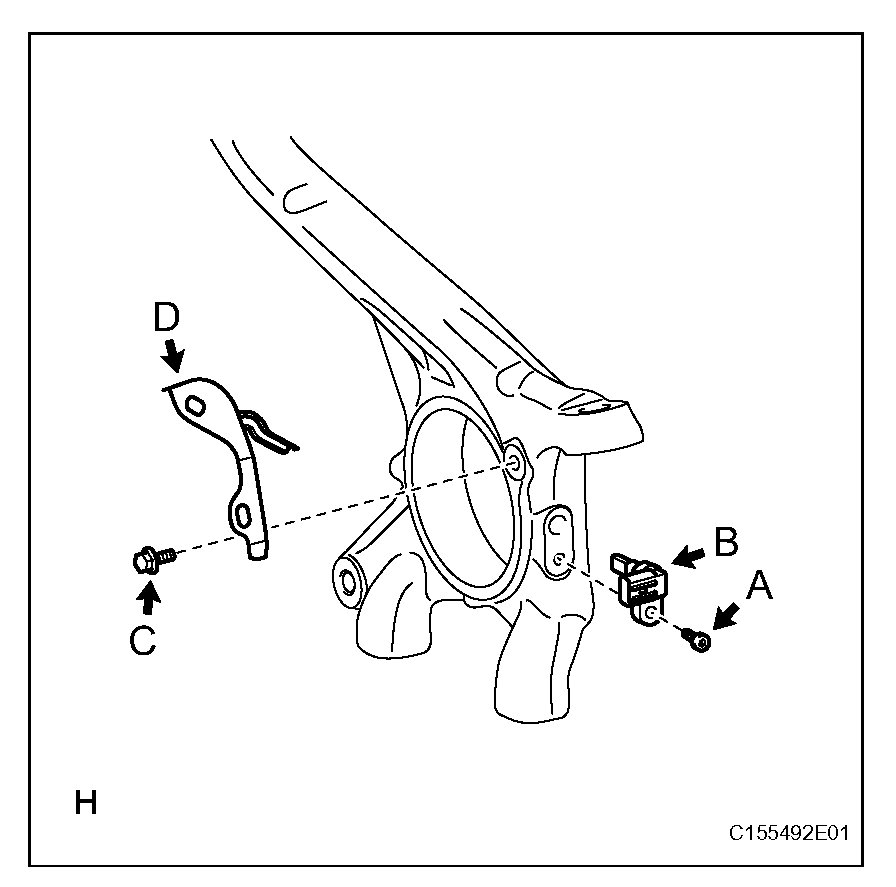

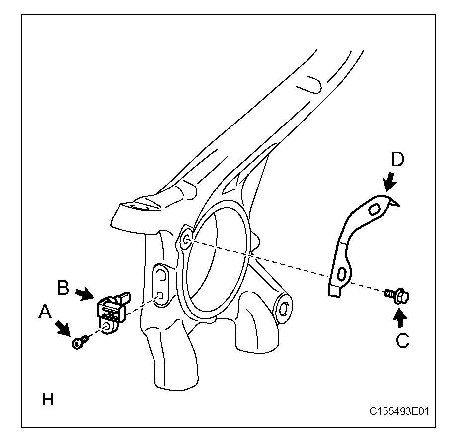

4. REMOVE FRONT SPEED SENSOR LH
pic 3
a. Remove the hexagon socket head cap bolt (labeled A) and speed sensor (labeled B) from the knuckle.
5. REMOVE FRONT SKID CONTROL SENSOR CLAMP LH
a. Remove the bolt (labeled C) and skid control sensor clamp (labeled D) from the knuckle.

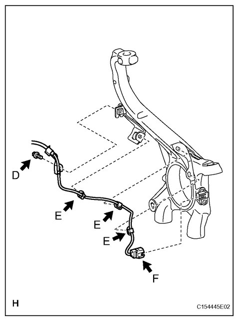

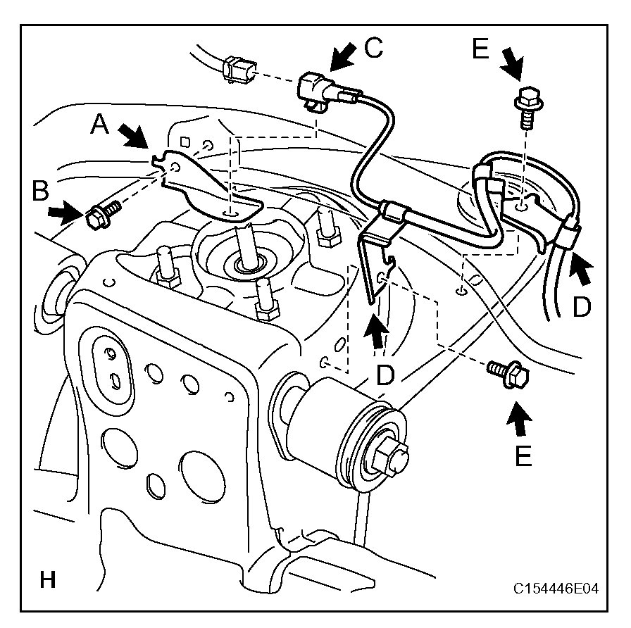

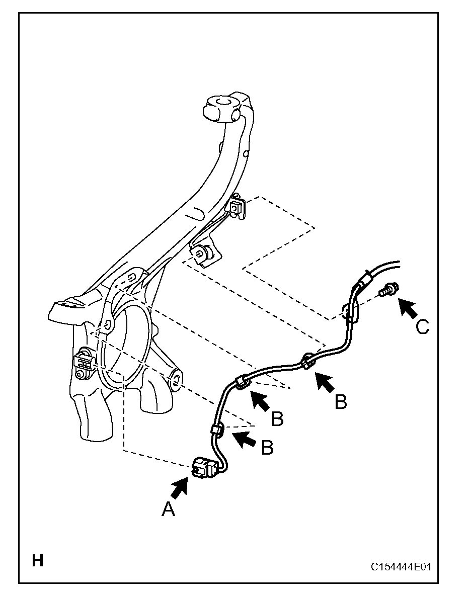

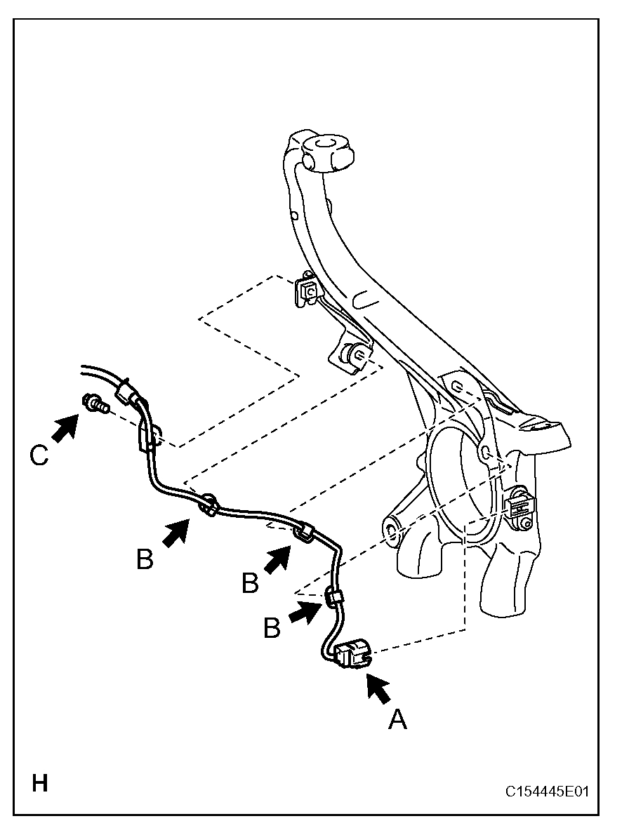

6. REMOVE FRONT SKID CONTROL SENSOR WIRE RH
pic 4

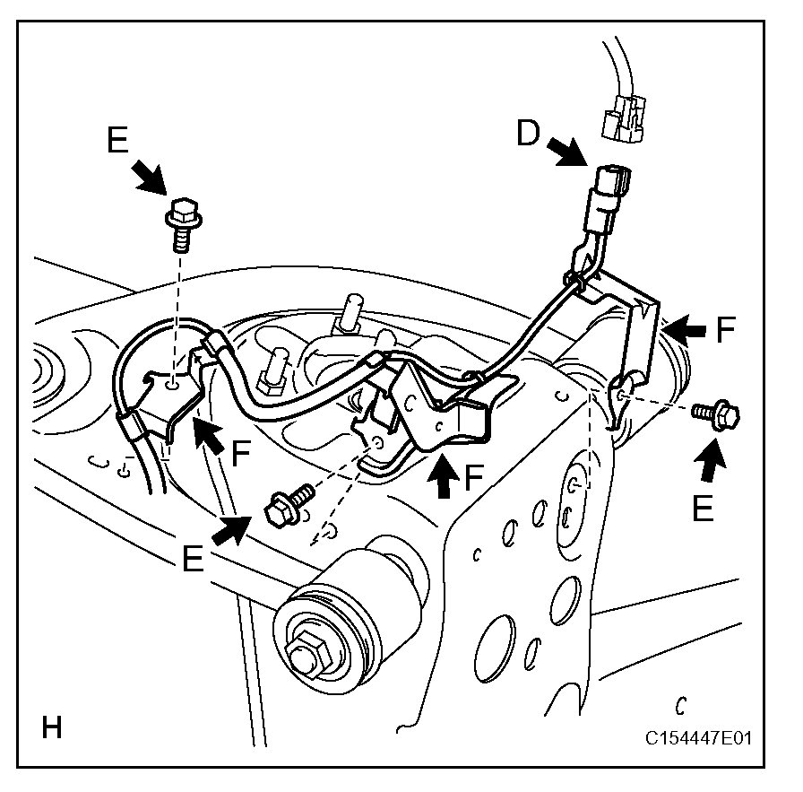

pic 5

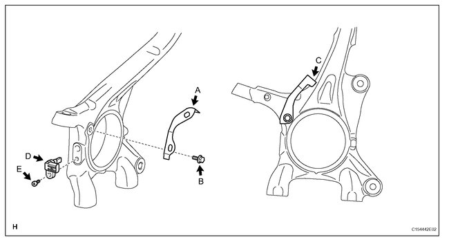

d. Remove the connector (labeled D) from the skid control sensor clamp (labeled H).
e. Remove the 2 bolts (labeled E) and 2 harness clamps (labeled F).
f. Remove the bolt (labeled G) and skid control sensor clamp (labeled H).

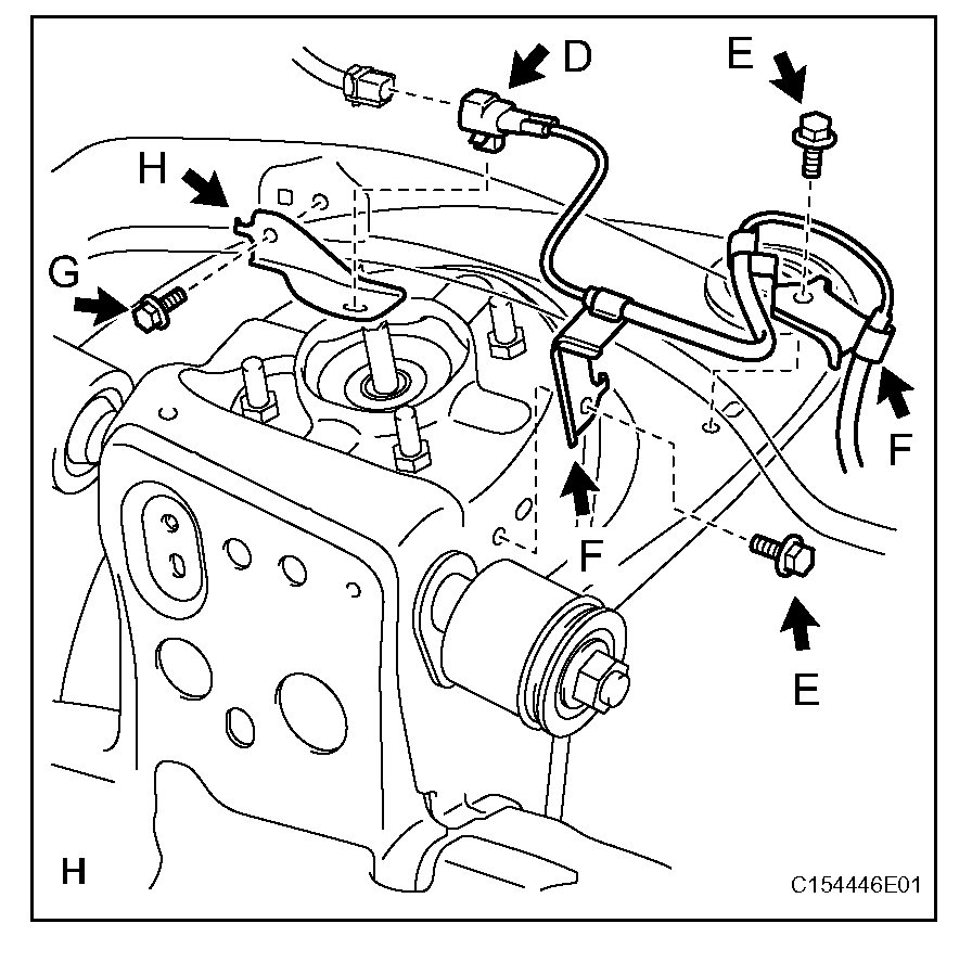

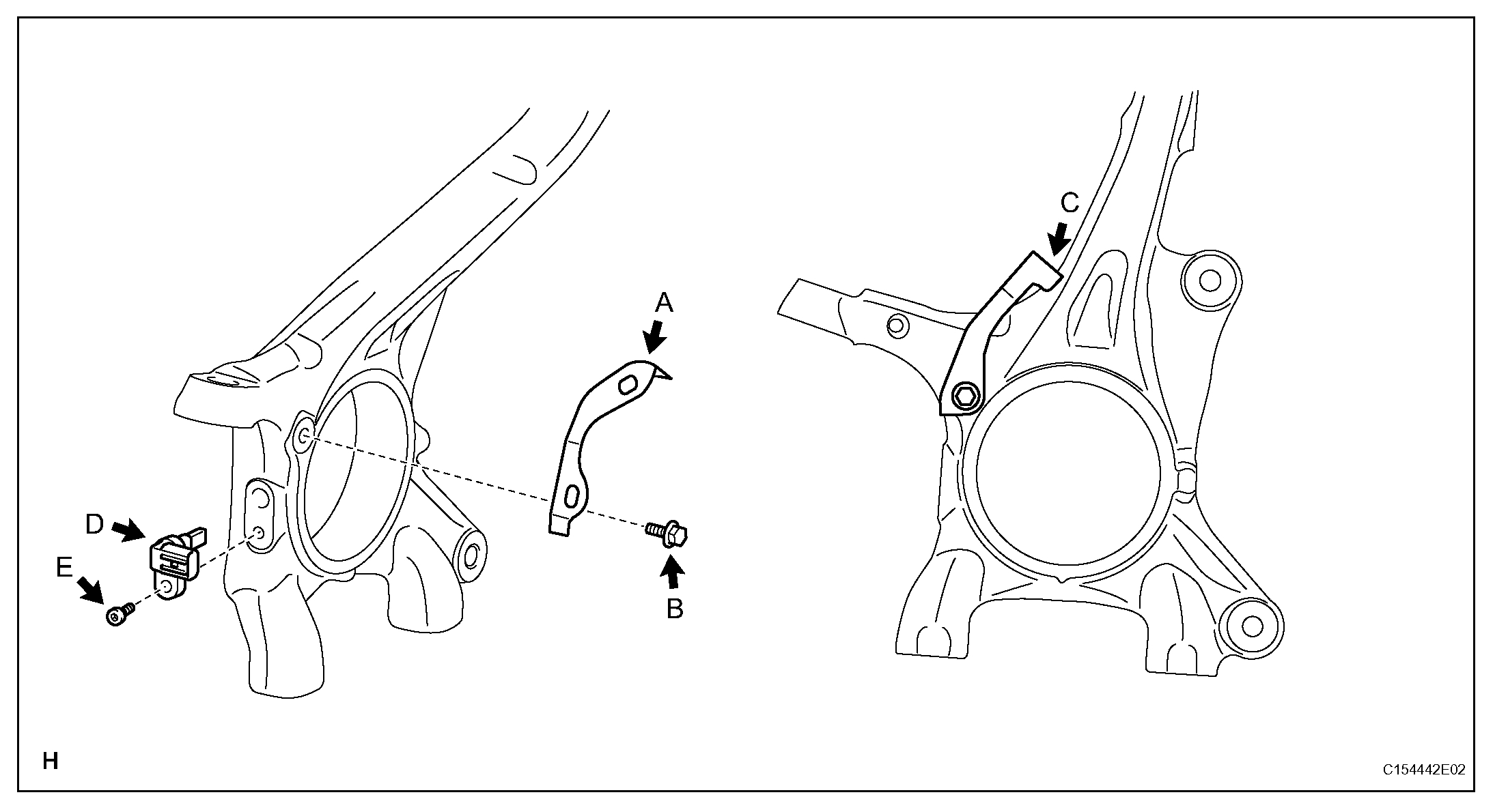

7. REMOVE FRONT SPEED SENSOR RH
pic 6
8. REMOVE FRONT SKID CONTROL SENSOR CLAMP RH

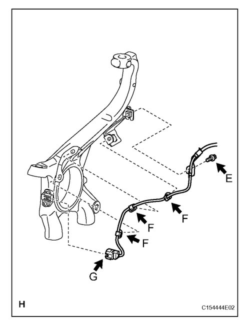

6. INSTALL FRONT SKID CONTROL SENSOR WIRE RH
pic 11
a. Install the skid control sensor clamp (labeled A) with the bolt (labeled B).
Torque: for Bolt B 5.0 N.m (51 kgf. cm, 44 in.lbf)
b. Install the connector (labeled C) with connect the connector (labeled C).
c. Install the 2 harness clamps (labeled D) with the 2 bolts (labeled E).
Torque: for Bolt E 13 N.m (127 kgf.cm, 9 ft.lbf)
