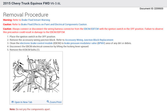

Engine Light, ABS Light, Traction Control Light are on with codes C0550-00 and B0423-05?
2015 HOLDEN CAPTIVA
120,000 MILES • 2.2L • 4 CYL • TURBO • 4WD • AUTOMATIC
MILES EVELEIGH
Engine Light, ABS Light, Traction Control Light.
Fault Codes
C0550-00 Electronic Control Unit
B0423-05 Right Temperature Control Feedback Circuit - High Voltage/Open
Any information would be greatly appreciated.

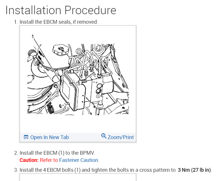

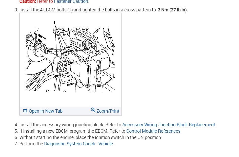

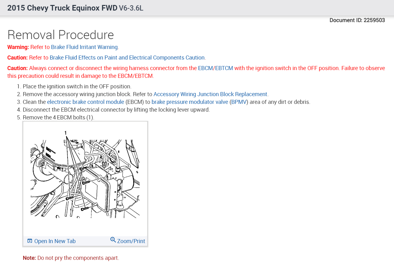

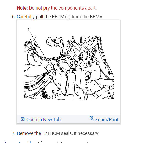

Yep, here is the code definition - C0550 is an internal malfunction in the ABS/traction control module. Here is the location of the ABS module and how to replace it in the images below. Please start a new thread for the one that has to do with the HVAC system, and we only handle one problem per thread. Check out the images (below). Please let us know if you need anything else to get the problem fixed.
