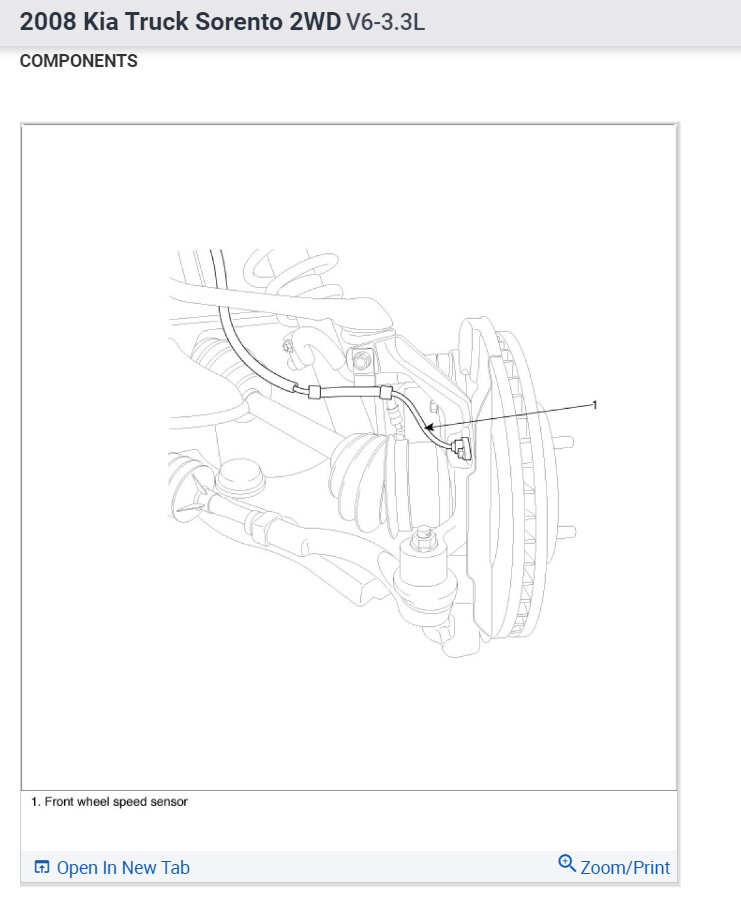

Replaced upper A arm on right side with ball joint when started it ABS AND ESC lights stay on?

Yes, chances are this means the wheel speed sensor is not connected to the wiring harness, I would double check your work to make sure the connector is plugged in. Here is the sensor location so you can see what I am talking about. Check out the images (below). Please let us know how it goes
