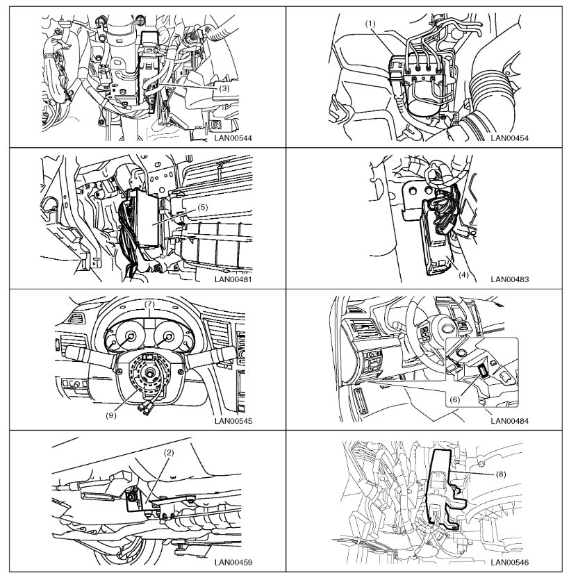

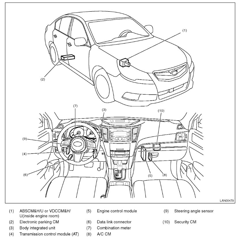

Hello again.
I've attached a picture below. Can you tell me which model?
Need to know if all wheel drive etc. Get back to me when you can and I will share repair information. Hope this helps and thanks again for using 2CarPros.

Hello, I am not sure about the exact model. I don't have my title as of yet. It is AWD. Automatic. 2.5L. four cylinder. What else can I do to help diagnose? Thanks, MLS69

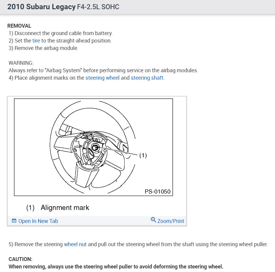

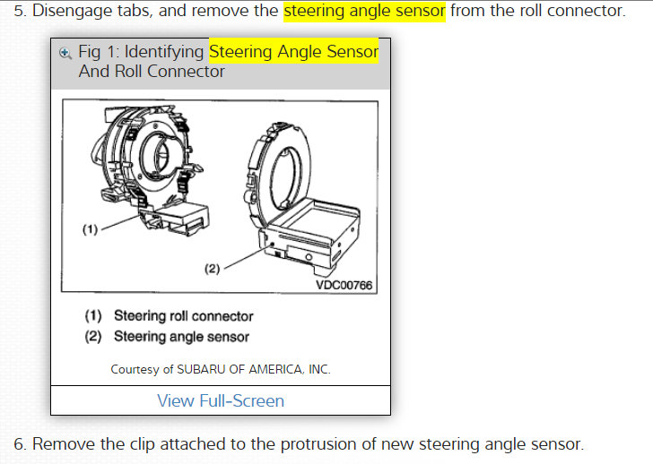

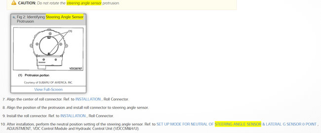

The C0071 code is telling us the steering angle sensor has gone out which can cause the problems your are having. here is the information on changing it out:
Parts Information OEM Part Price Steering Angle Sensor
Position Sensor 27589AJ000 $359.70 HRS - 1.3
Clear the codes once complete this video will show you how.
https://youtu.be/rTtAnsOlZU4
