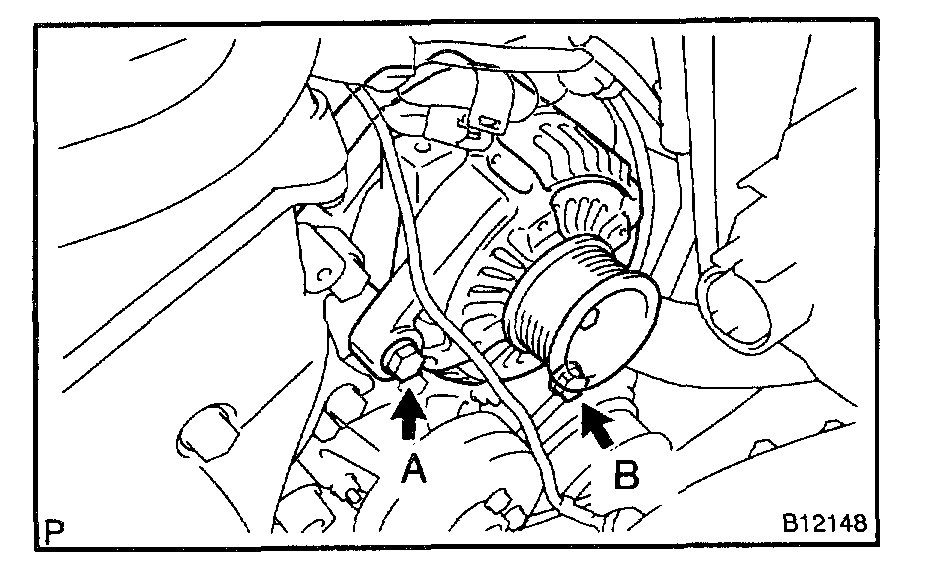

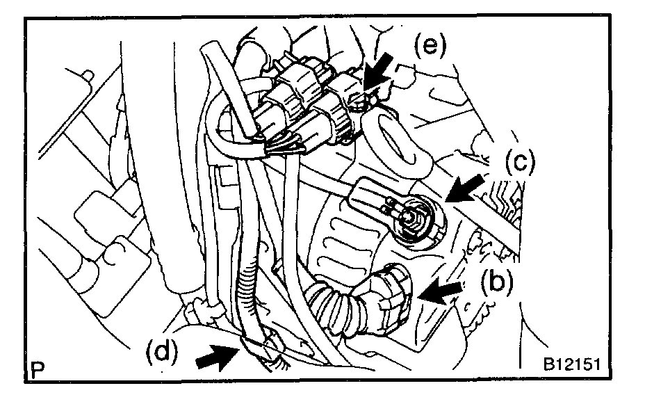

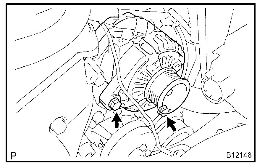

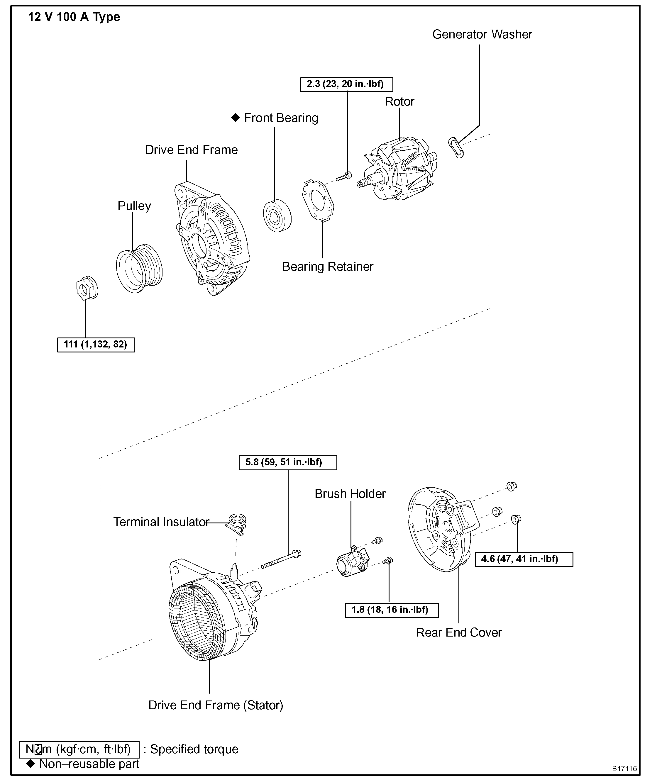

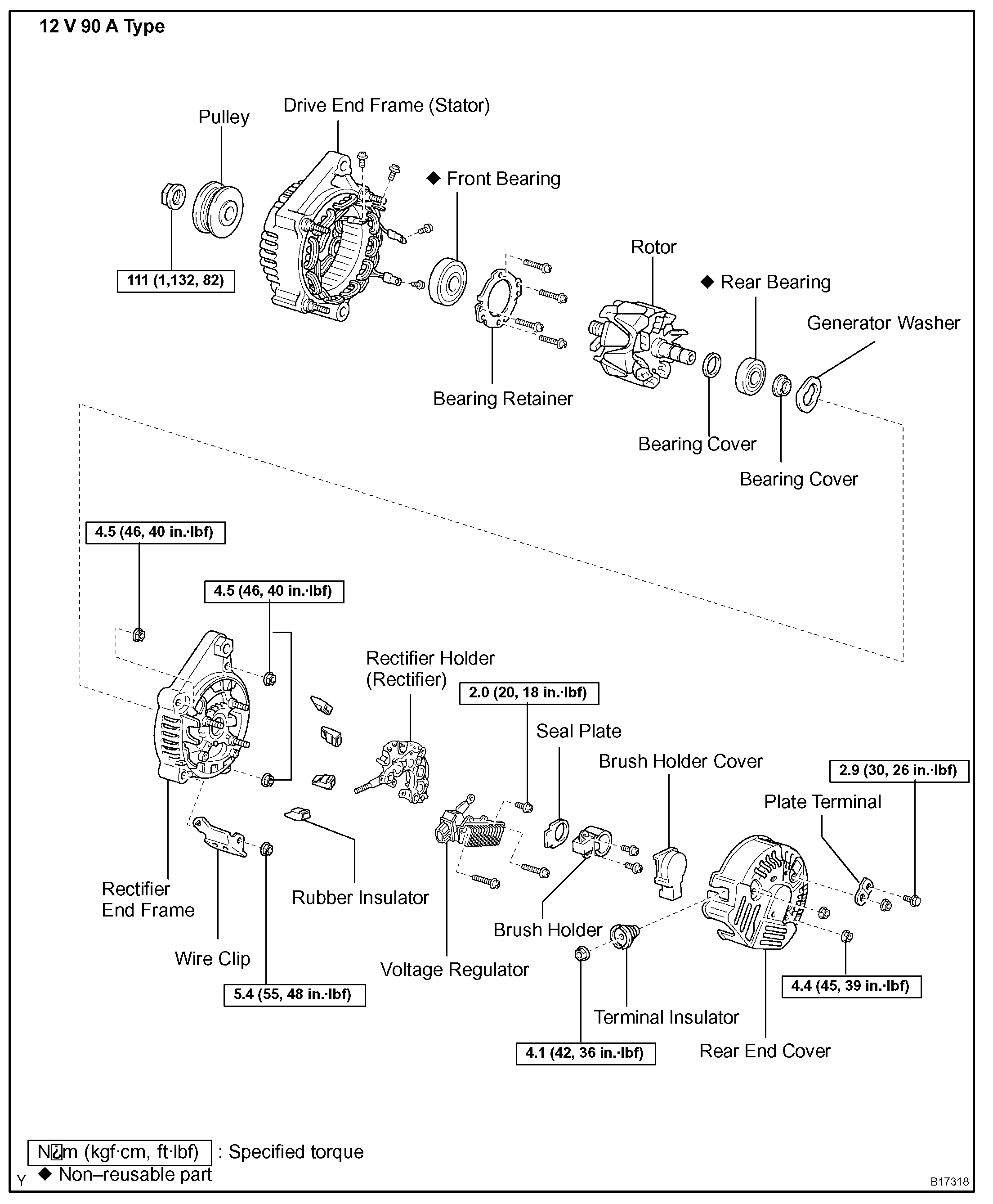

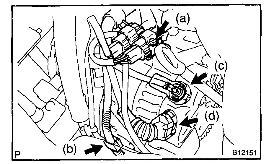

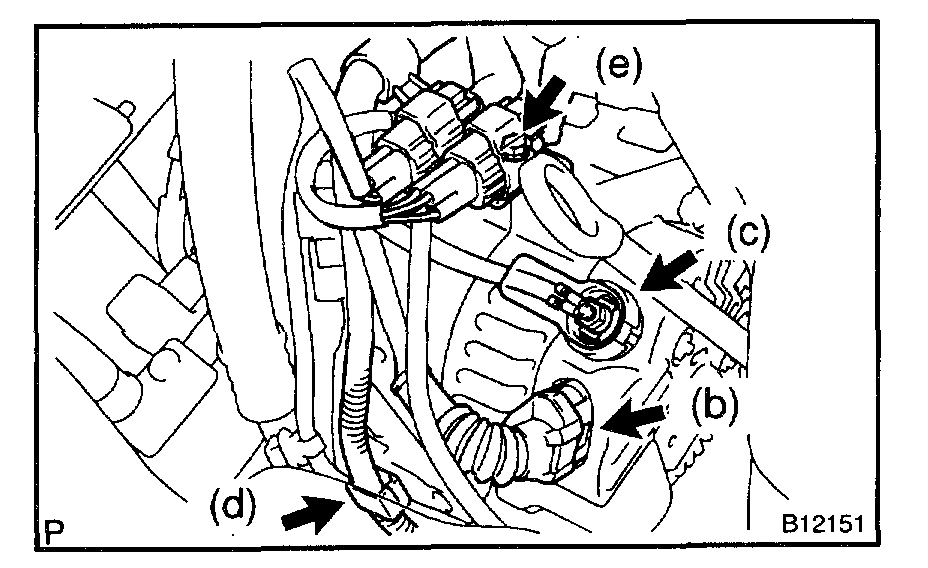

Here are the directions specific to your vehicle for replacing the alt. The attached pictures correlate with the directions.
______________________________________
REMOVAL AND INSTALLATION
Charging System
Pic 1
12V 90A Type Generator
Pic 2
12V 100A Type Generator
Pic 3

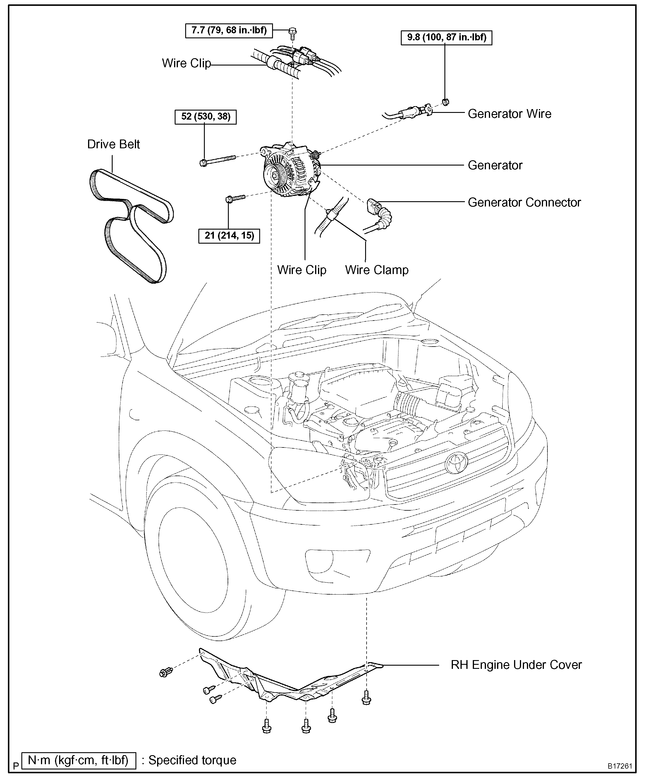

REMOVAL
Pic 4

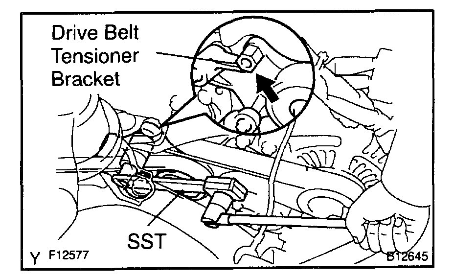

1. REMOVE DRIVE BELT
Hook SST on the hexagonal portion of the drive belt tensioner bracket, compress the drive belt tension by turning the drive belt tensioner bracket clockwise, and remove the drive belt.
SST 09249-63010
NOTE: Compress the drive belt tensioner by taking 3 seconds or more and remove the drive belt.

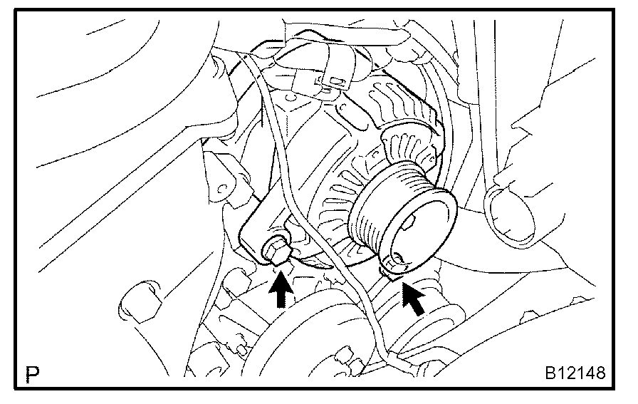

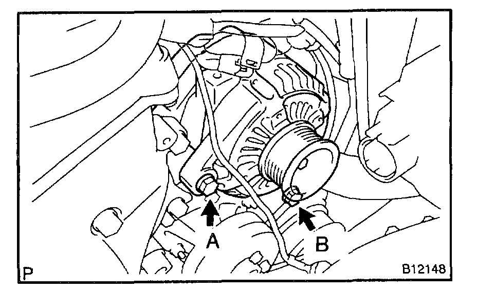

2. REMOVE GENERATOR
pic 5
a. Remove the bolt, and disconnect the wire clip on the wire connectors from the generator.
b. Disconnect the wire clamp from the wire clip.
c. Remove the cap and nut, and disconnect the generator wire.
d. Disconnect the generator connector.
pic 6
e. Remove the 2 bolts and generator.
