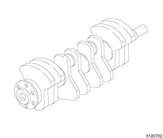

As far as a crankshaft, that is an internal engine component at the bottom of the engine. It is the backbone of the engine. The piston connecting rods connect to it. I attached a picture of one from a Fiat 500. It is a generic picture, but it gives you a general idea.
Based on what you said, I feel you are referring to the crankshaft position sensor. That is an ignition component and is not part of the transmission/gear box.
Regardless, if nothing happens when she turns the key, then that narrows things down quite a bit. A starter going bad, a bad starter relay, or as you mentioned, a loose or corroded battery connection or engine ground can act this way. Here are the specific links for the items I mentioned:
