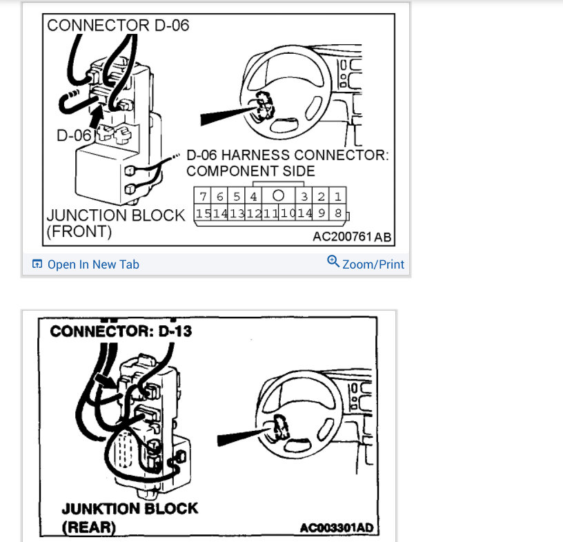

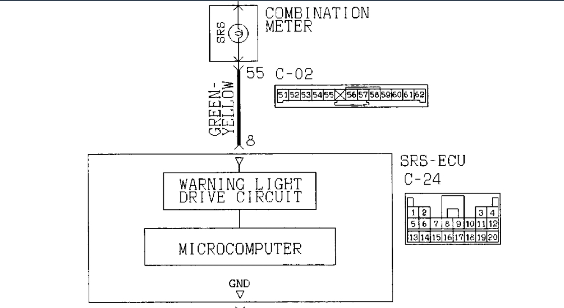

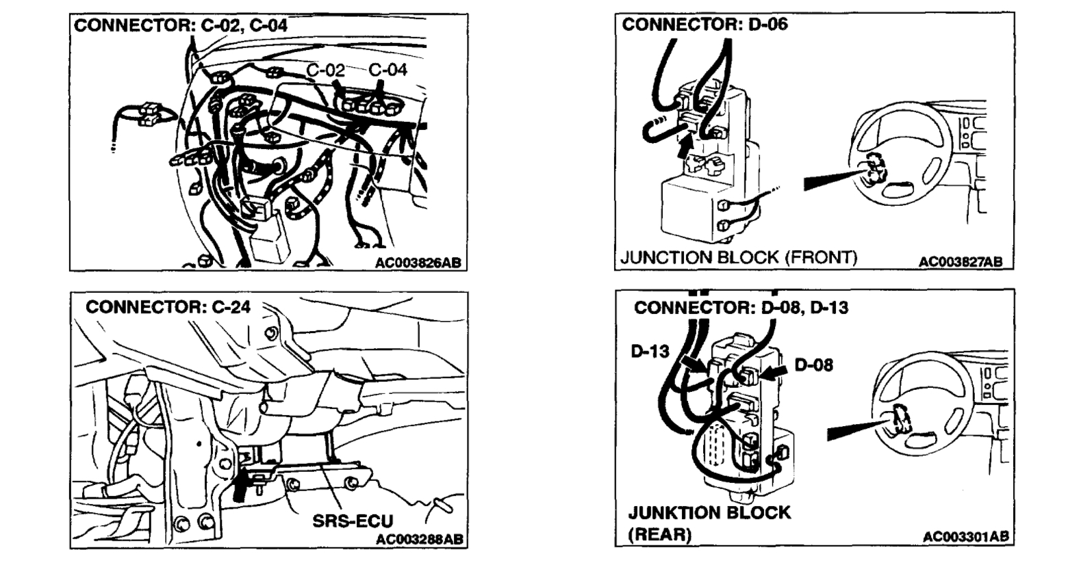

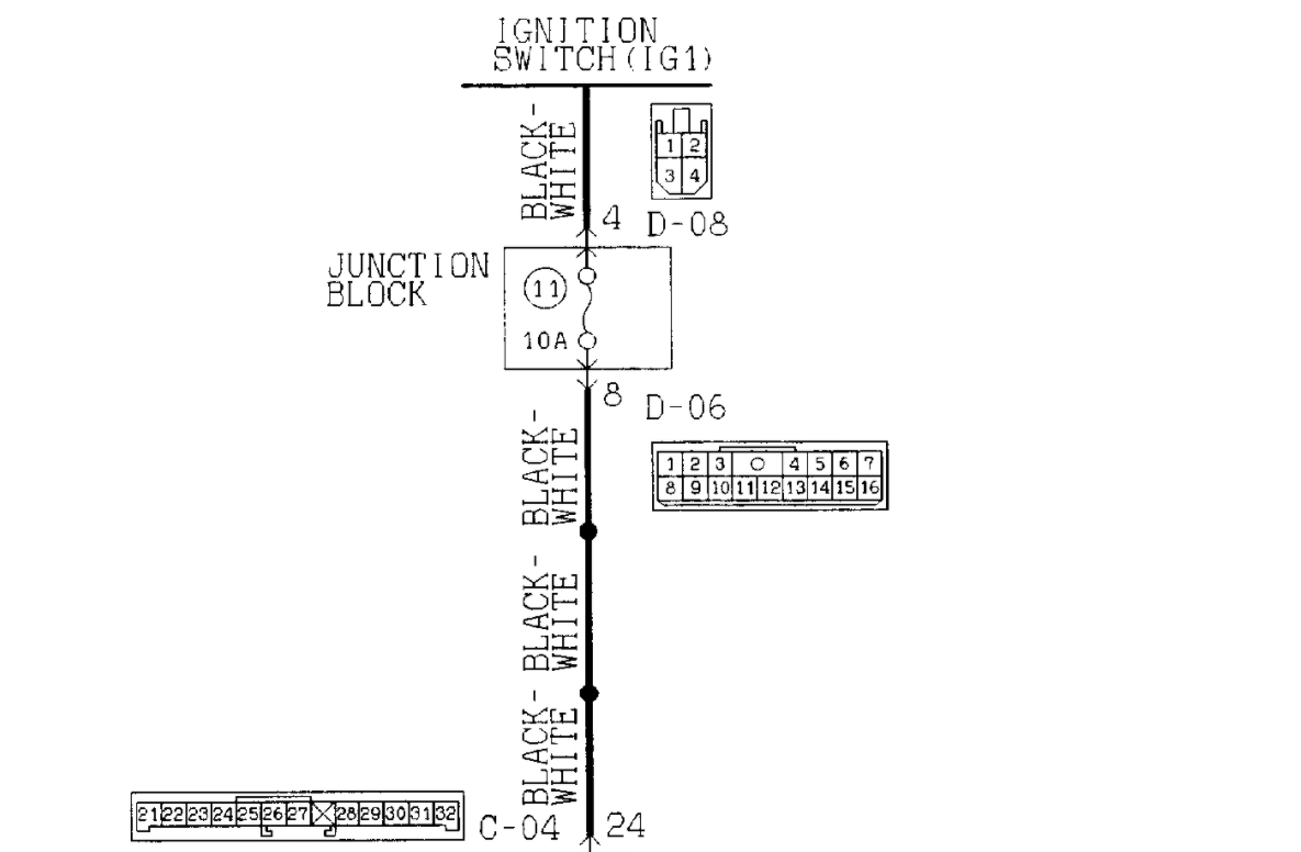

SRS engine warning light on.
Jan 3, 2020 at 6:27 PM
SCGRANTURISMO
  • 4,897 POSTS

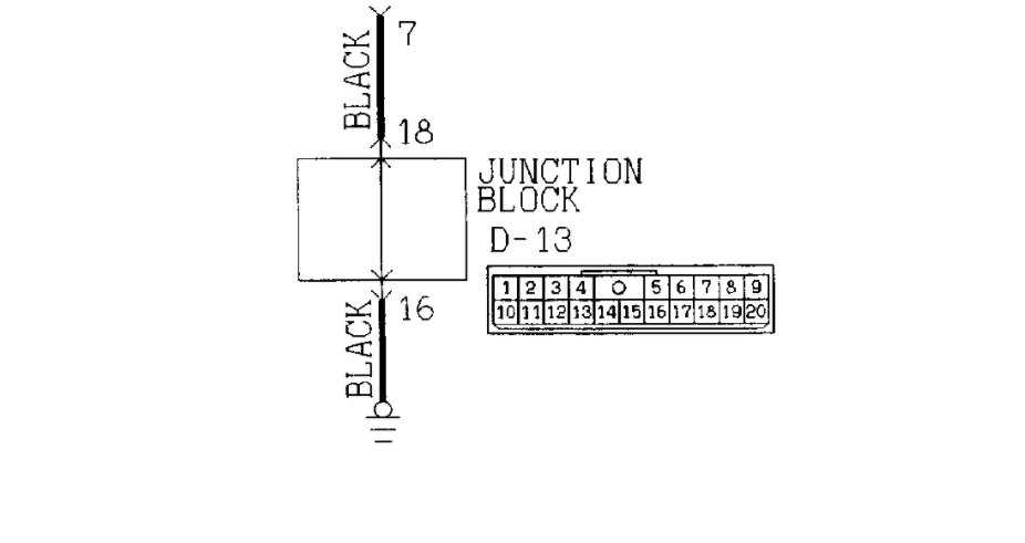

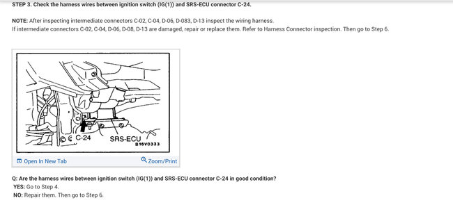

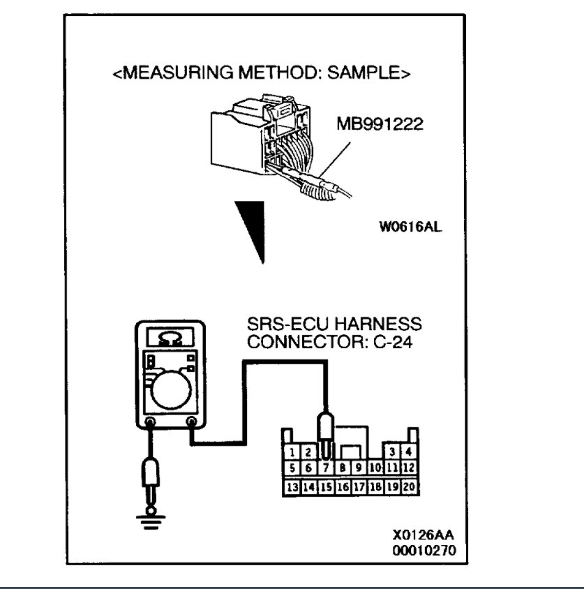

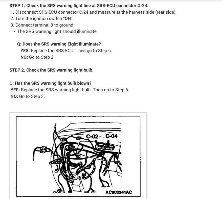

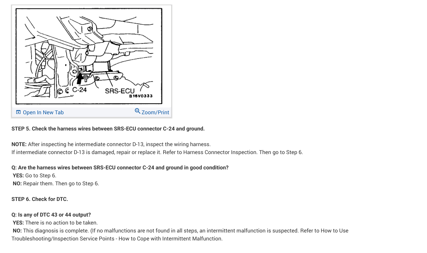

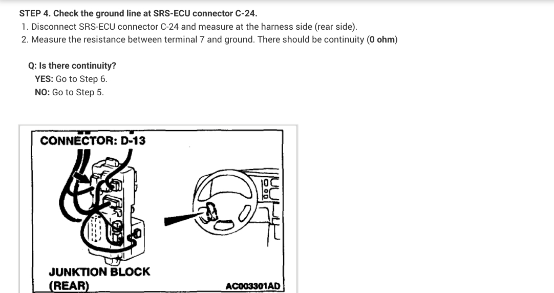

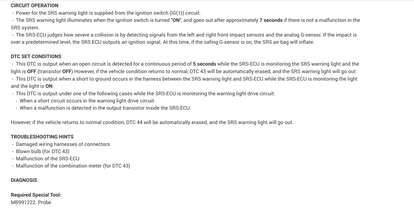

In the diagrams down below I have included the diagnostic troubleshooting guide for Direct Trouble Code[DTC] 43 which is the DTC that you are guided to if the SRS warning light stays illuminated after the seven second bulb check at startup has completed. Please carefully read this guide as you go through it and report back with your findings, please.
Thanks,
Alex
