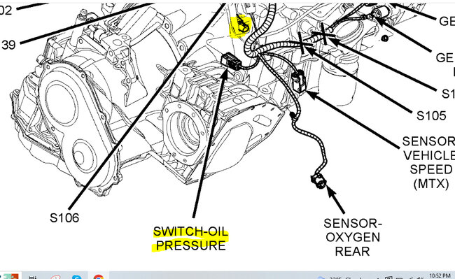

Oil warning light turned on flashing red and beeping?
2008 CHRYSLER PT CRUISER
120,000 MILES • 1.7L • 4 CYL • 2WD • AUTOMATIC
LYNDALU07
My oil light came on flashing red and beeping. Oil is full, radiator coolant okay.
Jan 29, 2024 at 9:16 AM
  • 110,244 POSTS
I need confirmation on the engine size. I believe it is a 2.4L. Please confirm.
Also, when the light turned on, did you notice any knocking or ticking from the engine, or did it continue to run the same?
If there were no noises, chances are it is related to the oil pressure sensor or a wire/connector issue. The sensor is on the side of the engine close to the engine oil filter. See pic 1. Check to see if the connector is not damaged or loose. Also, confirm the wiring isn't damaged.
Additionally, disconnect the electrical connector and check to see if there is oil in the connector itself. Often when the sensor fails, it allows oil to leak through the sensor.
See pic below.
