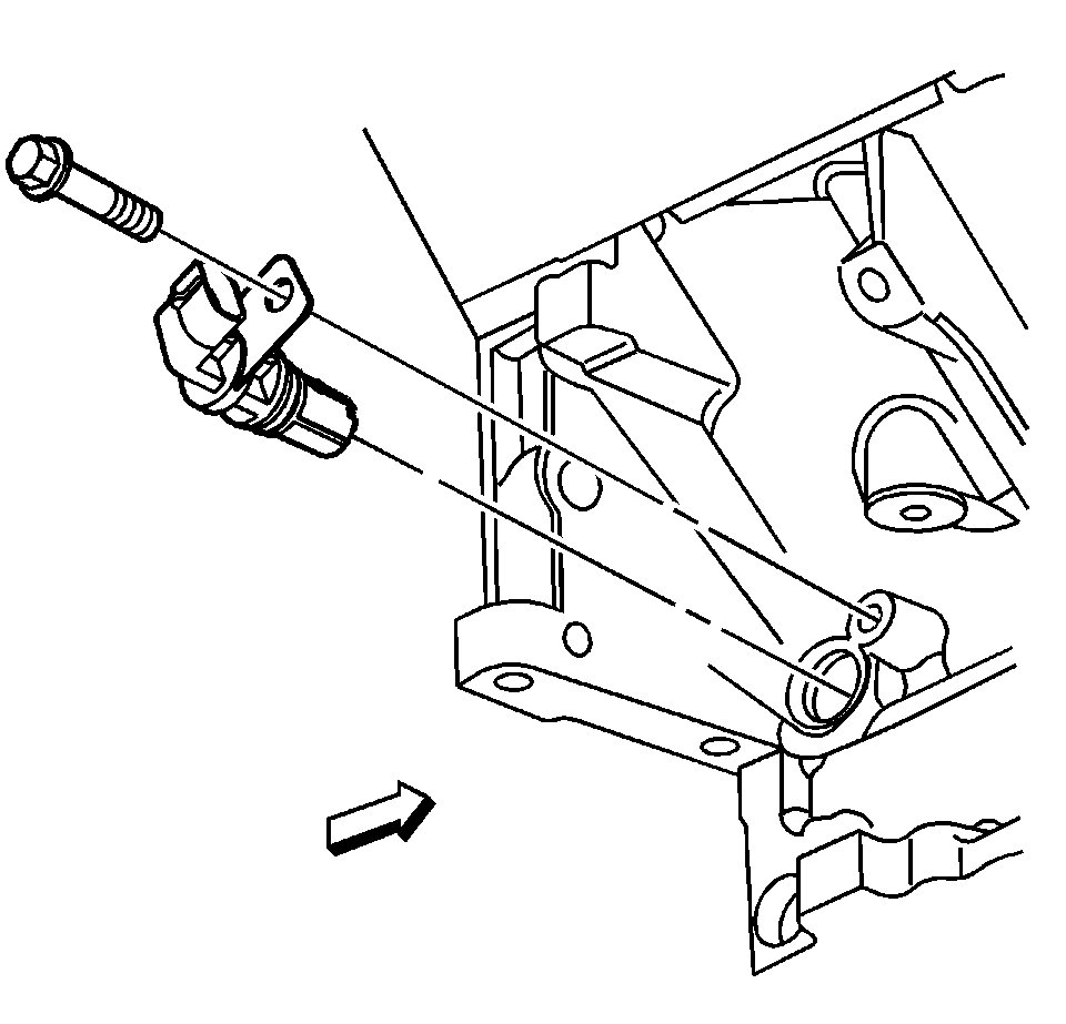

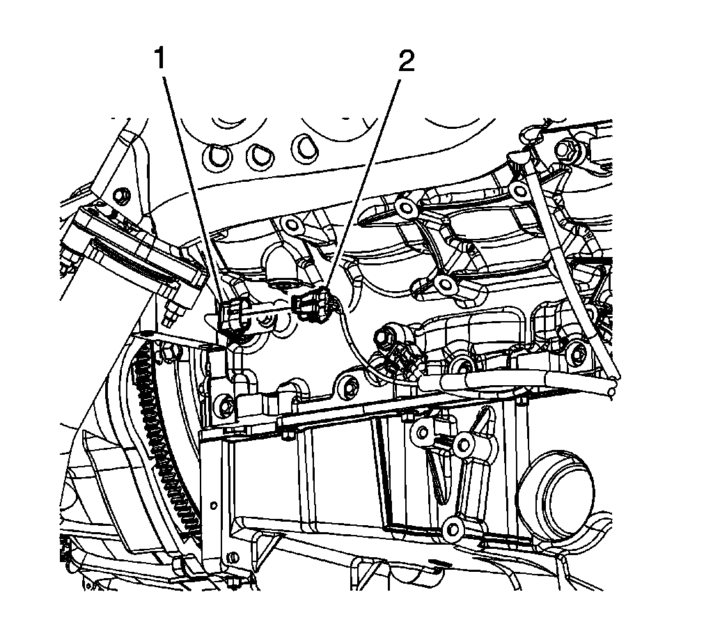

Engine shuts off after about twenty minutes once it gets warm. No spark to plugs at that point. Once engine cools down it will restart. Changed the ECU and it still does the same thing.

Honestly, it sounds like a bad crankshaft position sensor. When they are bad and get hot, internally they lose connection. Thus, no spark. Take a look through this link:
Here are general directions for replacement:
If you determine this is the problem, here are the directions for sensor replacement specific to your vehicle. All attached pictures correlate with these directions.

CRANKSHAFT POSITION SENSOR REPLACEMENT
CRANKSHAFT POSITION (CKP) SENSOR REPLACEMENT
Disconnect The Battery Prior To Removal
REMOVAL PROCEDURE
1. Remove the starter.
IMPORTANT: Perform CKP System Variation Learn Procedure whenever the crankshaft position (CKP) sensor is removed or replaced.
2. Disconnect the electrical connector (2) from the CKP sensor (1).
3. Clean the area around the CKP sensor before removal in order to avoid debris from entering the engine.
4. Remove the CKP sensor bolt.
5. Remove the CKP sensor.
INSTALLATION PROCEDURE
1. Install the CKP sensor.
2. Install the CKP sensor bolt.
NOTE: Refer to Fastener Notice in Service Precautions.
Tighten the bolt to 25 N.m (18 lb ft).
3. Connect the electrical connector (2) to the CKP sensor (1).
4. Install the starter.
