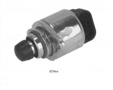

Well If you have problems just at idle ...
How about the IAC (Idle Air Control Valve)
That`s a common problem on idle issues....
http://www.2carpros.com/forum/automotive_pictures/576_IAC_valve_Pic_1.jpg
Make sure that valve its clean and working properly ..
Also well adjusted..
Then you can clean the injectors (you have to use an approved injector cleaner from chevy)
I don`t think that`s an internal problem.. it`s a fuel control problem...
let Us Know on your findings..
