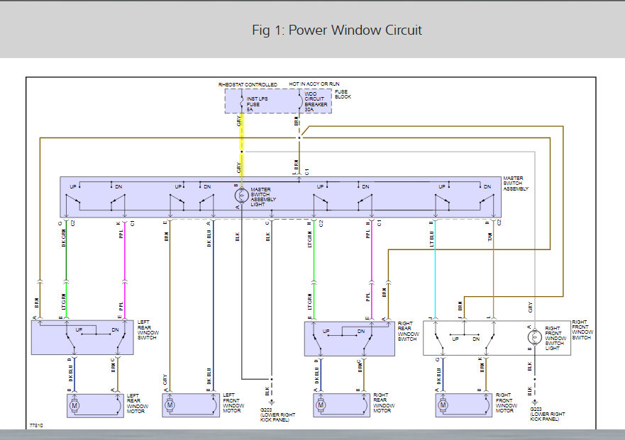

Hot wire to master window switch.
Tuesday, May 21st, 2019 AT 7:58 AM
SCGRANTURISMO
  • 4,897 POSTS
I have included in the diagrams down below a wiring diagram of your power window circuit. The wire providing power to the master window switch has been hilighted for you. Please get back to us with how everything turns out.
