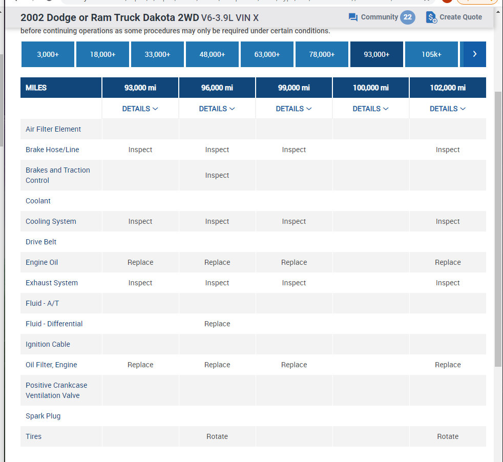

What maintenance should I perform at this mileage? It is running well right now, and I would like to do my best to keep it that way. It has been regularly maintained.
May 11, 2013 at 12:39 PM

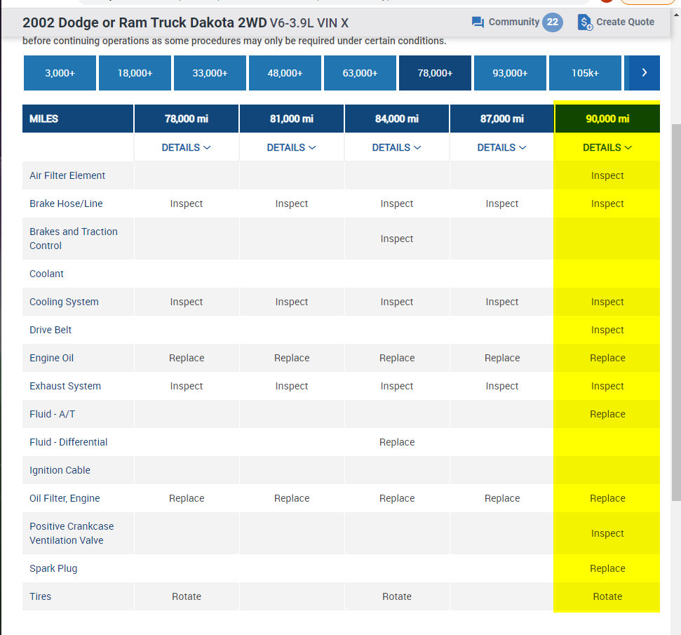

You need to do what is called a 90,000 mile service if you have not done this. Then you can do what is required at 95,000 miles.
I attached the info below but here are some guides that will help with performing the needed services.
Here are the guides that you need for the 90,000 service:
https://www.2carpros.com/articles/how-to-tune-up-a-car-engine
https://www.2carpros.com/articles/how-to-change-engine-oil-and-filter

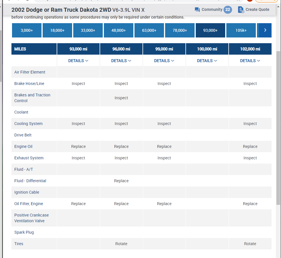

Here are the guides that you need in addition to that for the 95,000 service:
https://www.2carpros.com/articles/differential-service
Please see the info below on the maintenance tables. Thanks
