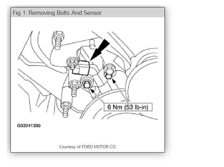

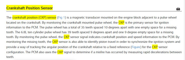

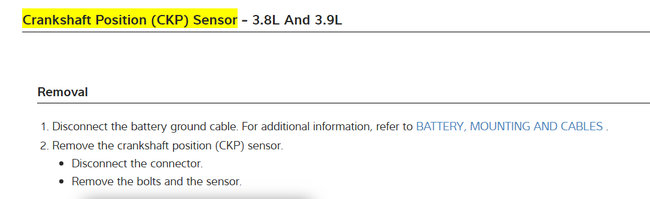

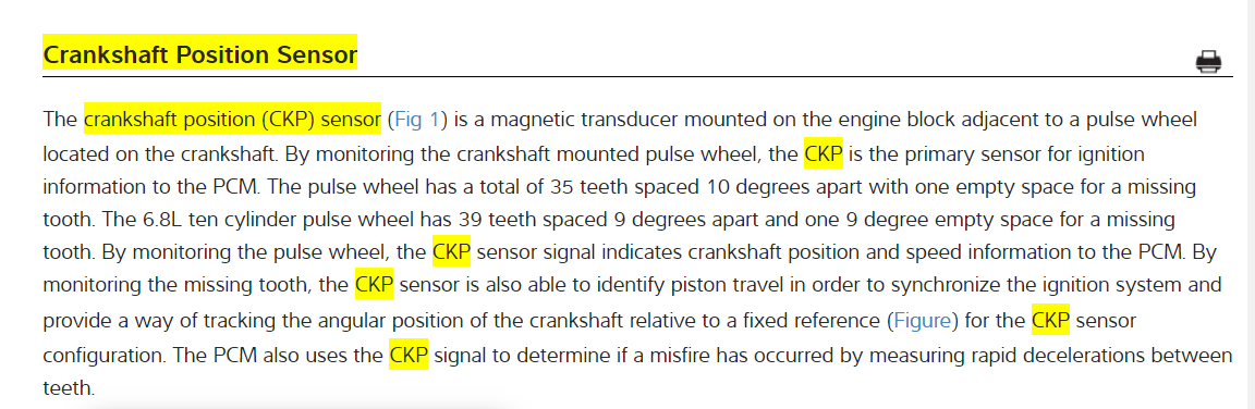

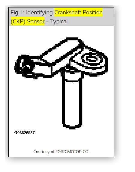

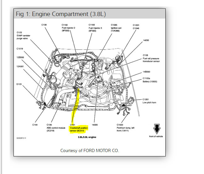

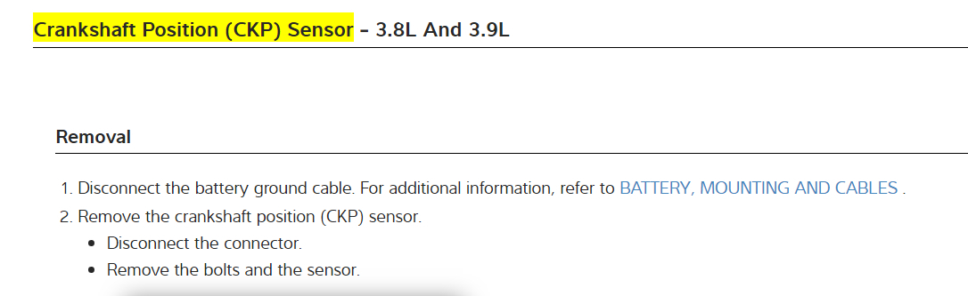

Okay, this could be a problem with your vehicle's Crankshaft Position Sensor(CKP). The Power-train Control Module (PCM) on your vehicle uses the CKP sensors input to know when to fire the coil pack and the fuel injectors. Without this signal reaching the PCM your vehicle will not start or run. In the diagrams down below I have included the description, location, and removal instructions for your vehicle's CKP sensor. Installation is the reverse of removal. Please go through these guides and get back to us with what you are able to find out.
Thanks,
Alex

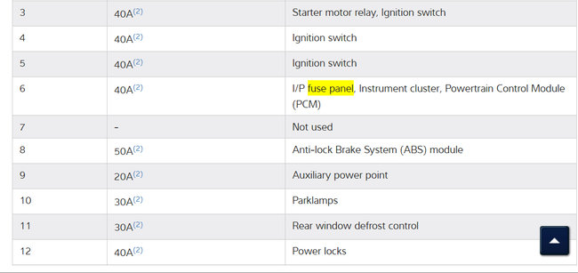

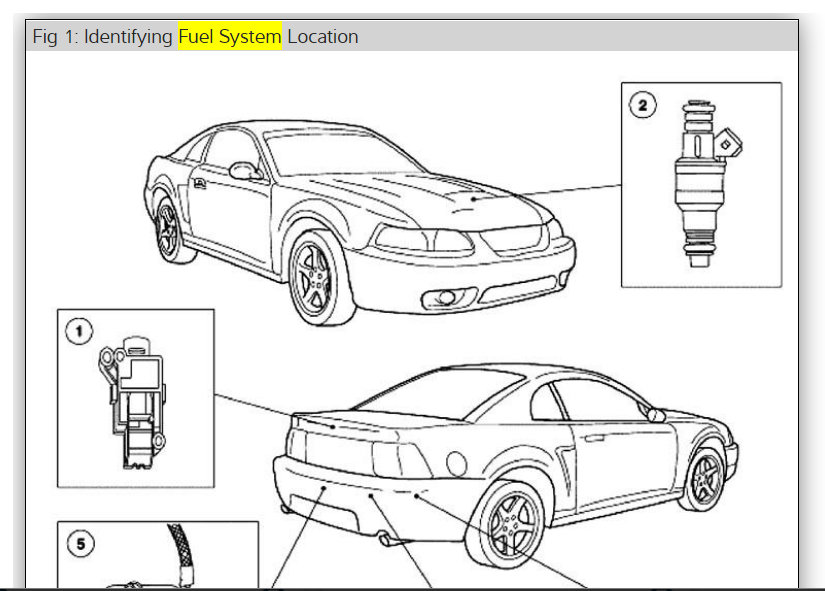

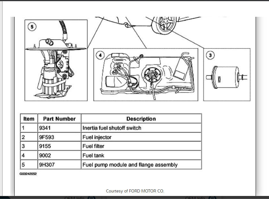

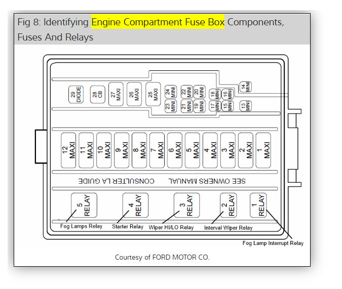

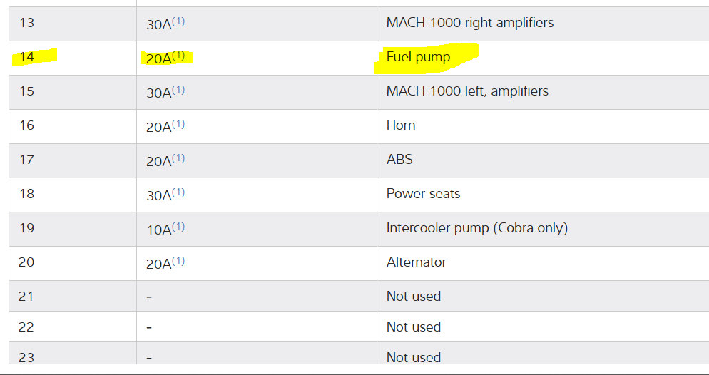

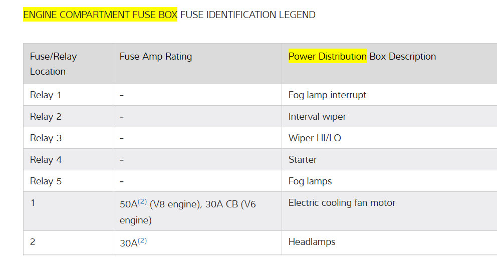

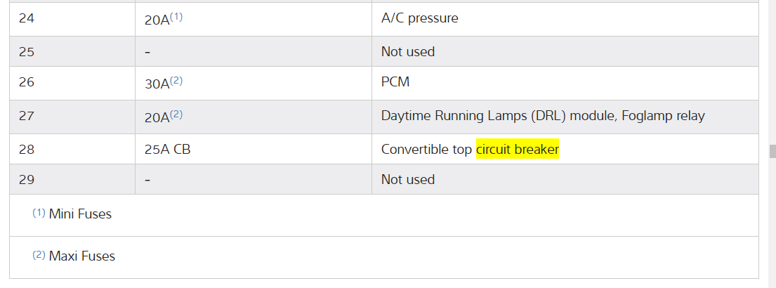

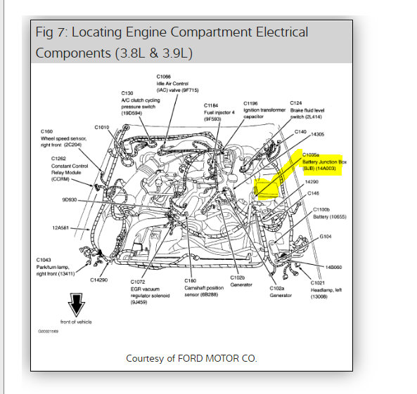

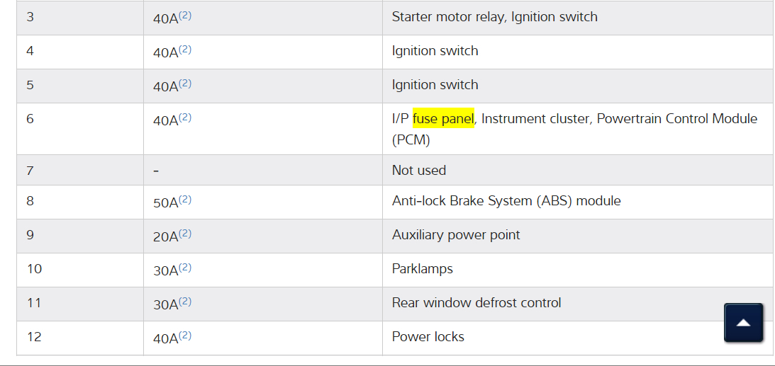

Usually not, but it does sound like you are not getting fuel to the rail. Okay, so let's check the fuel pump fuse first. It is located in the Battery Junction Box and is Fuse 14(20A). I have included in the diagrams down below a diagram of the fuel system components for your vehicle and a diagram with the location, layout, and callout of the Battery Junction Box. Please check the fuse and get back to us with what you find out. We can go from there.
Thanks,
Alex
2CarPros

Sorry been working. Fuse is good. Ineriet switch down and good at wits end.

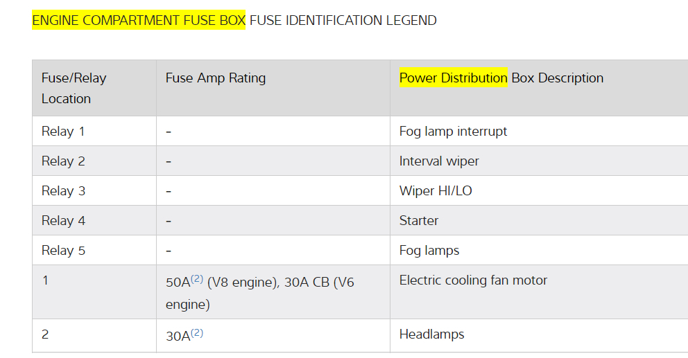

CESAR VILLARREAL

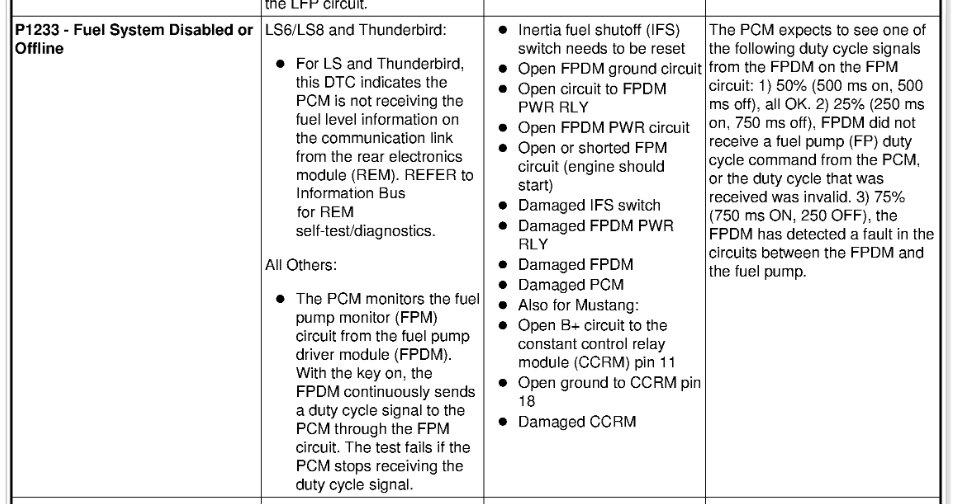

I'm having the same problem at the moment it turned off on me while driving I would press the gas and the car would kick and sputter then I came to a stop and it shut off on me, and it was throwing code p1233.
I replaced the fuel pump, fuel filter, fuel module, and coil pack.
Any ideas?
Tuesday, June 6th, 2023 AT 2:06 PM
  • 110,055 POSTS
Is your vehicle a 2004 Mustang, 3.9L V6? Let me know.
If it is, I attached the description below specific to the code you have. Please confirm the vehicle is the same. If it is different than the original one in this post, I need you to start a new thread. We try to keep them specific to one type of vehicle and problem, so it is more helpful to others. I hope you understand.
If it is different, just copy and paste your question to a new thread.
Here is a link to start a new thread:
joe
See pic below.
Thursday, June 8th, 2023 AT 9:04 PM
