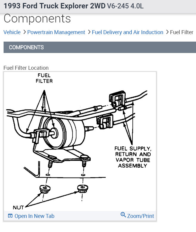

Where is the fuel filter located on this vechile.

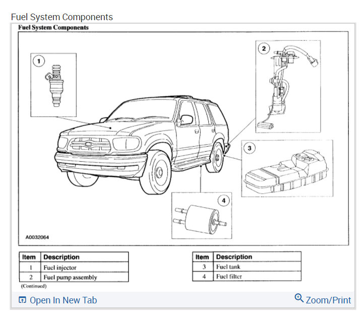

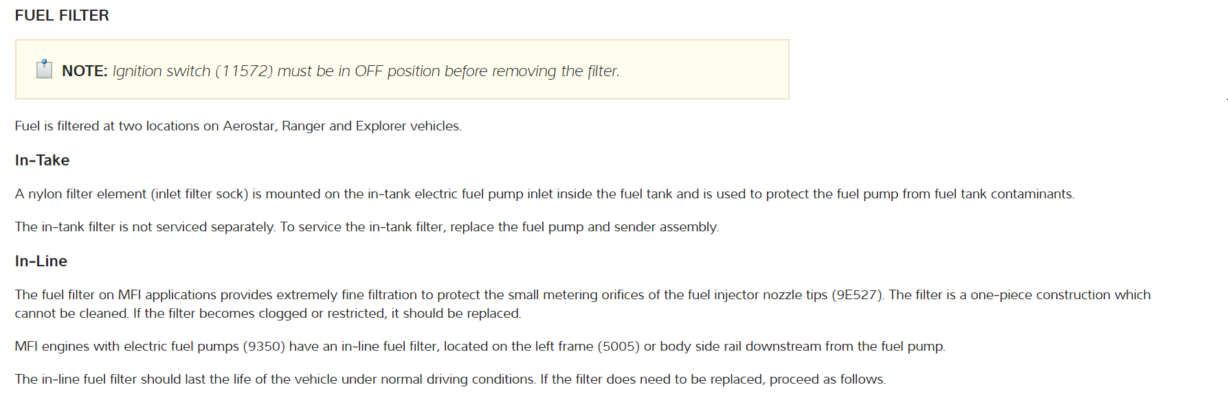

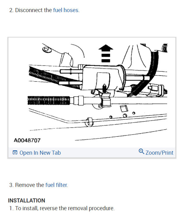

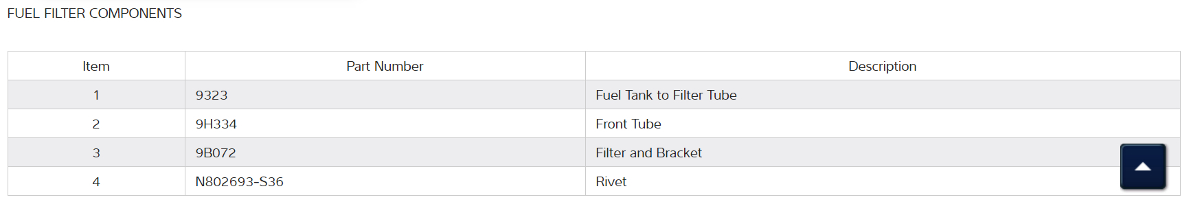

Hi Melonie Hicks, my name is Alex and I will be helping you. Here is the information you requested. It's near the tank under the vehicle along fame rail. This video will help you remove the filter with instructions below to show you how to replace the fuel filter in your car.
https://youtu.be/Boi0DPXVHbM
and
https://www.2carpros.com/articles/how-to-change-a-fuel-filter
Check out the diagrams (Below). Please let us know if you need anything else to get the problem fixed. Hope this helps.

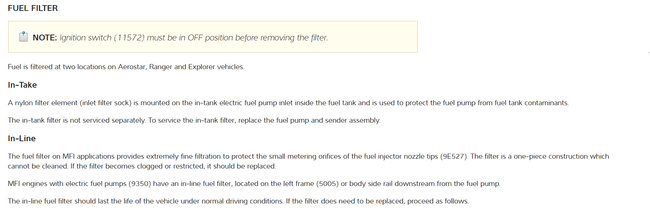

Where is the fuel filter on a ford exploer 1995 xlt?
Wednesday, October 7th, 2020 AT 1:33 PM (Merged)
WRENCHTECH
  • 20,761 POSTS
It's mounted inside the frame rail on the left side, just behind the driver.

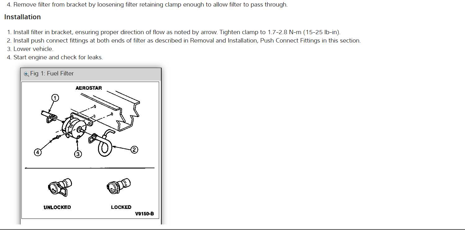

  • 75,992 POSTS

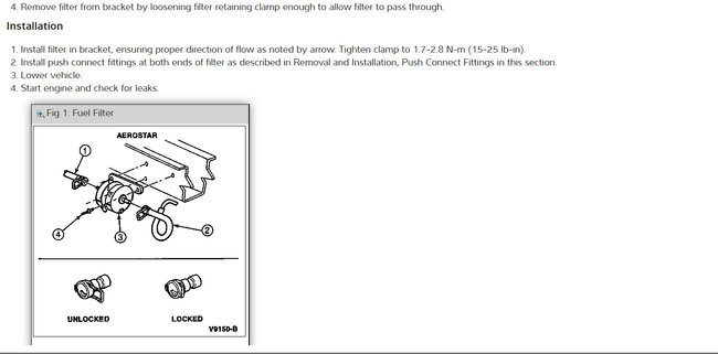

FUEL FILTER LOCATION
https://www.2carpros.com/forum/automotive_pictures/12900_fuelfilter_2.gif

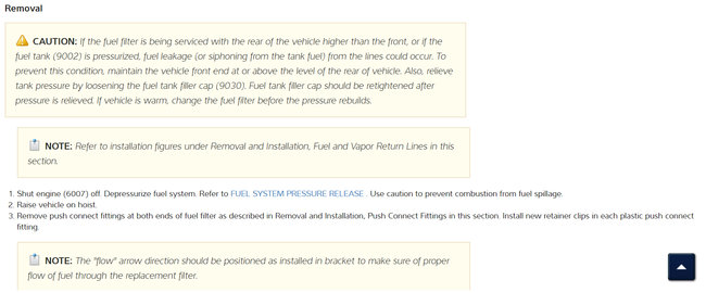

REMOVAL
CAUTION: If the fuel filter is being serviced with the rear of the truck higher than the front, or if the tank is pressurized, fuel leakage or siphoning from the tank fuel lines could occur. To prevent this condition, maintain the vehicle front end at or above the level of the rear of vehicle. Also, relieve tank pressure by loosening the fuel fill cap. Cap should be retightened after pressure is relieved. If vehicle is warm, change the fuel filter before the pressure rebuilds.
1.Shut engine Off. De-pressurize fuel system. Use caution to prevent combustion from fuel spillage.
2.Raise vehicle on hoist.
3.Remove push connect fittings at both ends of fuel filter. Install new retainer clips in each push connect fitting.
4.Remove filter from bracket by loosening filter retaining clamp enough to allow filter to pass through.
INSTALLATION
1.Install filter in bracket, ensuring proper direction of flow as noted by arrow. Tighten clamp to 1.7-2.8 Nm (15-25 lb in) . NOTE: The "flow" arrow direction should be positioned as installed in bracket to ensure proper flow of fuel through the replacement filter.
2.Install push connect fittings at both ends of filter.
3.Lower vehicle.
4.Start engine and check for leaks.
+1

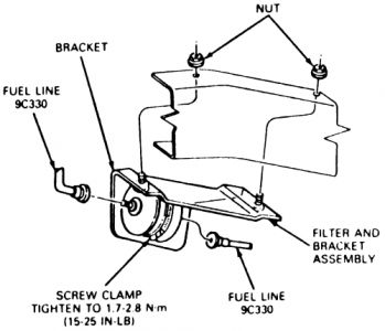

MADPOOH42
  • 1994 FORD EXPLORER
1994 Ford Explorer 6 cyl Four Wheel Drive Automatic
were do I find fuel filter on truck
Wednesday, October 7th, 2020 AT 1:34 PM (Merged)
BLUELIGHTNIN6
  • 16,542 POSTS
The fuel filter is mounted to the drivers side frame rail by a bracket, pictured below..
https://www.2carpros.com/forum/automotive_pictures/261618_1_16.jpg
+2

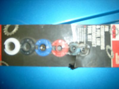

JFALLS6880
  • 5 POSTS
You need to buy a air conditioning and feul lline disconnect tool set. It cost like $10 at the parts store. It comes with 6 plastic rings (different sizes for different size fuellines) . You place one of the rings
https://www.2carpros.com/forum/automotive_pictures/130938_S3500081_1.jpg
around the fuel line and then push it towards the fuel filter and then pull the fuel line out. Make sure the fuel line is depressuirzed your you'll get waht ever fuel is in the line right in the face. I know from experience.

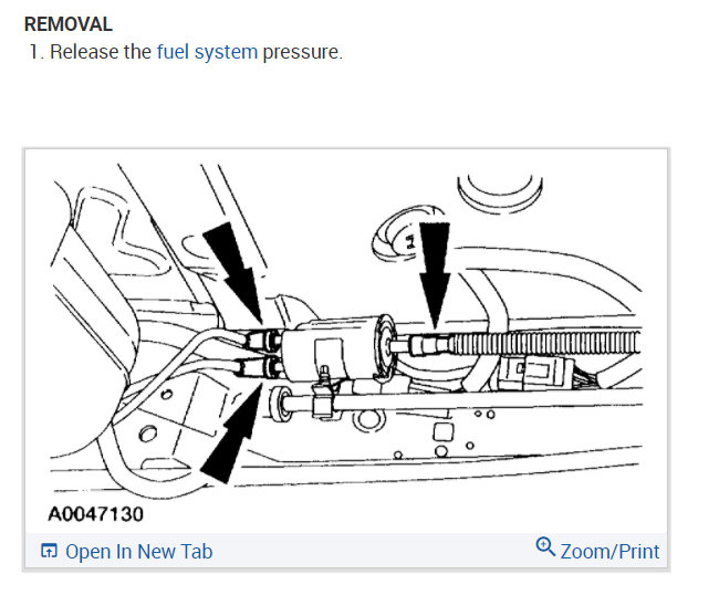

I need to change my fuel filter where is the location?
Wednesday, October 7th, 2020 AT 1:36 PM (Merged)
FIXITMR
  • 9,990 POSTS
The fuel filter is under drivers seat on frame rail here is a video to help you remove the lines and a diagrams below to show you the location.
