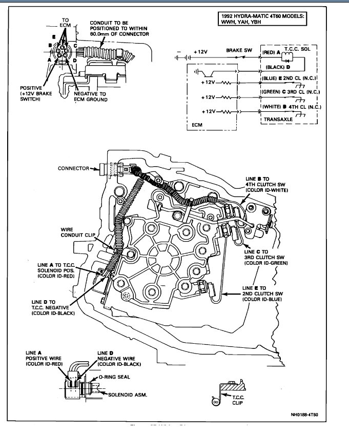

Transmission will not shift?
1992 CHEVROLET LUMINA
170,000 MILES • 3.1L • V6 • 2WD • AUTOMATIC
JAYCMORRIS
I can't find the transmission control module?

First make sure the fluid is full. If so, I have seen the pressure control valve cause the transmission not to shift. We should run the codes first though; you can get a CAN scanner (Controller Area Network) from Amazon for about $36.00.
https://youtu.be/u-4syLc-ifQ
Here is a scanner link:
https://amzn.to/3eCqWWw
This scanner does the entire car, which is easy, just in case I have included the replacement instructions on how to replace the pressure control solenoid. Check out the images (below). Please let us know what happens.
