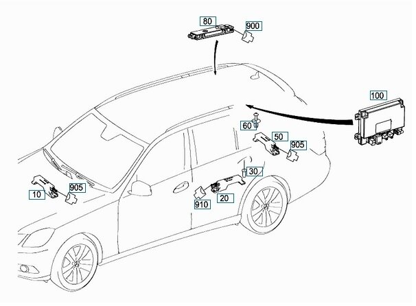

Hi folks. I am looking for Keyless Go antenna's location for W212 Wagon. I know about rear doors where they are. Cannot find where antenna is in front of the car (somewhere under center console) and also rear antenna (somewhere behind rear bench backrest (antennas no 10 and 50 on attached picture). There are 4 antennas and 1 amplifier on the roof frame right side in trunk. or I missed some additional antenna?

Hi Ken. The antenna on the roof is not related to KeylessGo. Okay, no matters. Please try to help me with picture location of rear KG antenna (behind rear bench backrest) and front antenna (somewhere under main or middle console). Thanks

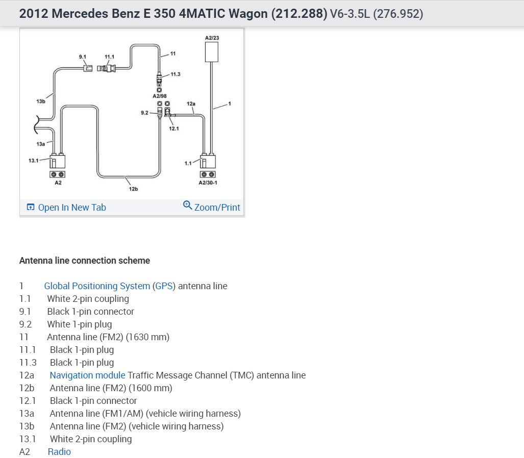

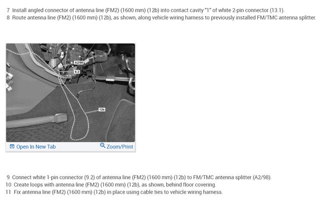

Here is what they show for the antenna locations and routings. Check out the images (below). Please let us know if you need anything else to get the problem fixed.
May 13, 2023 at 2:54 AM
DOBRZAN
  • 15 POSTS
Ken, i'm not writing about radio (comand) antenna... i need schemes, pictures for Keyless Go system.
