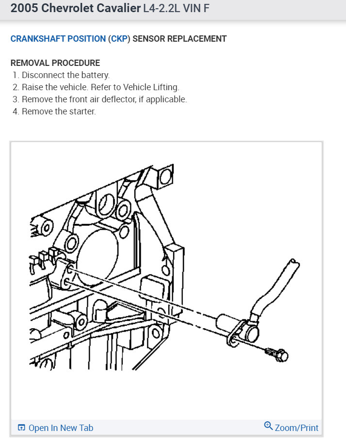

vzCalais won't start.lost key so got new key and recoded car started twice then won't start .mechanic came out with diagnostic recoded no start..
Sep 28, 2019 at 2:22 AM
  • 55,399 POSTS

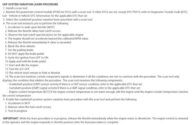

It is common when the engine loses spark the crankshaft position sensor is out. here is a guide to walk you through the steps and diagrams and instruction below to help you with your car:
