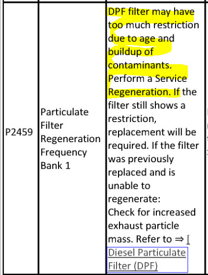

Check engine light is on - vehicle seems to be running fine
#7E8: Engine P2459 - Particulate Filter Regeneration Frequency Bank 1
Aug 25, 2024 at 5:01 PM
  • 110,193 POSTS

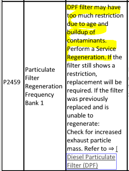

The code you have is specific to a diesel engine's particulate filter. This code usually indicated the need for regeneration or replacement of a dirty filter.
Take a look at the pic below and let me know your thoughts or questions.
See pic below.
