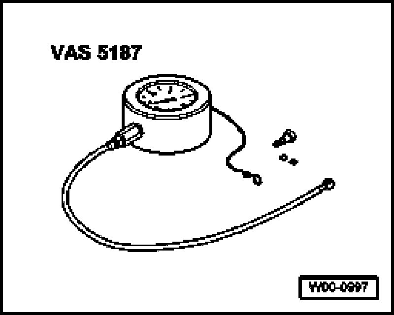

picture 1
- Pressure gauge VAS 5187

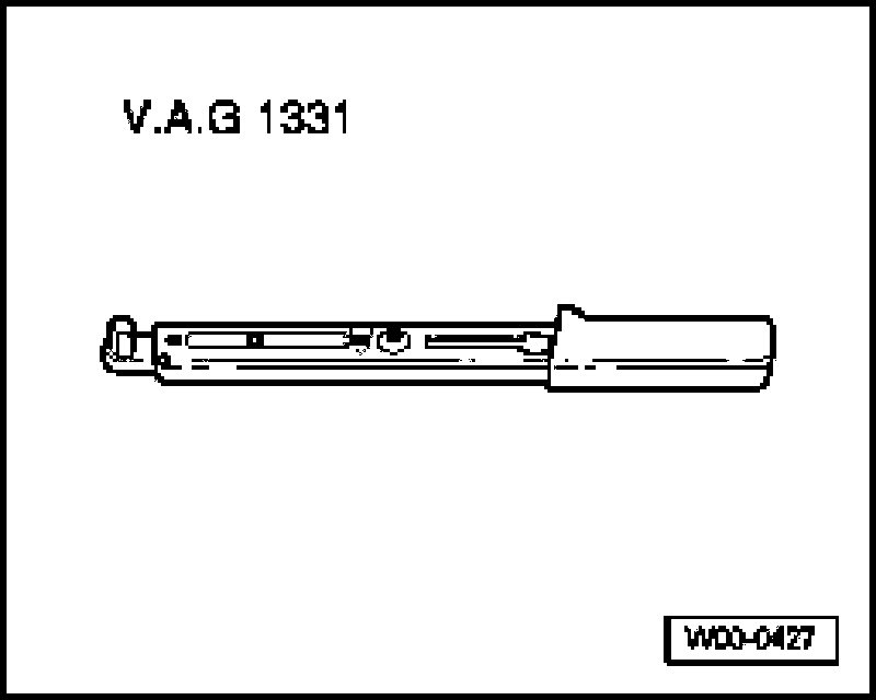

picture 2
- Torque wrench (5 to 50 Nm) V.A.G 1331

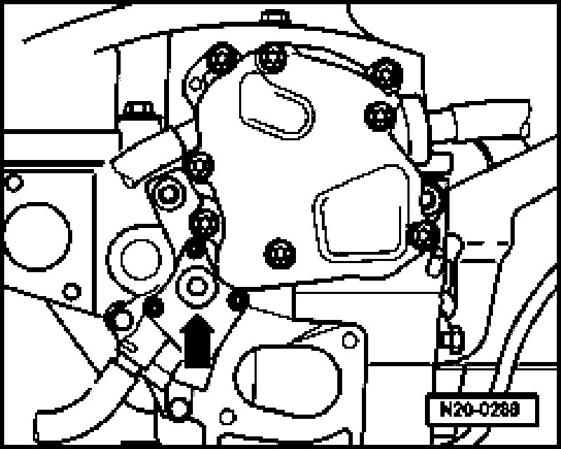

picture 3
- Remove locking bolt - arrow -.

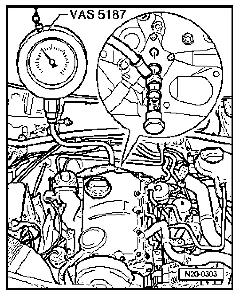

picture 4
- Install pressure gauge VAS 5187 as shown.
- Secure charge air tube in place again.
