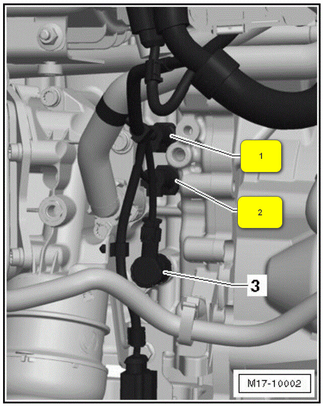

Hi, I’m wondering what each of the three sensors located next to the oil filter housing do. I wanted to replace them, but I didn’t know exactly which ones do what.
Mar 18, 2025 at 12:26 PM
BORIS K
  • 836 POSTS
The engine has 2 oil pressure sensors.
Behind the alternator, below the intake, at the rear of the engine.
See picture below.
Number 1 is the oil pressure switch and number 2 is the reduced oil pressure switch. Number 1 will be blue, and number 2 is brown.
Hope this helps.
Cheers, Boris

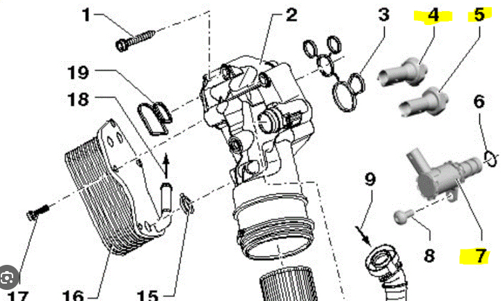

MK6 EDGAR
Thank you Boris, that was really helpful but would you happen to know what the third connection in that diagram is? Because I also have to replace it.
Mar 20, 2025 at 8:18 AM

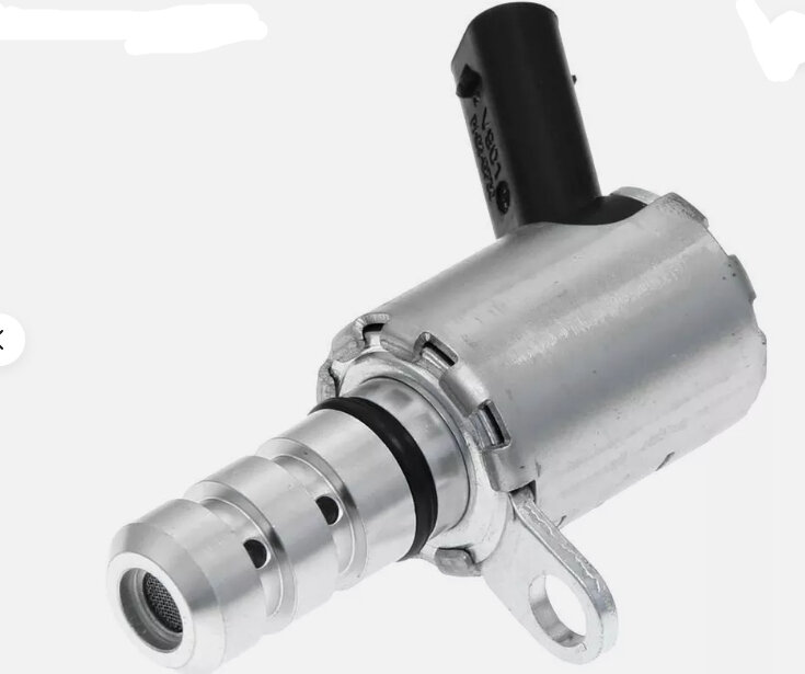

BORIS K
  • 836 POSTS
The third connection is the oil pressure control solenoid, item 7 in image below.
Cheers, Boris
