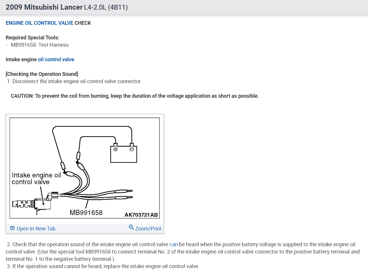

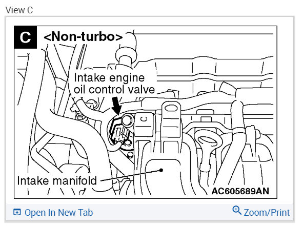

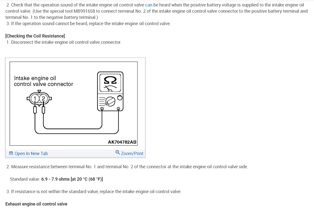

When i turn the key to the on position the front VVT sounds really loud
2009 MITSUBISHI LANCER
144,955 MILES • 2.0L • 4 CYL • 2WD • MANUAL
MONCHO6685
  • 118 POSTS
Hello. I have the car listed above with a 2.0l mivec.
When i turn the key to the on position the front VVT sounds hard (very loud). That's normal? It's sound a loud tack!tack!tack!tack!tack!
Only the front one the back one doesn't make a noise.
Thanks.
Att.
Juan marin
Apr 26, 2020 at 6:32 AM
  • 55,433 POSTS

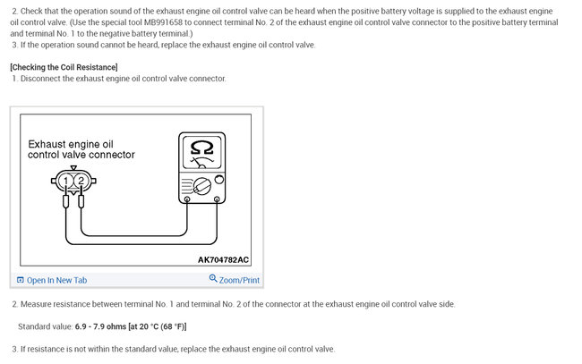

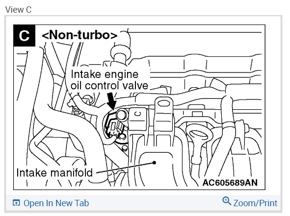

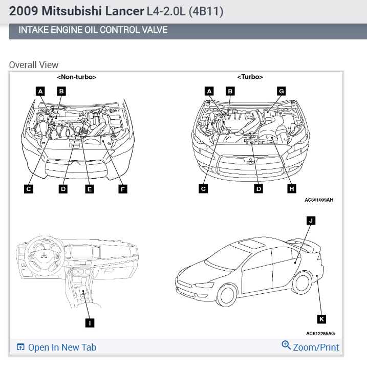

That does not sound normal. Can you please shoot a quick video with your phone so we can hear the noise? that would be great. You can upload it here with your response. Also check the oil level and change it if needs it. Here is how you can replace the VVT in the diagrams below. It also shows how to test the unit. Check out the diagrams (below). Please let us know what you find. We are interested to see what it is.
