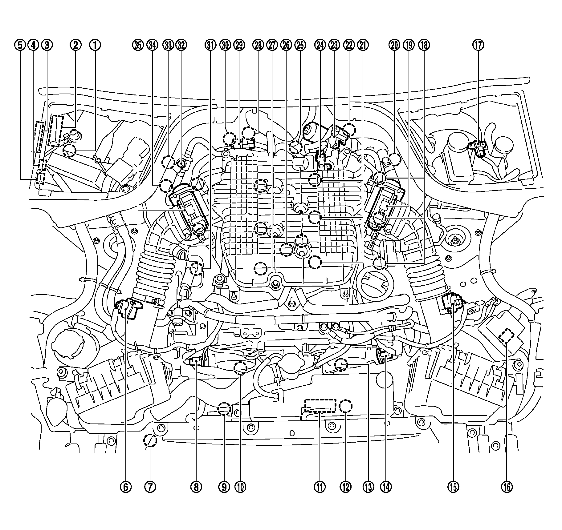

Where are the solenoids located?
Do you have a diaphragm to f where all of them located?

your car could have been made in Mexico USA and Canada, which one do you have? it only list the q60 .2 wheel and all wheel .no x. Can you look on the VIN it should tell you there. then we can post a diagram for you.
Aug 25, 2025 at 10:14 AM
MECHTRIX
  • 415 POSTS

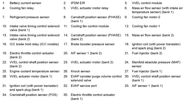

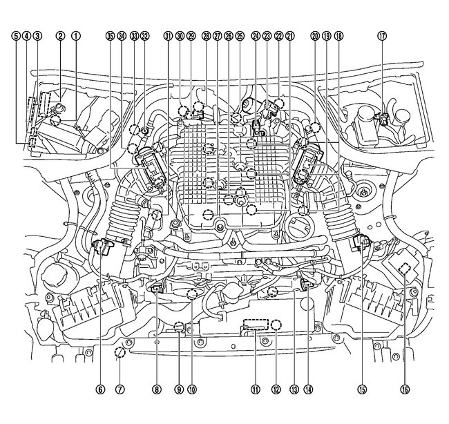

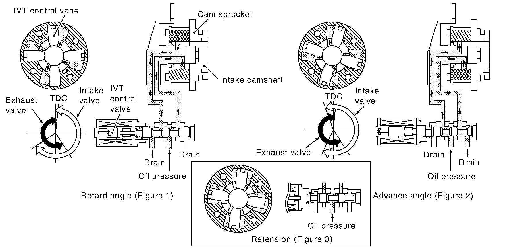

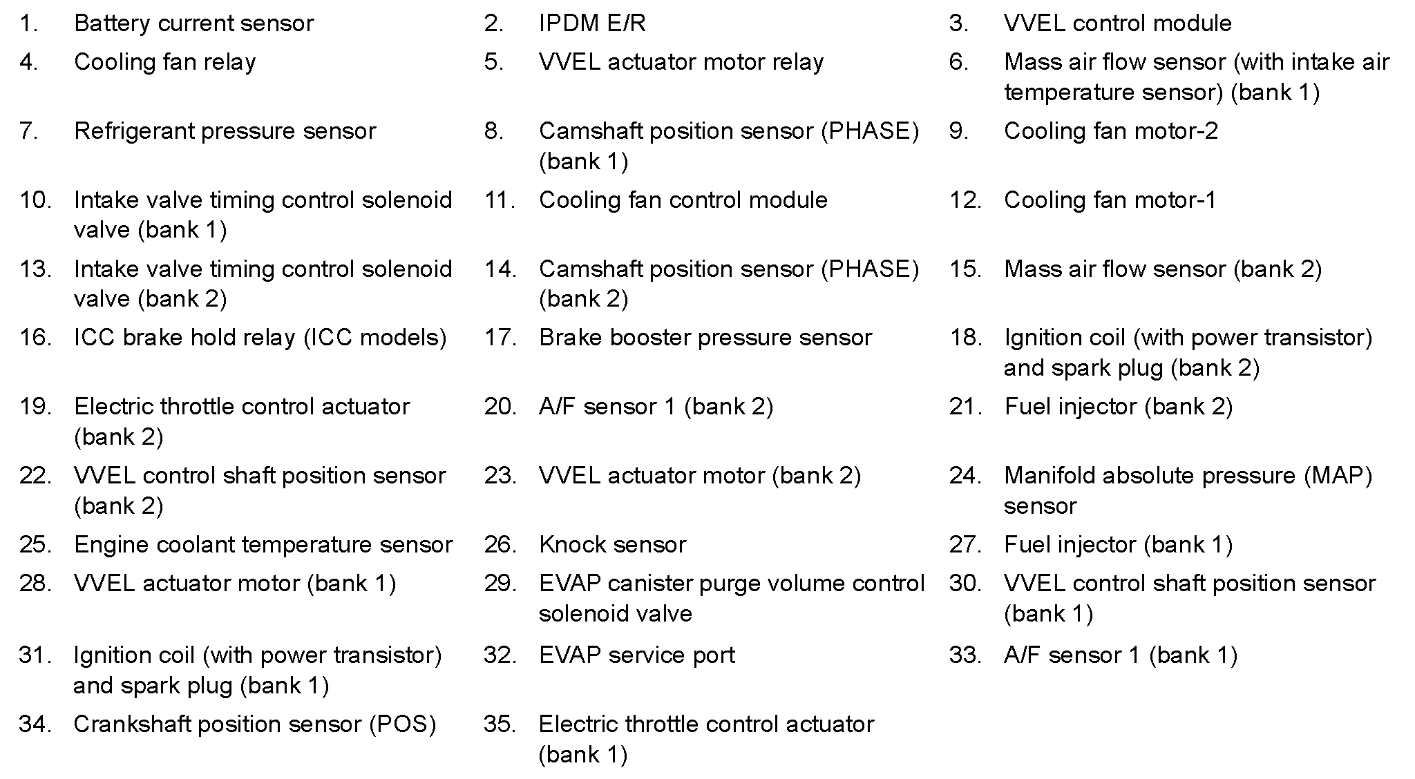

Oh did you mean you wanted the diagram for the control valves? they're also included in this illustration too its a diagram for the Canada USA model so you can see what they look like .Just click down below.
Aug 25, 2025 at 10:20 AM
MECHTRIX
  • 415 POSTS
it says there's 2 solenoids.
Estimated labor time 30 minutes for both.. here are two diagrams for you one is numbered and the other is the parts list for that number it will show your valve control components numbers 10 and 13 i believe ..please click the diagrams down below.
