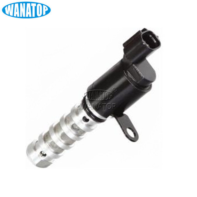

SERGE BéDARD
I don't think it is what i looking for. I look for the part i have joined but i don't know where this item is located in Hyundai Sonata 2015. Sorry for my English.

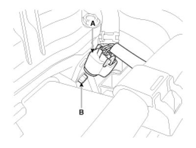

That is a camshaft position sensor. Here is a link that shows how one is replaced in general:
https://www.2carpros.com/articles/camshaft-angle-sensor-replacement
Here are the directions specific to your vehicle for replacement:
REMOVAL AND REPLACEMENT
SONATA(LFA) 2015 G 2.4 GDI Engine Control / Fuel System
Inspection
1. Check the signal waveform of the CMPS and CKPS using the GDS.
Specification:
Refer to "Wave Form" See: Camshaft Position Sensor > Oscilloscope Patterns and Waveforms
Removal
WARNING:
DON'T remove the camshaft position sensor while the engine is running or right after engine is turned off. The part and engine oil is hot and can cause burns.
[Bank 1 / Intake]
1. Turn the ignition switch OFF and disconnect the battery negative (-) cable.
2. Disconnect the camshaft position sensor connector (A).
3. Remove the installation bolt (B), and then remove the sensor.
picture 1
